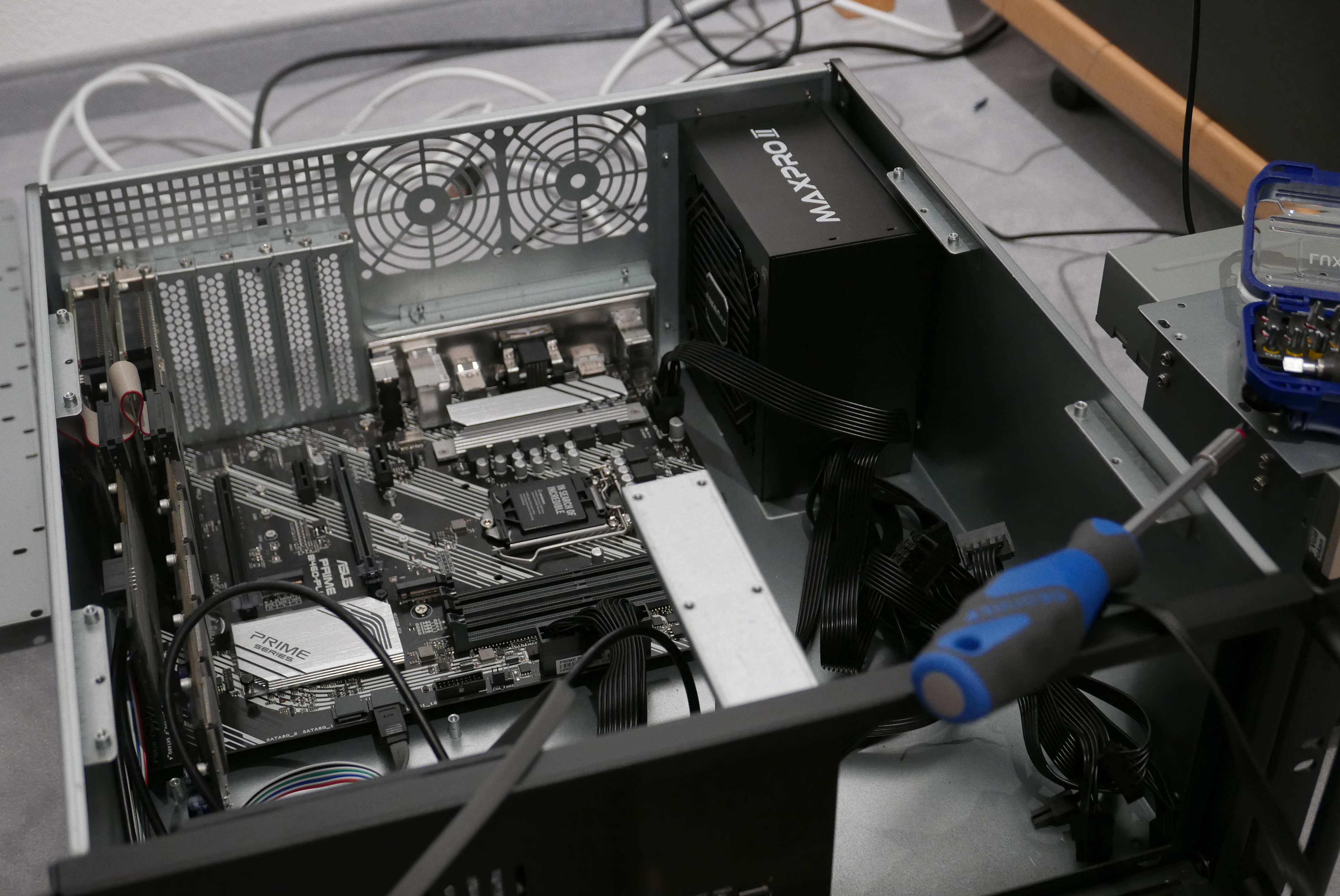

The case is one of the cheapest rack case but it seems fine for my tasks
First Problem i have is the harddisc Housing is in the way of the Score pro Board.
Right now no big Deal, i ordered 1TB M.2 hd space
But i will have to use a flex to fix things and to have options for further HD space

Possibly not necessary.
Use the 5.25" bay for HDD w/ 3.5">5.25" adapter brackets !
1 optical and 2 HDD´s are possible.
I don´use the SCOPE PCI cards in that case, but I use the 5.25" bay for a single SATA-600 WD Velocity Raptor 300GB,- just only for audio recording.
2 M.2 in addition.
The 3.5" bay is somewhat in the way of propper airflow anyway,- especially when using the big DSP cards.
I use the bay for 2 SATA 3.5" SSDs, but it´s all for XITE-1, so no multi-DSP-chip heating inside the case.

today i received the rest of the compoenents
everything worked fine and system is now running windows 10 64Bit.
Hopefully garyB will be sending me the scope v7 keys soon, so i can check the scope cards running fine.
And of course do a masterverb loader test. ;)
Sadly the big cooler was too big for the case. ;P

hifiboom wrote: Tue Jul 28, 2020 3:08 pm
For that case, this works excellent ...
https://www.mindfactory.de/product_info ... 76000.html
It fits under the "bridge" while still getting enough fresh air from "above" !
I have excellent temperatures.
Just only replace stock heat conductive paste by Arctic Silver.
For case fans I used "NB" noise blocker ...
IIRC, front fan was some e-loop and rear the best I was able to find from NB.
It´s all about the balance "what comes in" on front and "goes out" on rear.
For best airflow, both should match sowmewhat.
