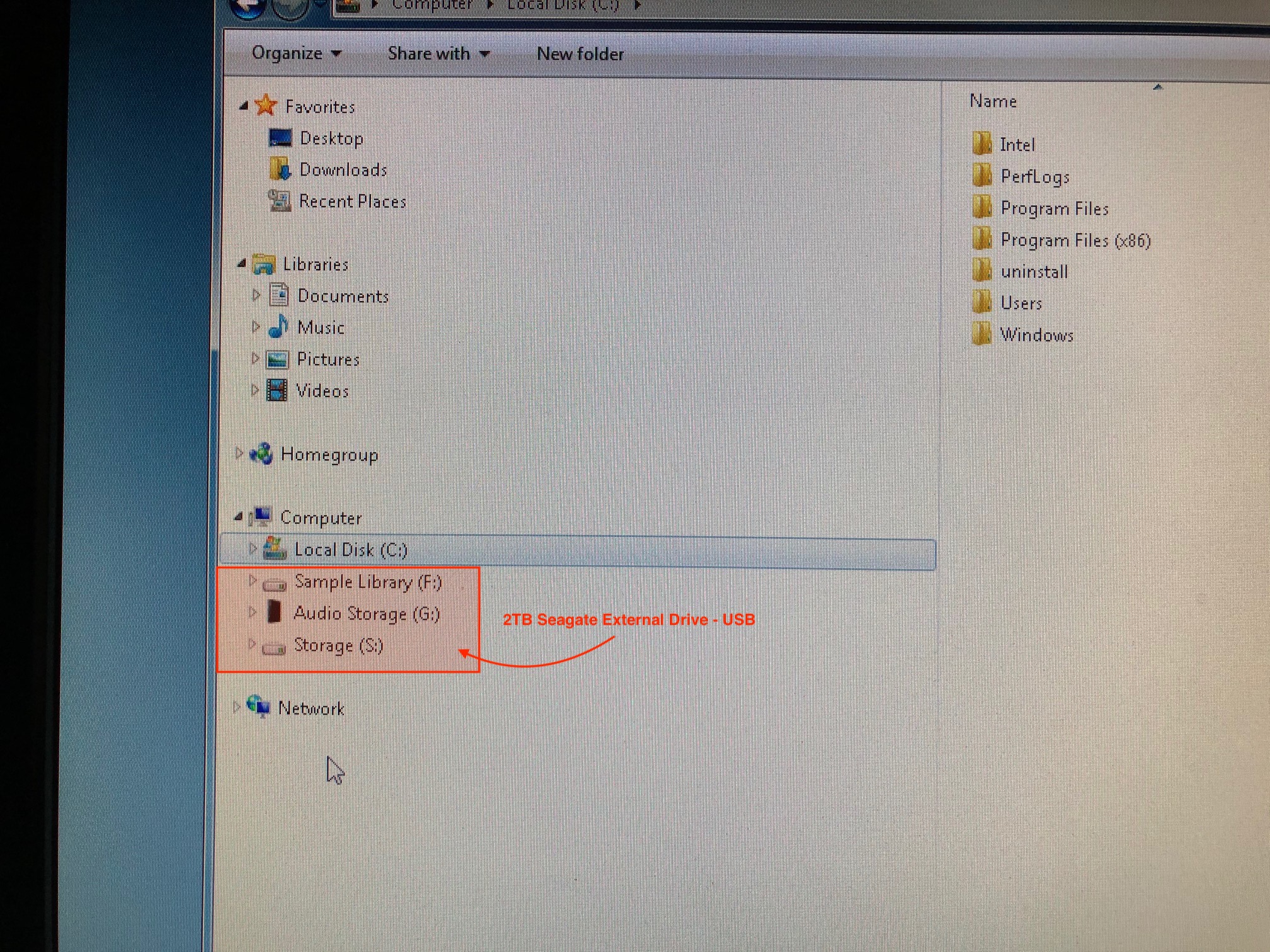

Audio & Samples data storage:
Seagate 1TB External USB drive

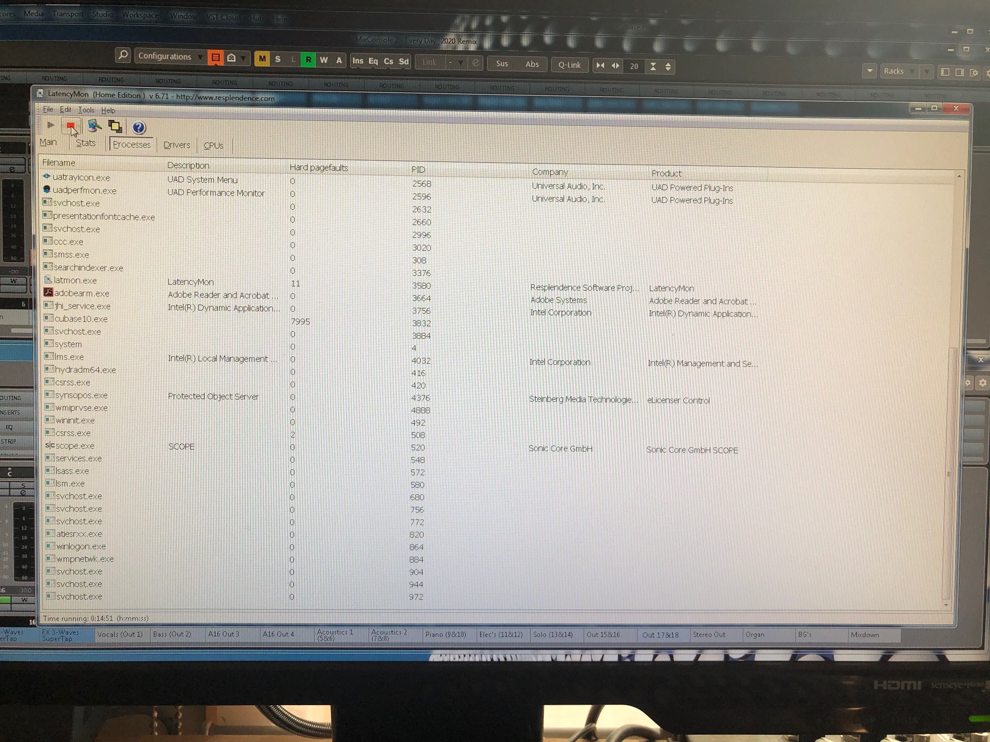

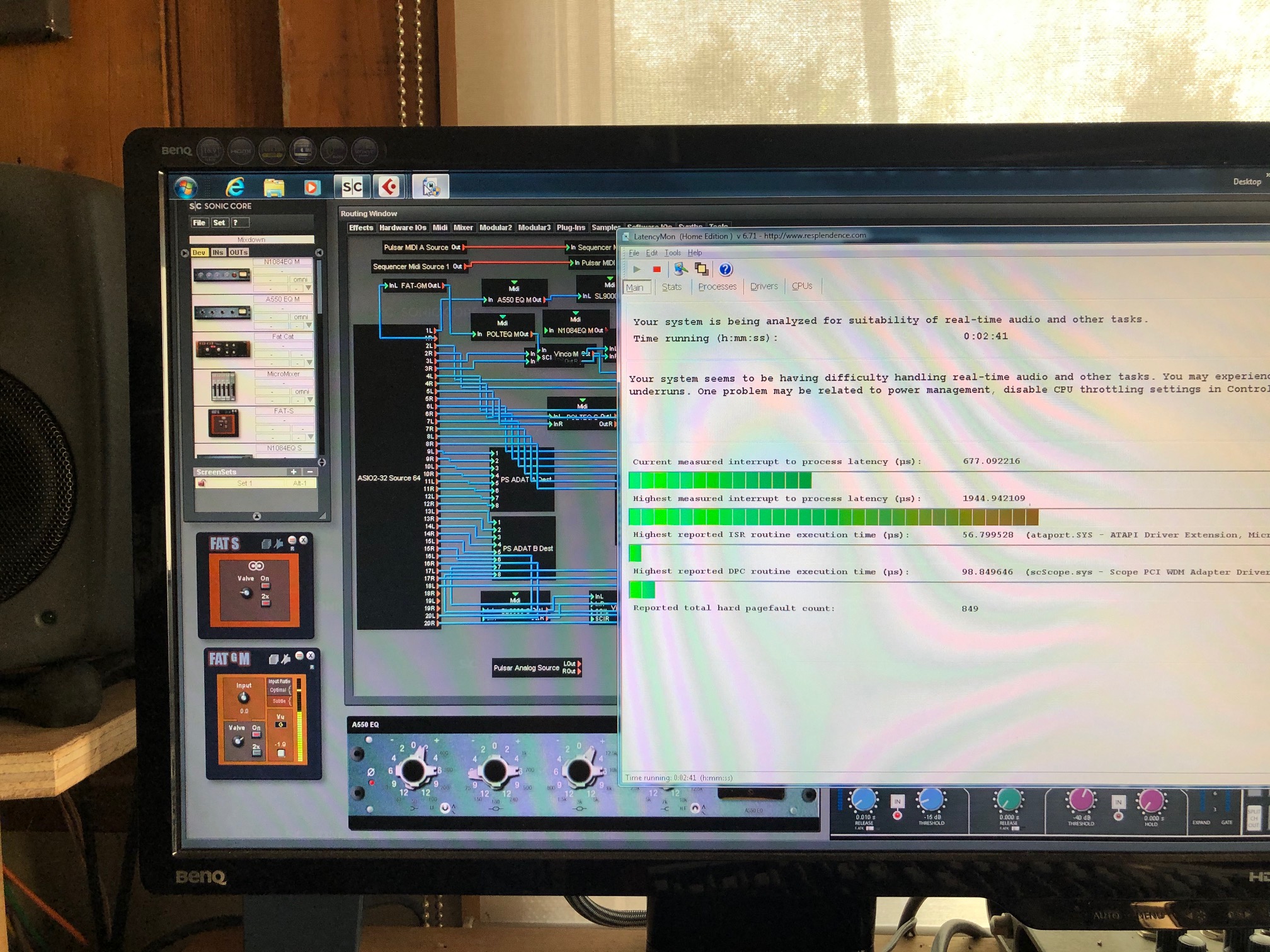

In Cubase, running a typical session with no VSTi's, on playback with audio only, max 20 tracks so nothing heavy, but with various plugins inserted across outputs & tracks, ALWAYS gets intermittent crackles & pops. I'm suspecting some of it has been recorded at times. Unusable system, can't mix anything down. Have tried Audio Guard both on & off in Cubase, no difference either way but Audio Performance suggests that the computer is barely pushing or working hard

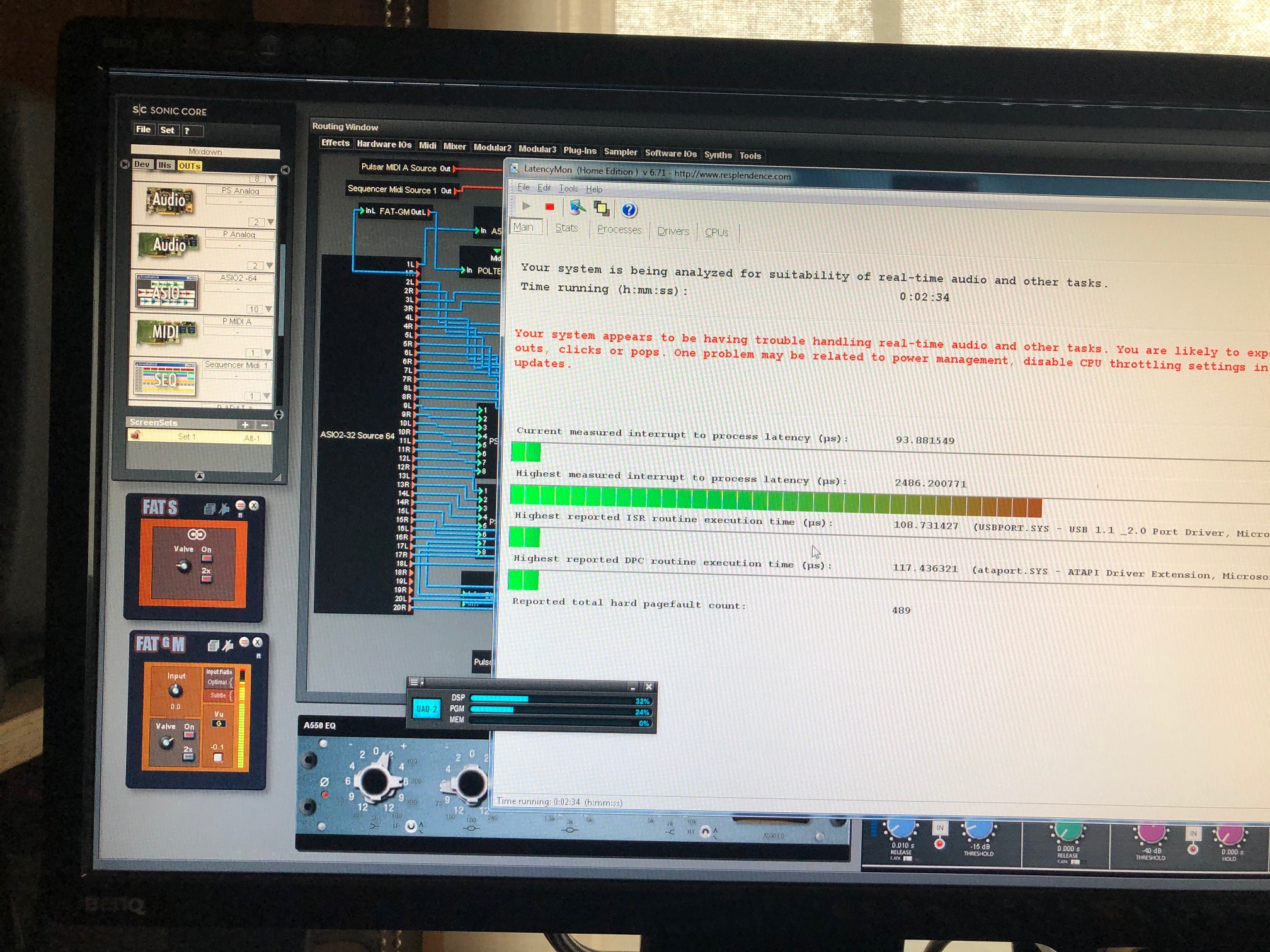

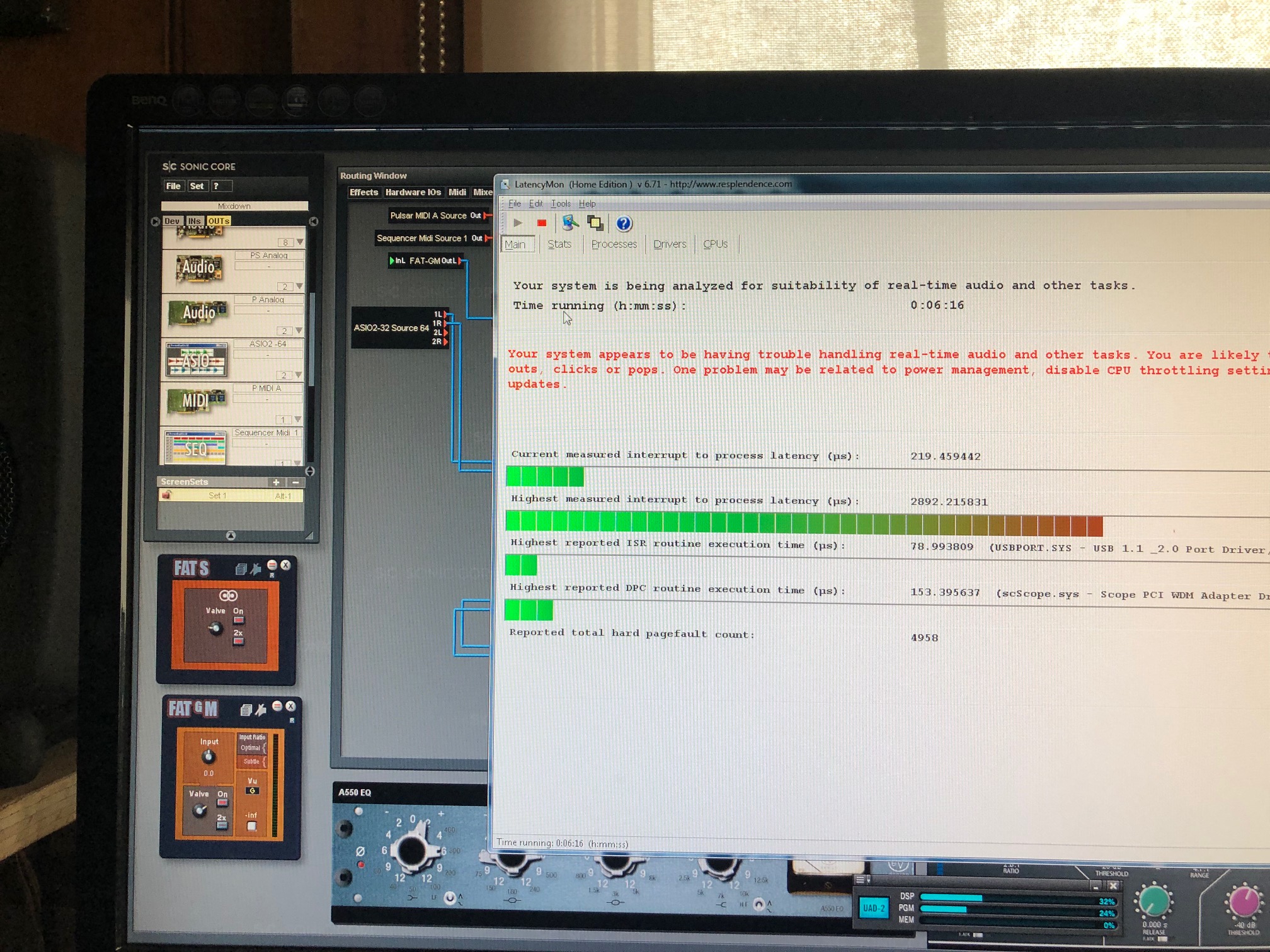

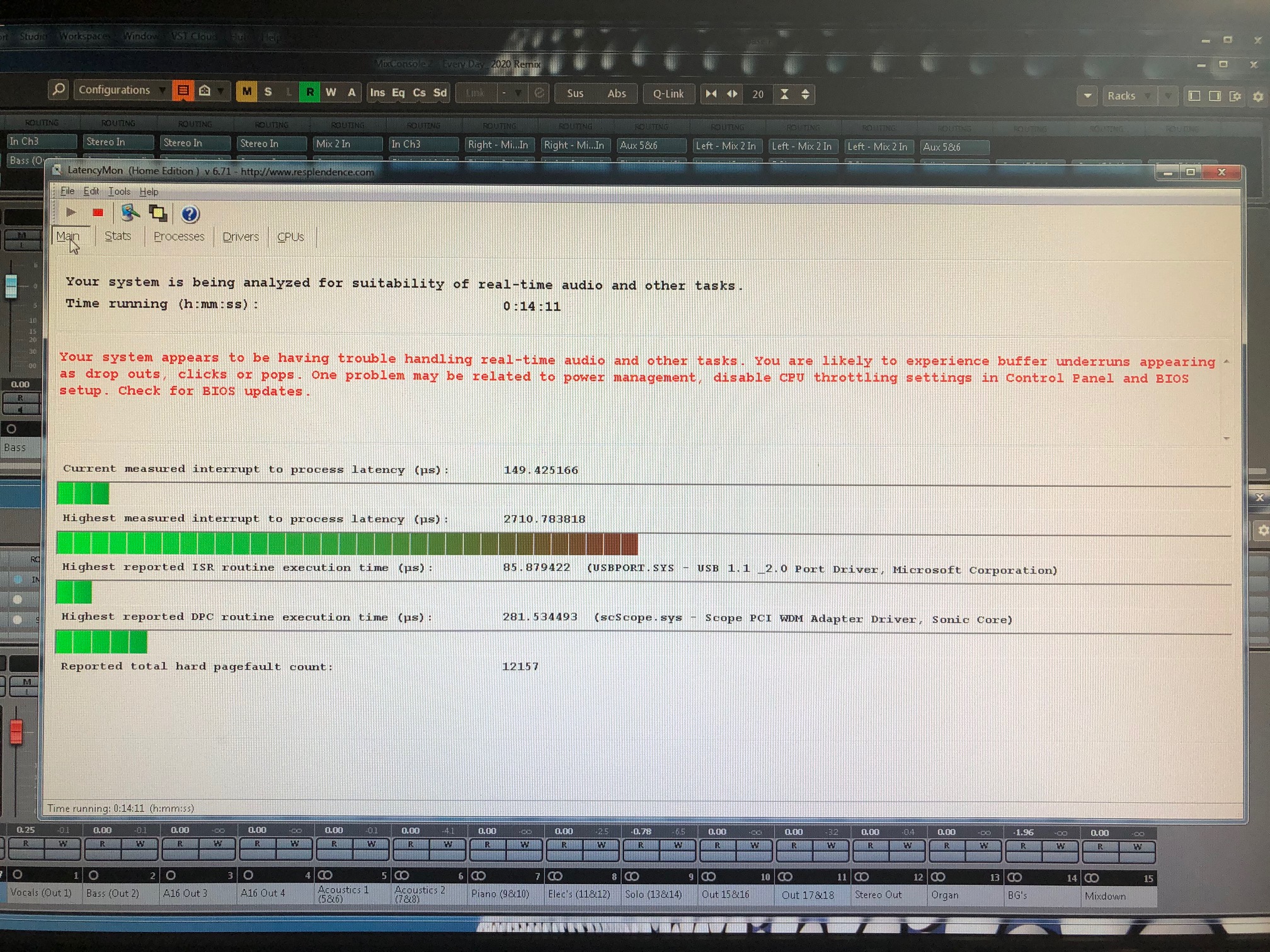

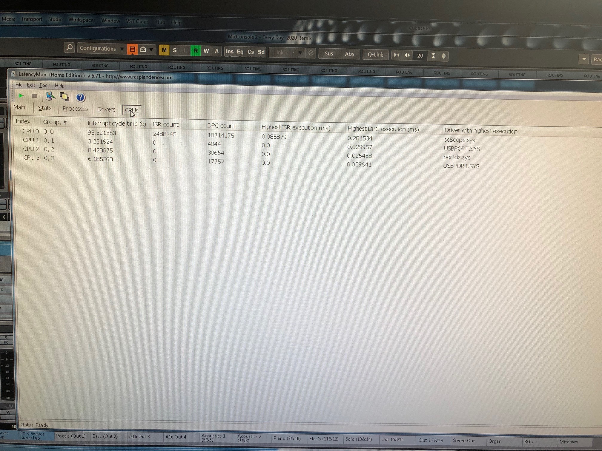

Latencymon tests OK with just Scope running, but no DAW/Cubase working. The issues start when I hit playback.

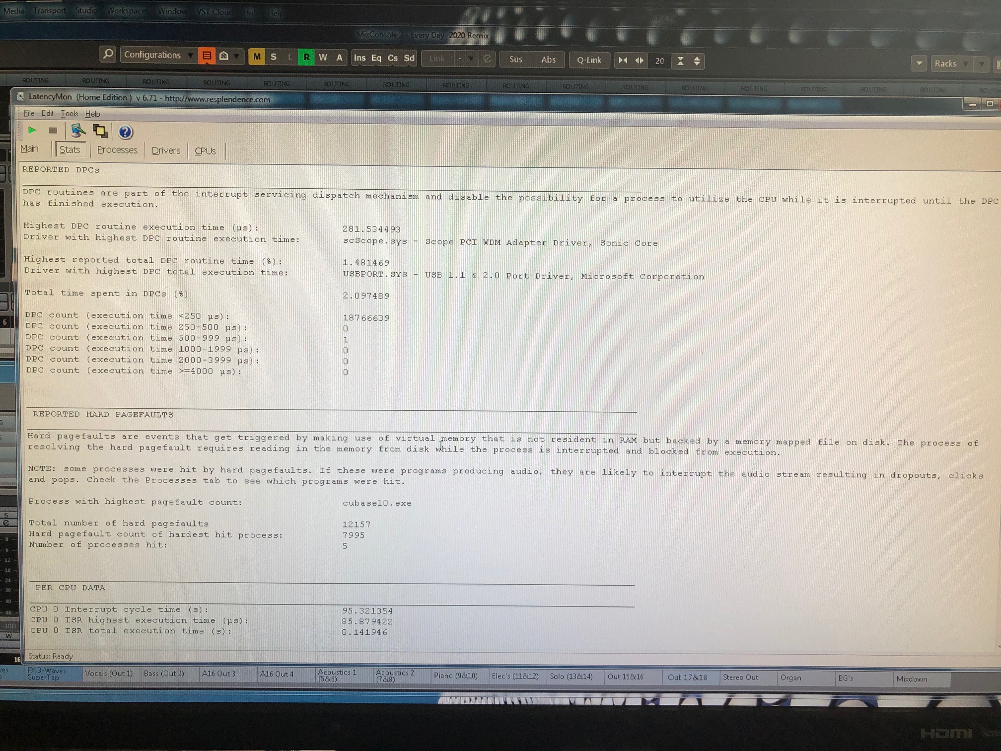

LatencyMon seems to be pointing to USB, Scope & Cubase for various issue:

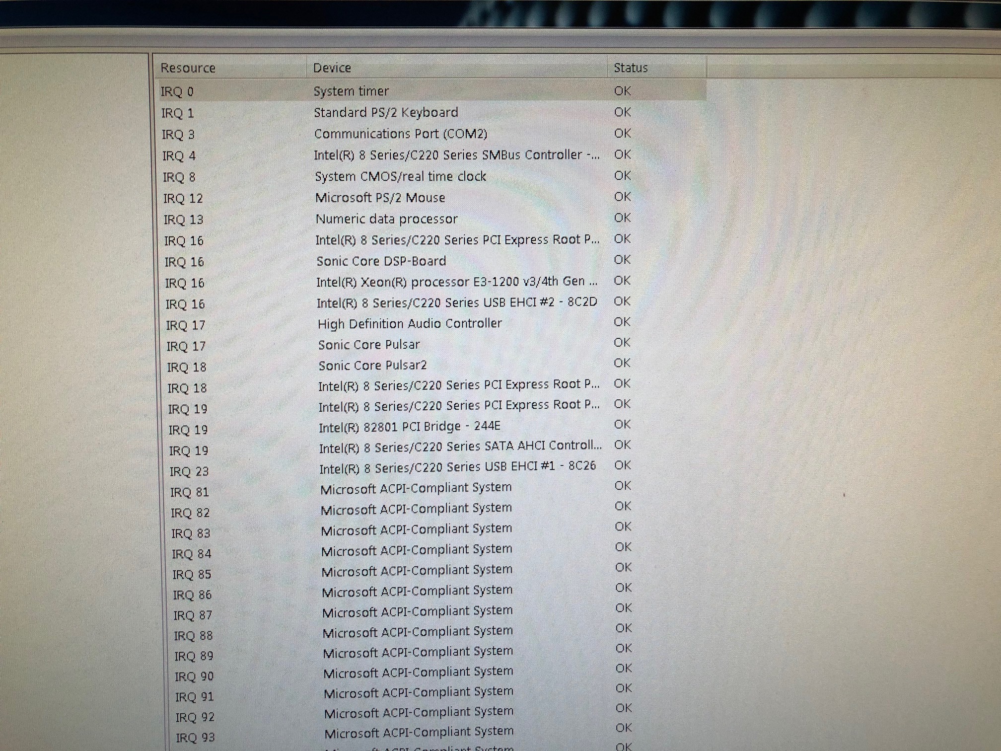

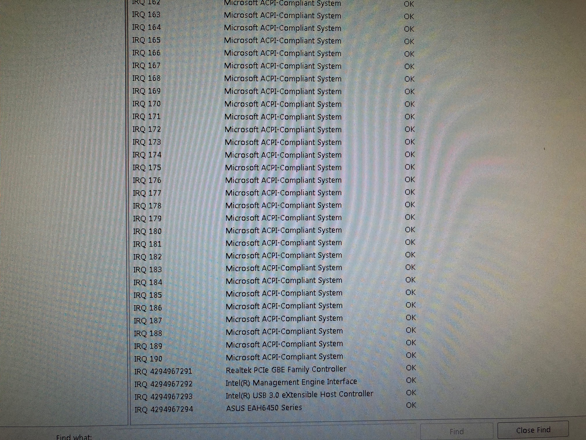

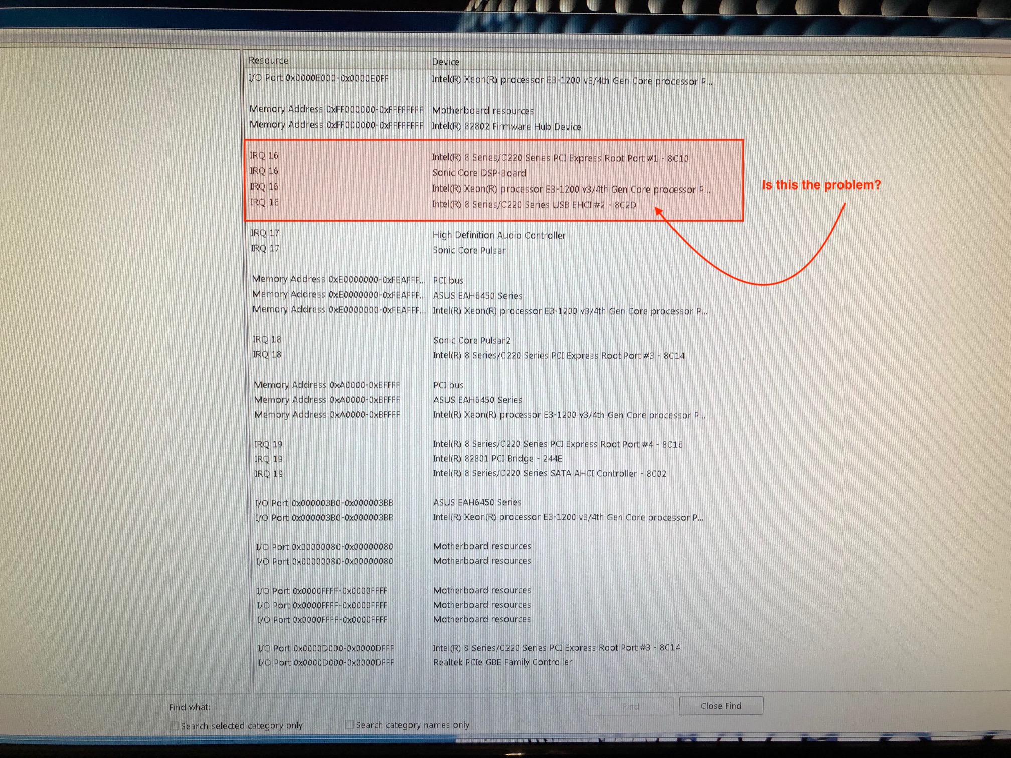

Here's the IRQ situation, and from my understand I can't adjust this (easily, like in the (g)olden XP days) anyway even if I wanted to:
I tested disabling the Scope audio driver out of Cubase, but kept the midi, the Latencymon dropped right back into the green, so I figure it's the Scope ASIO factor specifically that's an issue.
The conclusion I've drawn is that unfortunately the 3 main things (Software/DAW, Scope PCI Hardware & USB requirements with my set-up of multi-outputs are either (a) a poor combination here or (b) one or two need to be addressed or swapped out with an alternative to get it working. Logically I'm thinking I'm flogging old technology in a modern system that's not built specifically for it (ie PCI bus bandwidth maximising)

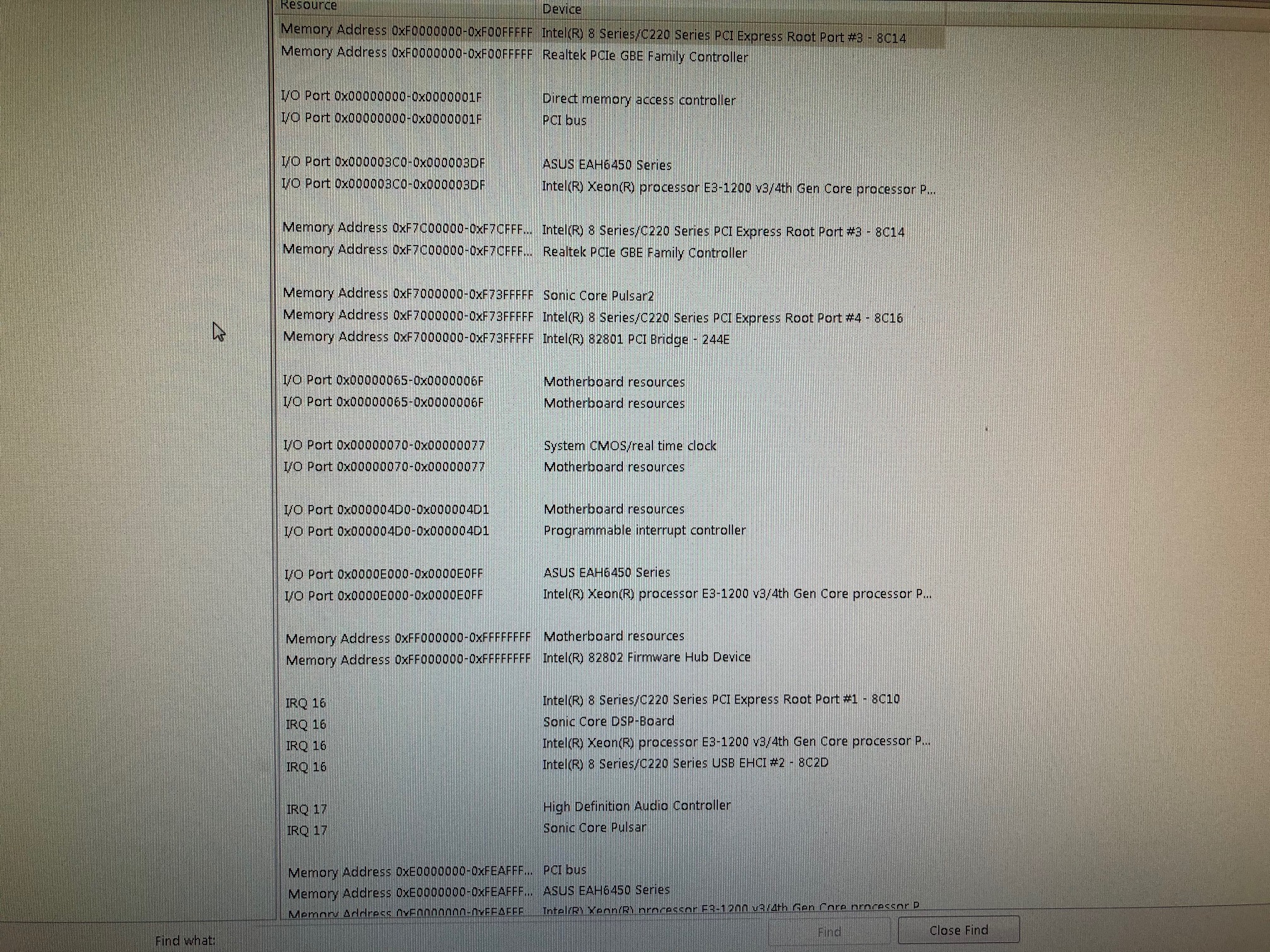

that is not the place to check IRQ settings. you want system information\hardware resources\conflicts/sharing.
I've attached IRQ sharing from System Info
IRQ 16 - is that an issue?
what is the USB problem?
It seems that's what Latency mon was pointing to - have I misinterpreted the test results?

Absolutely recommend use of a secondary internal drive to record to rather than the usb drive
Use the usb drive as backup and only after recording
Also disable that USB driver while recording and only enable it when you need access to the USB drive.
Do that by right clicking on it from Windows device manager and disable it.

yes, disable usb controller 8C2D in the device manager. you will lose a usb port or two but there are plenty of others. you can also use a hub.
usb is not suited to real-time record streaming. use another sata drive. use the usb drive for storage. if you wanna go old school, that's great, but simplfy when recording parts. use stereo out for monitoring. when mixing use a lot of individual outs and then you can use all the outboard you like. or something. you don't want to make the recording operation any more difficulty than it needs to be, in real studios, they have different rooms with different setups and gear for recording and mixing.

As you have been discussing, this is the source of clicks & pops. ANY device that does not release its interrupt request fast enough is a problem for audio as well as any other realtime task (an interrupt request is what a CPU receives when it has to handle any operation to a device on the system that is not located in the CPU itself or system ram). One way the CPU can 'defer' handling an interrupt request is something called a Deferred Procedure Call (DPC) and so one thing you'll see discussed when dealing with audio performance issues is looking for DPC Latency problems, which I can see from your first screenshot you've been looking at already.
In fact, in your first screenshot what I see is: USB 1.1_d.0 Port Driver is returning from its ISR routine too slowly (and the Scope driver spends a lot of kernel time handling its physical i/o as well, but this is to be expected.)
An ISR routine is an Interrupt Service Routine, or the specific block of code that handles the interrupt condition by doing the actual data transfer to & from the CPU thus 'interrupting' the active process. When the ISR is complete, the CPU returns back to the process (your DAW or Operating system's program loops). So the culprit you guys have been discussing is the USB port that is 'waiting around' for some operation to finish, and thus release the CPU resources tied up.

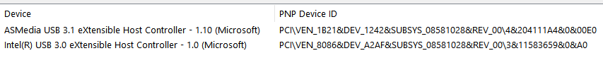

In the past we could go into device manager and choose View > Devices by Connection (or Resources by connection) but there's so many virtualized resources in a modern system that this won't give us the same level of detail it once did (in fact I rarely actually see the USB chain as it exists in these views). Similarly the Windows "System Information" application will only show you what the USB root controllers are:
Screenshot 2020-05-06 23.17.00.png (7.39 KiB) Viewed 44236 times

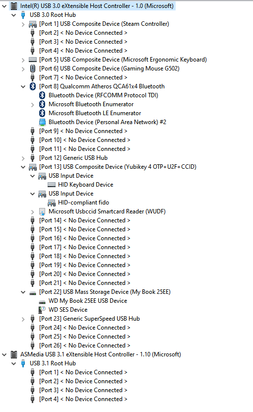

All this tells me is that I have a 3rd party chipset for my USB 3.1 ports (there are 4 physical ones exposed on the back). Now, I could show you the view from Device manager, but while it does show some of the 'Composite devices' and two additional USB Hubs connected (a 3.0 and a 3.1) to various ports, it doesn't say WHERE they are connected in terms of addressing.
I personally use AIDA64 to see my full USB chain (which shows the same thing that you see in Mac OS's System Information when viewing USB devices, interestingly enough):
Screenshot 2020-05-06 23.19.21.png (40.84 KiB) Viewed 44236 times
Now, if I look in the above screenshot (my second one) from AIDA64, I can see the same 2 USB controllers and you can actually see what's connected where in terms of how the Operating System (and thus CPU) is addressing everything. However let's look at the technical specs again:
This system (the one I'm typing on, not my Scope system btw) is an Intel Z370 Chipset. Checking Intel's ARK again (like I did above for you) I see that Intel has implemented the following:

Just to clarify, the external drive in question is a just a standard powered Seagate Expansion magnetic drive connected via USB - so I assume this is even worse in terms of timing (than a SSD........

- got a powered USB3 hub, shared USB host controller disabled
I'm coming to the conclusion that I've got an issue with ASIO performance and/or UAD plugins on mix down, or both. It could be my particular machine is not good enough, or possibly I'm pushing the limits with the Scope pci factor, may not as simple as that....but either way the system's not performing.

So a few "tests" showing Latencymon on the same Cubase mixdown session, testing various combinations of either (a) multiple or reduced/stereo ASIO output and (b) UAD2 in or out of the picture. Just to clarify, session has only around 16 channels of actual audio running here. There is 1x midi track for the drums that triggers a separate machine so NO VSTi's, we have 4 channels of mono vocals, mono bass, 3x stereo guitars, 3x mono guitars, 1x stereo keys/organ & 3x FX sends (delay/reverb) - it's not that heavy in terms of playback
1. Fully loaded, multiple ASIO out, UAD2 across various outputs - this is the scenario I'm aiming for
IMG_6218_Fully Loaded.jpg (908.76 KiB) Viewed 43988 times
Clearly a failing combination
2. Totally Ditching the UAD2 & plugins removed from session - (ie UAD satellite turned off , computer rebooted), but keeping multiple ASIO outputs
IMG_6221_multiple ASIO outs, UAD disconnected.jpg (803.42 KiB) Viewed 43988 times
Unfortunately still not great
3. Kept UAD loaded, reduced ASIO to stereo output only
IMG_6220_Reduced ASIO UAD on.jpg (854.7 KiB) Viewed 43988 times
Actually worse!!
4. Nothing - No UAD, Stereo outputs only
IMG_6212_Reduced ASIO, UAD off.jpg (606.41 KiB) Viewed 43988 times
IMG_6214_Reduced ASIO UAD off.jpg (1.12 MiB) Viewed 43988 times
Success!!!.......well, not really as I may as well be back in 2001, stuck ITB with just a DAW and native plugins :roll:

valis wrote: Sun May 10, 2020 6:33 pm ATAPI? Is there still an external volume going in this case, or are you using software to load ISO's and the like?
Nope, no external volume exists (I'm assuming you're referring to like a CD or DVD drive??)
Why would I load "ISO"'s? Are you referring to when say originally windows 7 was installed from a USB drive??
(The secondary SATA drive is partitioned - (a)Audio Data (b) Sample Library and (c) General Storage....assuming this is unrelated....
Is this strange/ unusual? Why/how would this be running? I've limited any start-up items. I don't understand.........
Could my motherboard be the issue? Should I be considering changing it? It wasn't that expensive but it seemed a suitable fit for the specs for a 3x pci set-up and usb options. But clearly something is a problem here.....I'm open to suggestions
Posts: 23414
Re: Scope PCI cards clicks & pops - Windows 7 & Cubase 10
audio data and sample library on one disk?
i wouldn't.
even if they're different partitions, it's still the same drive. that might be ok for some, but not others...
