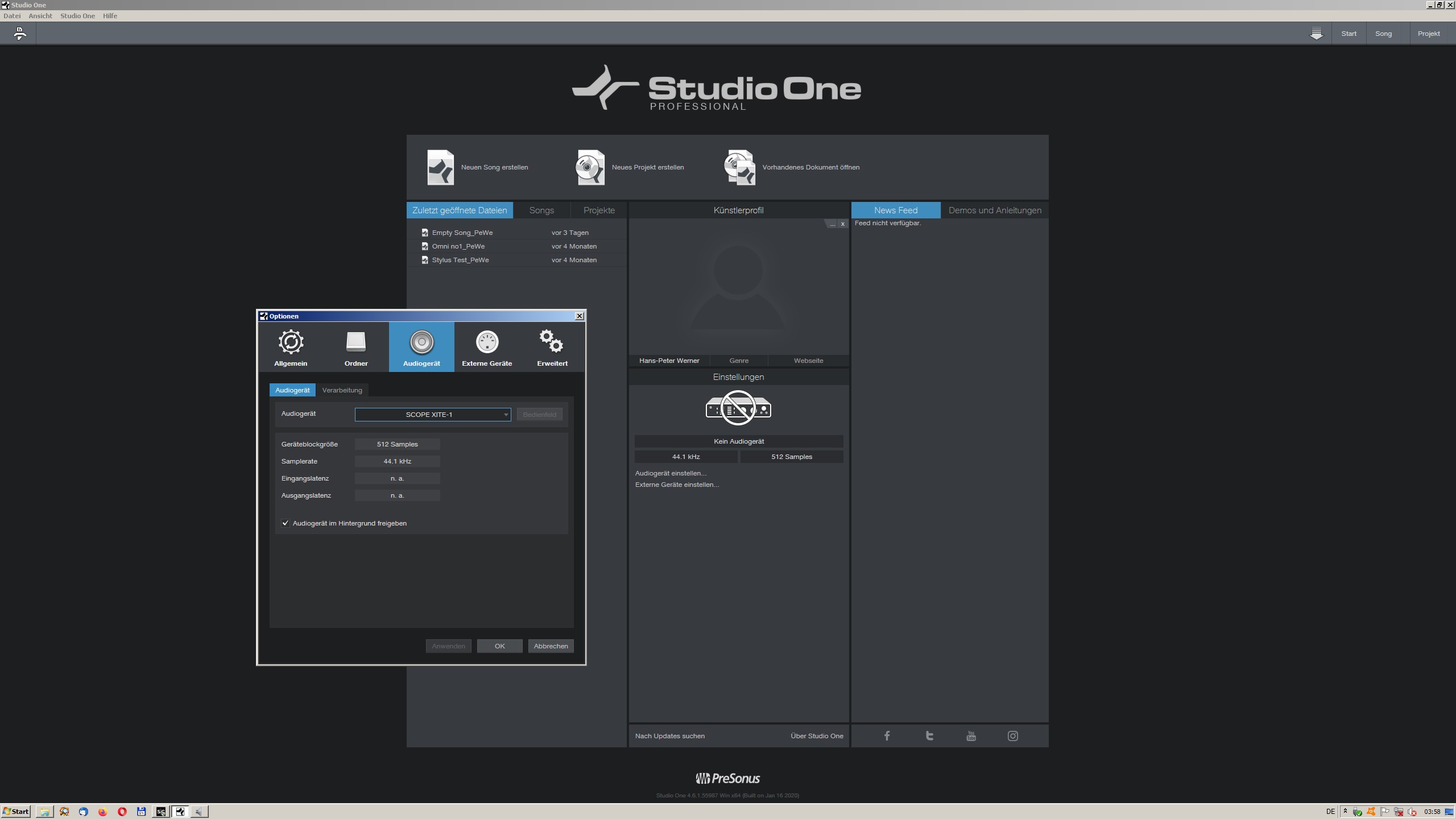

I don´t get any sound out of XITE-1,- SCOPE v7 standalone,- or as the ASIO audio device for Presonus Studio One Pro 4.x, Reaper 6.0.8, Reason 10.4, Reason 11.2 (or any standalone audio application requireing ASIO).
In DAW apps I can select SCOPE ASIO, but impossible (pre-) selecting audio channels like ASIO #1+2 p.ex.

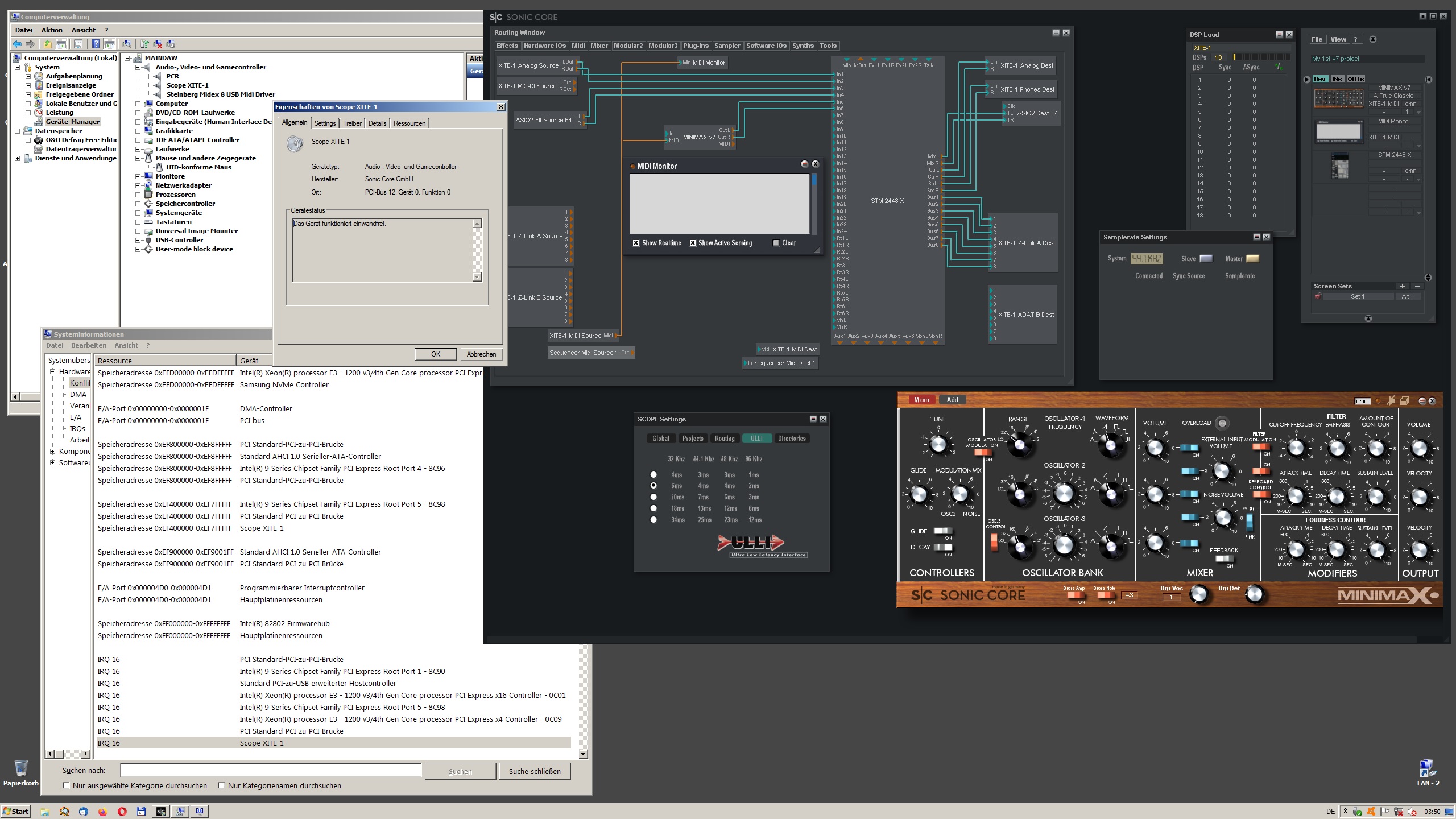

Win7 Pro SP1 x64 device manager shows PCR / XITE-1 and Steinberg Midex-8 as "Video-, Audio,- Game Controllers" ... no conflicts like "yellow warning triangles w/ exclamation mark",- and properties for XITE-1 report it works perfect.
MSinfo32 shows XITE on IRQ #16 together w/ several other devices,- but no conflicts obviously.
Scope v7.0.x_XITE-1 issue.jpg (768.95 KiB) Viewed 21829 times
PS1 Pro 4.x_no audio device_1.jpg (221.26 KiB) Viewed 21829 times
PS1 Pro 4.x_no audio device_2.jpg (240.54 KiB) Viewed 21829 times

AND,- in my case, initialization of ASIO in DAW apps don´t work,- so it´s NOT o.k. in Studio One and all the others too.

And @ Spielraum: I don´t have XITE-1 non-functional driver, marked w/ yellow warning exclamation mark, like you have above.
Sorry for the small size of my pics above,- it´s original size when converting from bitmap (Paint) to jpeg/jpg.
Possibly hard to recognize w/o using windows screen magnifier ...

I get no warnings nowhere in devicemanager and all is reported as to be ready and to work well.
MSinfo32 reports XITE-1 on IRQ#16 together w/ several other devices.

When it´s up,- no MIDI (in MIDI monitor) and no audio out at all.
In Win7 audio device settings, I see XITE as standard audio device, but I don´t see any audio channels listed like I do p.ex. when a RME card is inserted (all the ADAT I/Os p.ex.)...
I created a project w/ 2 ASIO channels I/O and Z-Link A/B I/O.
S|C A16U syncs via Z-Link,- I see at the A16U´s frontpanel.
But no ASIO channels availabe to assign in DAW apps.

What I get here is a driver issue and I have no clue how to fix.
The PCIe card for XITE-1 is pretty well recognized in device manager and works.
If it didn´t, I got no project loaded.
B.t.w,,- in SCOPE environment w/ project loaded,- I don´t see any DSP load or Async percentage !!!
Zeros only !
Any idea ?
Re: Scope/XITE > Exception
v7 works on those motherboards, usually.
something seems really broken with your setup, but i have no idea what that is.
you can't really see hardware problems with the XITE in Windows. Windows has NO IDEA what happens inside the XITE. either the driver is installed and working or it's not, but the XITE itself is not really involved in that, not specifically.
the XITE is not a soundcard. it's not controlled by Windows, so Windows and Windows apps cannot determine what i/o is working or not. all that is in Scope, which merely loads the dsps and provides a gui. apps SHOULD see ASIO. is that a newer version of Studio One? did you try using win8 compatibility mode for Studio One?
it's not a driver issue. i use v7 64bit all the time.
the fact that you see no dsp load and no ZLink or ADAT indicators in the samplerate and dsp windows is the real tell-tale sign. that XITE does not appear to be working. either, something in the Scope install is corrupted, or the project is corrupted, or the XITE has issues. do you have the correct power supply connected?

garyb wrote: Mon Apr 20, 2020 3:59 pm is that a newer version of Studio One? did you try using win8 compatibility mode for Studio One?
fugeddit,- because it happens w/ EVERY DAW app I own AND in SCOPE standalone mode.
The cryptic message appears when I launch SCOPE v7 and from there no MIDI/audio.
No other DAW app in the ballpark, no standalone VSTi or such.

XITE works in a way,- the driver would never been loaded when XITE-1 would not power up and the via Z-Link connected S|C A16U shows slave mode and 44.1K.
When I shut down PC and switch off XITE-1 and re-boot,- there´s no XITE-1 visible in device manager.
So, when it powers up and I see XITE-1 in device manager, it doesn´t indicate it works ?
What about PCIe card ?
Can it be the culprit ?
