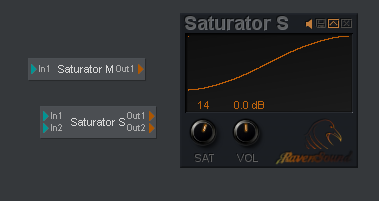

Hi all.
:: UPDATE 31/3 2020 - version 2::
There was a dc artifact on the outputs of the device - it's been filtered out. I now include the redistributable in the zip file.
HEADS UP; Mehdi reported an error message regarding the asio driver, possibly after installing the redistributable (he's using scope5). I've not seen this error myself though, but here's a fair warning. Mehdi reinstalled Scope5 to get rid of the error.
Sooo, too much time on your hands (get them out of your pants).......hey, I made rhyme :lol: )
Here's a little free saturation FX - hope you like it. The dll makes this win7/10 only (you're free to try others, but no promises). Install as usual (ask if in doubt :-) )
If you find any erros, by all means throw me a message.

missing dsp file for me (scope v 5) (may be it is only for scope 7?).
you might want to rename the i/o InL & InR, OutL & OutR eventhough it did not stop it from loading in insert slots.

Thanks :-)
spacef, what OS are you on with Scope5?
I haven't made an FX before, so I played around with the pad-names. This seemed to work, but I'll try your suggestions if I need to update something.
The dll was made in MVCP 2017. I'll try it out in Scope5 on W7 tomorrow.

Thanks soren! very BIG sound using low resources. Have to be very careful with the SAT though

Hi Soren, I am on win 7 x64
The i/o naming convention was important before (long time ago) otherwise you could not load an fx in insert slot.
Your device showed me that this is not important anymore :-) (except if you want the fx to follow general scope naming conventions still used by SC effects).
I am an ignorant, what is MVCP 2017 ? (I just searched in google and did not find anything related to audio or programming or else).
I also suppose that you developped it in SDK 7 ? (as your pack did not include any dsp file, and scope 5 asks for the dsp file "Saturation", I supposed that it is a dsp file that is in Scope/sdk 7 only, so i guess that is not really your fault and it is also the way it is supposed to be with new atoms).

Post by binaural »
Very nice, thanks a lot!
What's the reason the meters go up statically, even when there's no input signal present? I don't hear it, but it looks bad(ass):)

@binaural
I'm not shure I follow - what meters?
spacef
Posts: 3364
Re: New FX: Saturator
Post by spacef »
i think it is about vu meters of mixers where the effect is plugged or inserted.
it is DC offset and you can get rid of it with the DC filter insert effect (or by adding 'dc blocking filter' module inside the device).
(tip for spacef users: those who use the modular mixer v2 can use "dc" button of the rec channel, it will remove the dc offset when recording to a daw, but not in the direct "live" sound where you can use the DC filter fx, do not use both at the same time though (ie insert fx DC + rec channel DC because it is useless to chain several dc filters).
i hope it helps !
