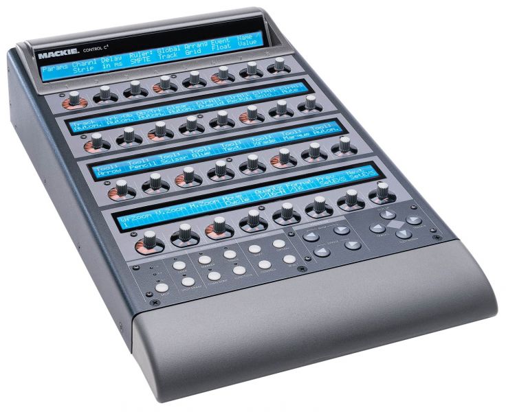

i working with 2x bcr2000 (many encoders) + promix01 (17 motorFader 4xbanks) > controller midi merge > cubase generic control setting> scope > cubase / live > controller for many years. and i am happy. for me it is important that everything runs bidirectionally. layout template on it, and off we go.
the mackie c4 was very brilliant, unfortunately only in one direction, so I pushed it off. too bad that mackie stopped development early :(. bcr2000 + parameter display would be awesome ... unfortunately i waiting in vain for years
sometimes I play a little bit with the c4 commander and dream of how beautiful everything could be, but nobody understands me
c4-test
would be my dream if bidirectional

Hey Spielraum I understand you since i also have the C4 stopped. I bought it really cheap only for Scope control, and I found that the hardware is very simple, each pot sends only the increment and thats all. So it needs the C4commander software or other.
You have to receive this increment, sum to the cc previous value stored in an array of ccs, then map the value to the cc out and send it to your synth midi in port.
I had problems recognizing in Modular two identical cc messages, like when you move the pot 2 steps.
Also you have to send C4 documented sysex to draw the new value in the C4 screen so you are bidirectional. I managed to do this succesfully from BCModular sysex module but i do not recommend using Scope Modular for generate screen texts.
Scope Modular is really powerful but it lacks something every visual programming tool has to have: a script interpreter module to write simple code not audio dsp related. Quartz Composer had javascript module and now VCVrack also has one.
I started then to write a js plugin in reaper that manages all very clean. Problem is that nobody wants to be on front of Scope beast to write midi code instead of sounding like a beast... so its unfinished.
Now im evaluating VCVrack on a laptop when away for developing it as an eurorack module, then port to Scope.
I also have the BCR2000 mapped to minimax and the Korg iMS20 controller with my own MS20 synth developed on Modular and I can say Scope synths with dedicated surface is touching heaven with your fingers.
cheers,
jpo

I'm not sure the Mackie controllers can do CC's as I think they only do HUI, MC & LC modes. Correct me if I'm wrong there as I haven't had one for a while (and I use Logic).
However the BCF & BCR controllers can do any of the above (well, no LC specifically but MC/HUI & MIDI are all there). I never use HUI or MC/LC modes on any of the gear I've had that supported it, and the LC unit I lusted after no longer seems as necessary. I should note I've had issues with HUI & MC modes when bidirectional feedback was enabled, I suspected that the Behringer implementation is causing a midi loop and stopped using it. Didn't have that issue with Mackie controllers.

The Mackie C4 hardware sends only midi cc and receive only sysex, afaik. You move the pot 1, it sends midi ch1 cc1 with the movement value coded. Then receive sysex for leds and screens. It relies heavily on the computer so it has small chip inside and no standalone use. Its the opposite of BCR2000 that is a full programmable midi computer on its own.
Since Scope is always tied to a windows box you always have midi host capabilities at hand so the C4 its the best Scope dedicated controller imho.
C4 has midi channel and cc number hardcoded, and value is 1 for smallest movement (clic) to 15 for largest and fastest turn. Problem is cc means control change or continous control, many midi systems do not recognize a cc value that is not changing.
So if you make 1 clic to the right on pot 1, the C4 sends cc 1 val 1. Then you repeat the move and again sends cc1 val 1. Since this does not change the current val of cc1, which is 1, im not be able to detect this second message in Modular. Well, i can detect it but not if you turn the knob slow but continuosly, clic-clic-clic so an increment of 3 is not detected.
If someone knows how to detect a midi cc message that does not change the current val of this cc in Modular, please let me know, as i get stucked here.
The bidirectional side, using the Modular to compound and send fixed C4 sysex for fixed labels and update the led rings its not difficult, and it works for me.
But if you want to show precise, updated values on C4 screens and not only labels, its easier to use a scripting languaje outside Scope,
jpo
