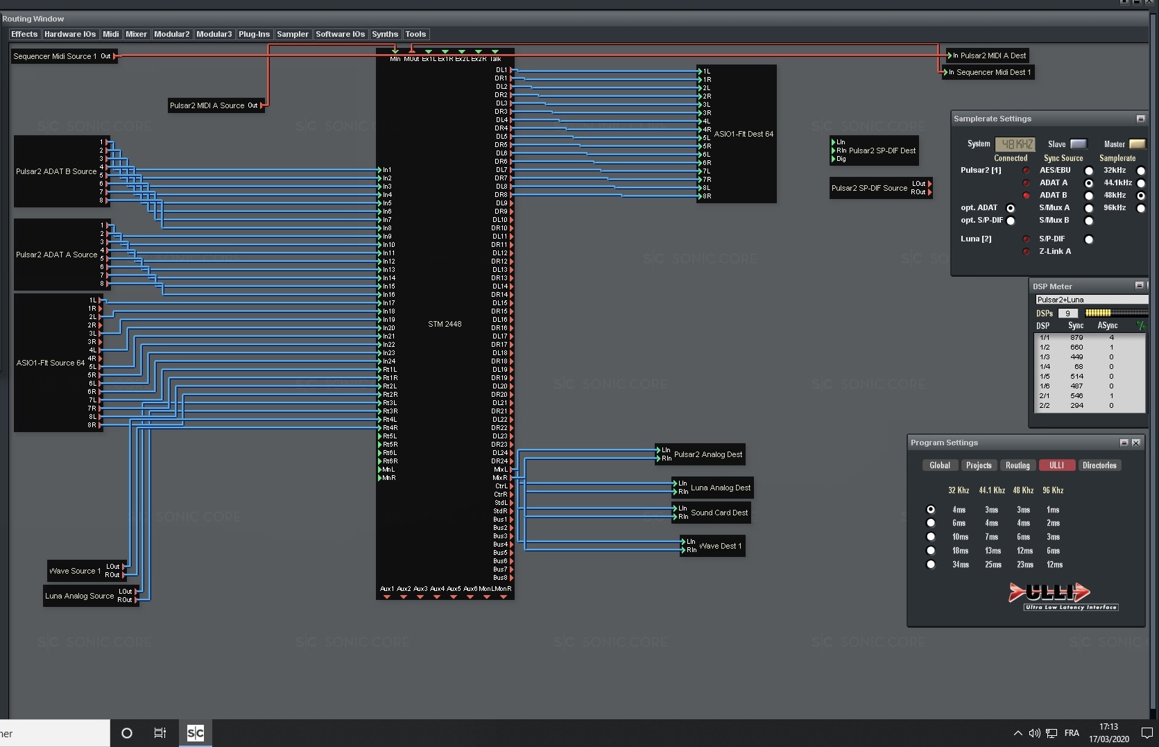

Re: A16 ultra 16 tracks?
Do you have 4 adat cables connected?
This would rule out sync mistakes.
A and B in and outs.
Sync slave/master from /to scope or a16.
It's not necessary but just to trouble shoot.
Best to attach a screen shot of your routing and settings from scope.
Rule out connections before thinking of faulty equipment.
Hope you figure things out.
Strictly East
- Posts: 68
- Joined: Wed Apr 25, 2018 6:41 am
The 4 optical cables in and out are well connected.
- screenshot.jpg (327.44 KiB) Viewed 6104 times

So maybe your A16 has a bad output.
If you have enough soldering skins, you could buy the optical converter at ebay for about 20 euros, I guess.
you could also try to swith to Z-link, if your Luna has those ports.
