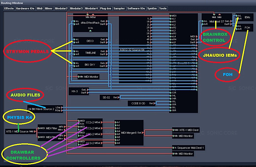

I use an odd trick.
I load 24 Bit Source Modules twice, then keep the 2nd one.
I use to load one and sometimes wouldn’t hear audio.
Granted that was Scope 5 and Windows 7.
But I maintain the same habits since I hate fixing something that works.
Try it, maybe it might work for you too.
