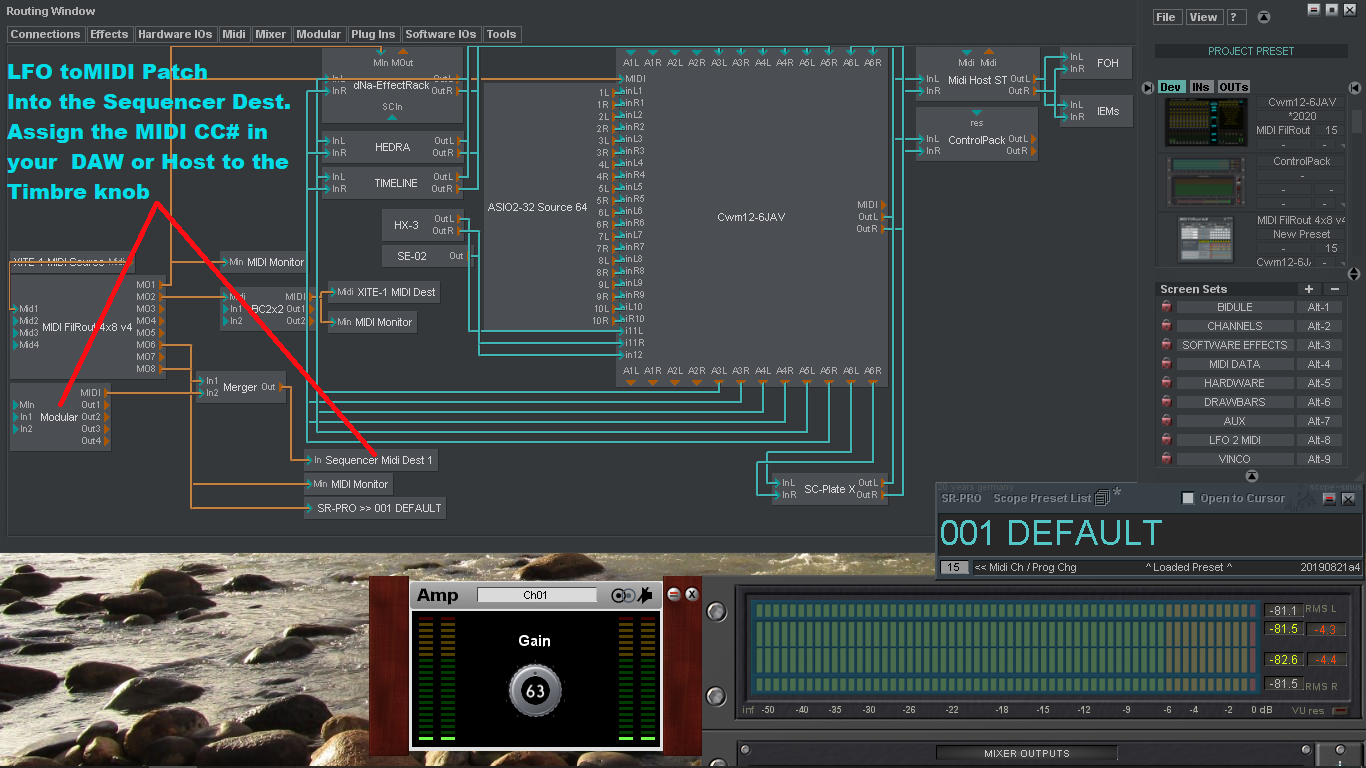

I love motion in music but for a Fender Rhodes old Satellite Pan sound smooth is best.
Find LFO to MIDI Patch in Modular.
Set it up in your project window so the created LFO can be sent from there to the Sequencer Destination Module.

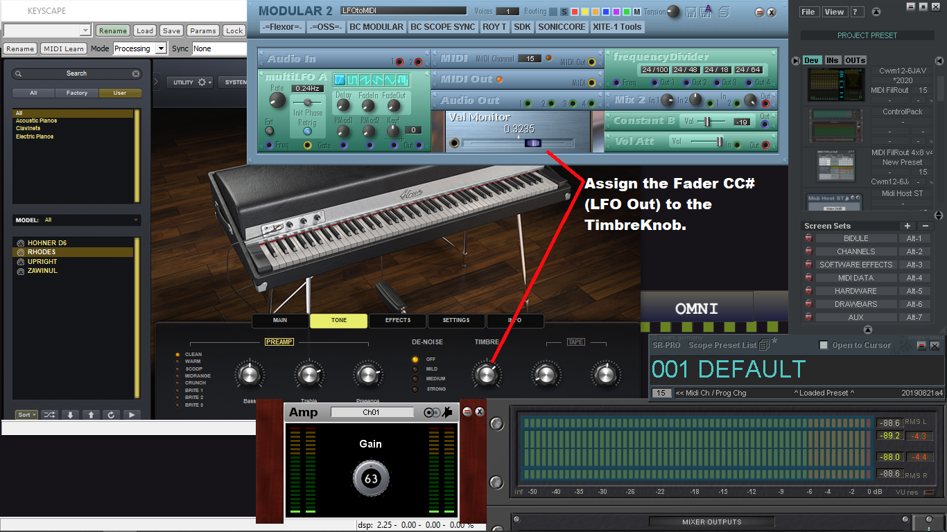

Then right click on Rhodes Timbre.
Adjust however you want, but at stock it moves the Timbre knob from 10 o’clock to 2 o’clock.
You can also adjust the Pan rate to give it that old hardware effect.
This is as close to real as software can get.
Much smoother than jumpy ass Round Robin crap.
