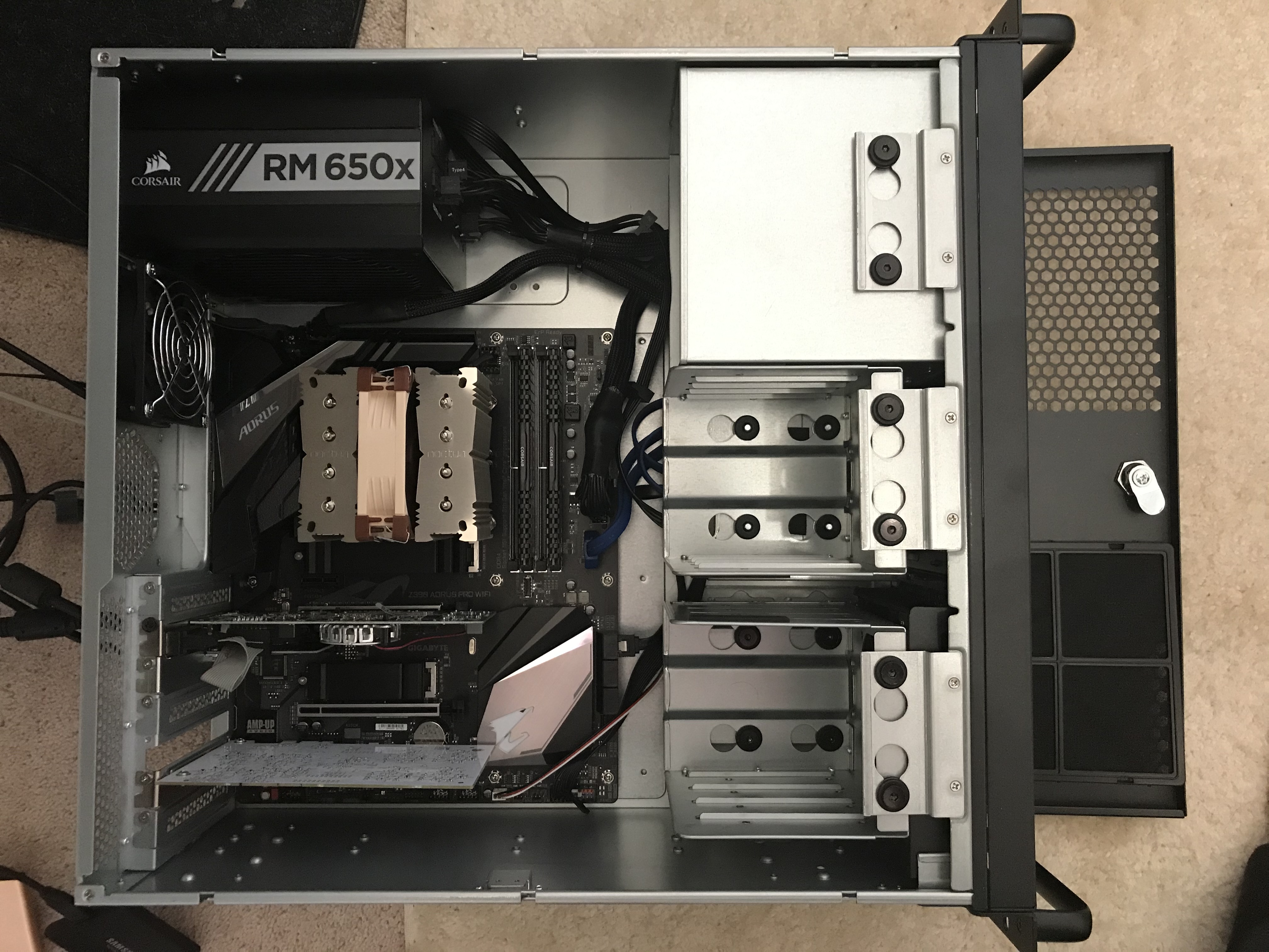

Ladies and Gentlemen - may I introduce you to a favourite song of mine from 1985 - Mike and the Mechanics 'Silent Running' - coz that's what this mofo mobo is all about. I have it running with Native stuff and Zoom audio at the moment - downloading, transferring sample libraries and getting the native stuff up and running before I open up cases and transfer DSP peripherals (Scope & UAD come last).
But when I first switched it on I thought it wasn't firing up coz I could hear - - - - ?? wha... ?? .... NOTHING !!!!! NOTHING !!!! And its been on all last night so I'm assuming its running within temp spec, so the fan is running - it just makes no sound !
For years now I've been front ending my mic into the ZITE-1D analog inputs then feeding through the DAS C350L using its noise gate to cut noise out of the silence between vocal lines.
With this setup I'm now thinking I wont need the gate (assuming the fan noise from the old clunker constitutes the entire noise floor). But I'm pleased so far no doubt !

Nice. I splashed extra money for a Be Quiet tower and power supply a few years ago. Should have done it sooner, lower ambient noise floor is the tits!
Re: New DAW - system bits - now a FULLY OPERATIONAL BATTLEDAW !
Thanks Gary for pointing me to the right keyfile - Scope XITE-1D and UAD2 cards now working, and the whole thing in Rack !

Nice and clean. Compared to my 1987-2005 era machines, it's amazing how minimal computing is inside of any reasonably sized case now.

Re: New DAW - system bits - FULLY OPERATIONAL BATTLEDAW
The only slight issue I had with the Silverstone was the front handles obscure the rack mount screw holes (see above pic for positioning) so its a bit tricky screwing in the rack mount screws (you need a long thin Phillips Head). Other than that, its the bomb !

Inspired by Dante's 'battledaw', and hats off because it saved me - wasn't sure a rack case was a good idea (all the pc builders recommended against), didn't know which cooler to buy etc, until I saw this post. Thought the timing was right as I think the Asus H370-plus is about the last common board with conventional PCI (with a chipset that has known good performance) so decided to upgrade from a 200X machine with a dodgy bios to give my beloved boards another 20-odd years.
Similar config to DANTE but combining 2 PowerPulsar (I think they were called back in the day) boards with Xite on the same box.
Couldn't justify the i9 so gone with an i7, and going with integrated graphics for now as it is just for music.
What really blew my mind, is that I installed the software for Xite and the scope cards (communicating via ADAT), then merged the install directories from my old box into the new ones, copied Reaper projects over, fired up Xite and Scope apps and Reaper and the whole thing JUST WORKED STRAIGHT AWAY! Literally loaded my whole rather complex setup, lots of synths, effects, routing in and out of Reaper. All in all, it took me about 4 hours to build the PC, install Windows, and get music out of Scope.
After 20 years my Scope stuff still brings the joy it brought when I first got it. Touch wood, but rock solid so far and oh so responsive.
