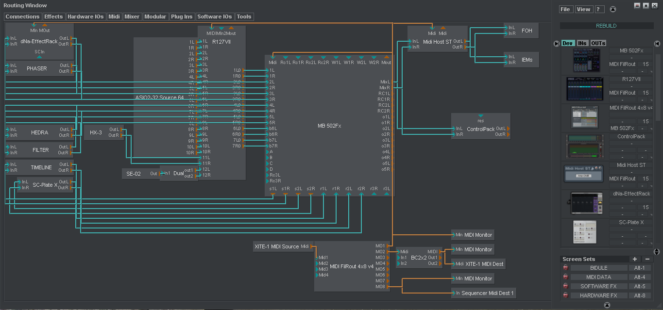

My aim is to have a single MIDI knob that, when I turn it, multiple things are adjusted in Modular.
Specifically, I want one knob to:
Attenuate gain
Boost gain of a low shelving parametric filter
...across two channels
I've been looking in Modular and I can't see a way to do it.
Anyone got a tip on how to do this?
https://imgur.com/W1PuJXk
asktoby
Posts: 211
Joined: Thu Mar 13, 2003 4:00 pm
Re: Moving multiple controls with one MIDI knob
Post by asktoby »
Solved it!
Found I could use SpaceF's CC5 module so:
https://youtu.be/RBTuLUS1tec
