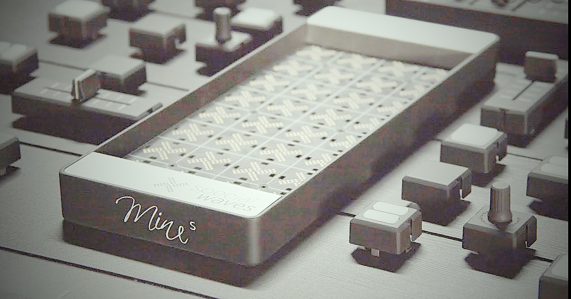

I guess I can always create another zone, and power the extra controller from one of the many Physis K4 USB Ports.
Then MIDI to the Strymon using one of these customized controllers designed for certain tasks.
https://youtu.be/S6O0Io2BVRo
https://www.indiegogo.com/projects/mine-s
May as well get the 32 Module version.
The Double Button Module is great for holding down 2 footswitches on say Tap, and then Reverse.
Reading the manuals now.
Strymon MIDI Control is pretty extensive,
Guess we’ll see wassup.

Some great looping tips there Borg! esp for people like me who are foot spastic.
JV, that Mine-S looks really cool. Def signals a new wave of next gen controllers.
Pricey though and the first thing that came to my mind is whether customizing a layout is worth the extra $$
as opposed to just buying something like this: https://reverb.com/p/novation-zero-sl-mkii
I'm most likely missing some very important new feature and with your line of work, customization is probably a pretty important aspect.

Yeah they’re way too pricey and thanks for the Reverb hook up.
Never knew they made a keyless Controller.
For a buck thirty four I think I’ll get one of those.

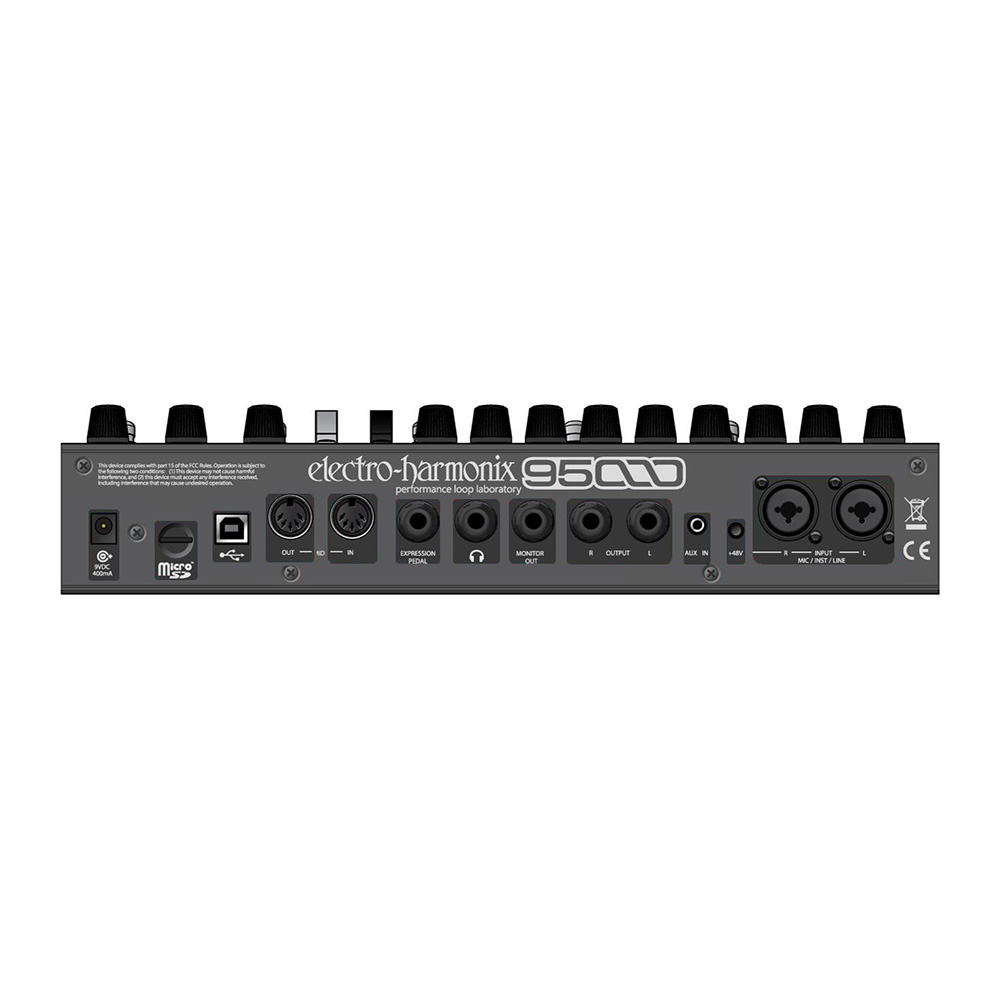

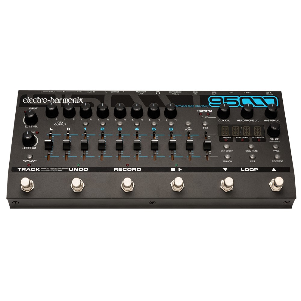

Seems I was misled about the Volante storage and recall resources.
My main necessity is to call up loops in real time via PrgmChng messages.
Strymons don’t have that capability.
So after careful research I found the ultimate Looper with memory for 100 loops pre recorded.
You can reverse loops and store that so it’s recalled.
That really helps when you know there’s a song where you want bars 7 and 8 to have a reversed 2 bar phrase.
You think in your head reverse so you record the first two bars leaving 3-8 blank.
Then you reverse it so now you reversed lick is on the 7th and 8th bar.
Basically how Hendrix pulled off such cool solos on the LPs.
Yu must think in reverse.
But the EHX 95000 is a one stop shop.
Used on eBay for 365 shipped, not too expensive.
I’ll automate it with MIDI since it’s spec’d out really well.

Re: Strymon Volante Synth Demo
That one looks like a keeper. EHX make really solid gear. Nice features, I esp dig the micro SD slot

Each loop recallable via MIDI PrgmChng messages, and if your drummer is a little too excited prior to the loop launch, just tap in the tempo.
If he has just decent timing your fine.
