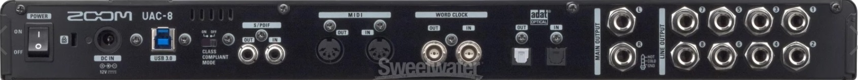

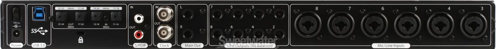

From Sweetwater the front runner is - https://www.sweetwater.com/store/detail ... -interface

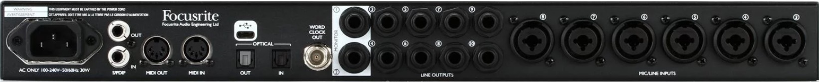

Out of the following 3 - the Focusrite is only USB2 and the Presonus has no MIDI but the Zoom has MIDI and is USB3 - from what Ive read - USB3 is a magnitude of order higher exchange rate than Firewire - which is definitely used for audio. In the context of bandwidth being bandwidth - whats the difference between audio, video or any other kind of data ?

Looks like the Focusrite is a USB-C

I think its gonna be the Zoom. Gets a 5 star rating here - https://www.musiciansfriend.com/pro-aud ... -converter - and it reckons its 8 x faster than USB2 and 6 times faster than firewire, and does 4 x oversampling both in and out, high end AKM AK5388 A/D converters - and high resolution internal sampling over and above the conversion sampling rates. Retails at well under 1 large ($829AUS) here --- https://www.storedj.com.au/zoom-uac-8-u ... -interface
So I guess this is THE ONE !!!

Took delivery of the ZOOM UAC-8. Its an awesome piece of kit - although I haven't tested everything on it yet. EG A/D converters, in built DSP etc.

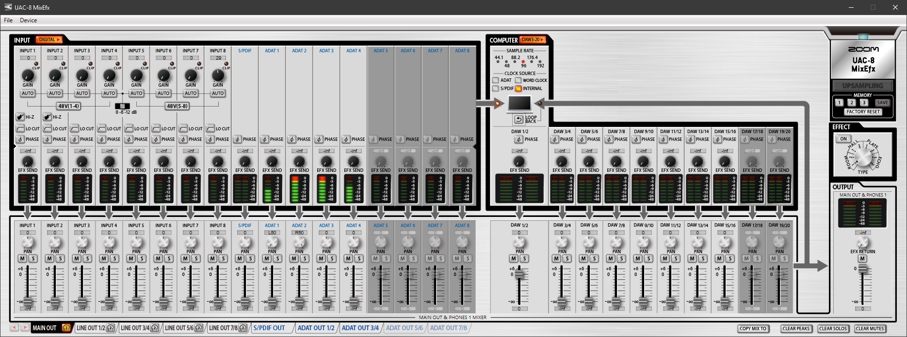

In terms of using it WITH Scope - I haven't got it to do everything I wanted. I managed to slave the XITE-1D and PCI Cards at 96KHz using ADAT SMUX and route proWave and proTone output back into my Reason mix, but when I pressed the 'loopback' button on the UAC mix app for mixdown, it wasn't capturing the proWave and proTone output. Might be something I have to tweak.
But in terms of using it for redundancy when Scope is down, it will fit the bill nicely and then some. Has a great mixer app - for example, if I were to split my Reason mix into 8 submixes (bypassing the Reason SSL) and sending those to the UAC Drivers - theres facility in the UAC Mix App to create 4 independent mixes and send those to musicians who wanted their own mix.
