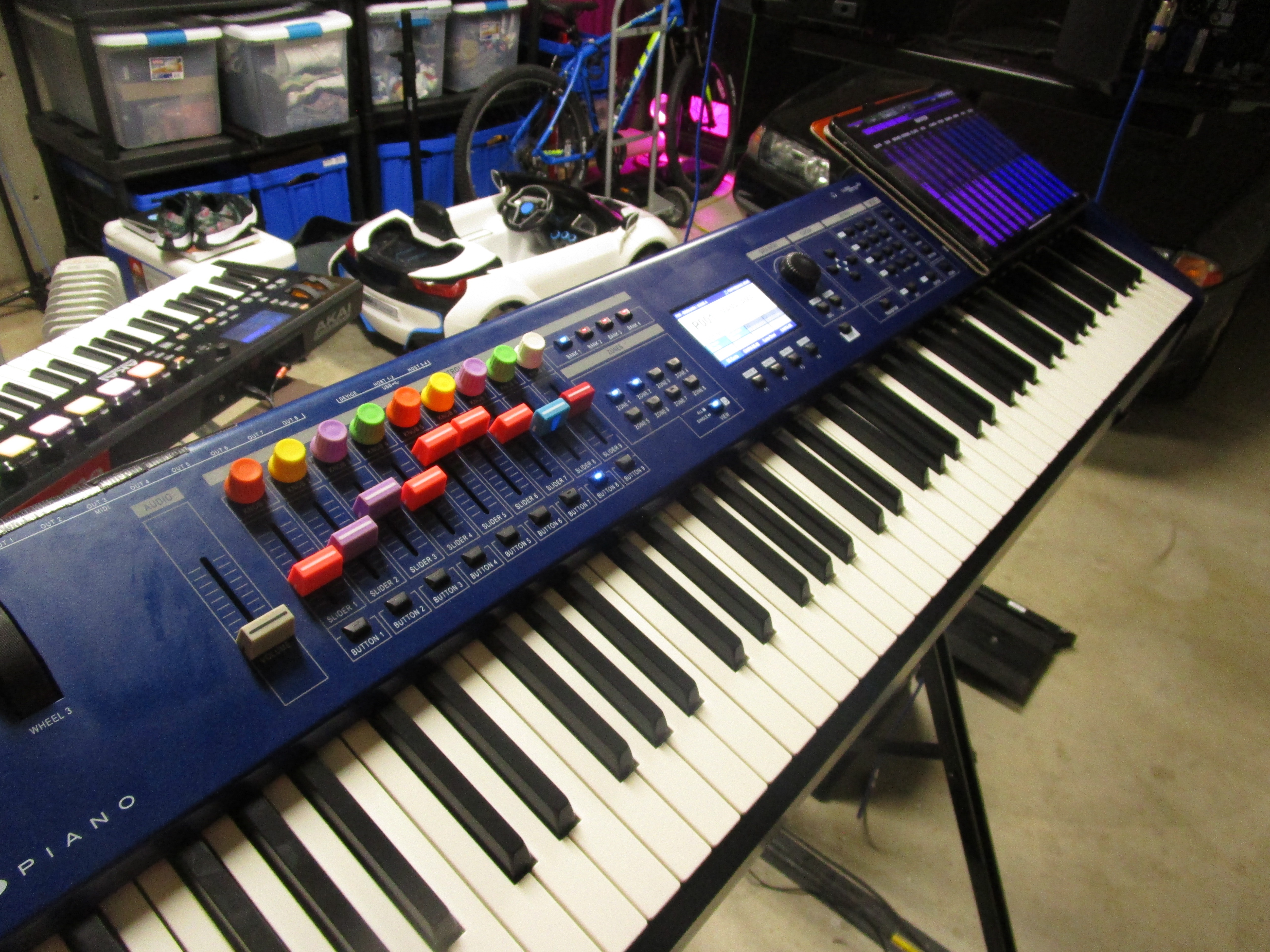

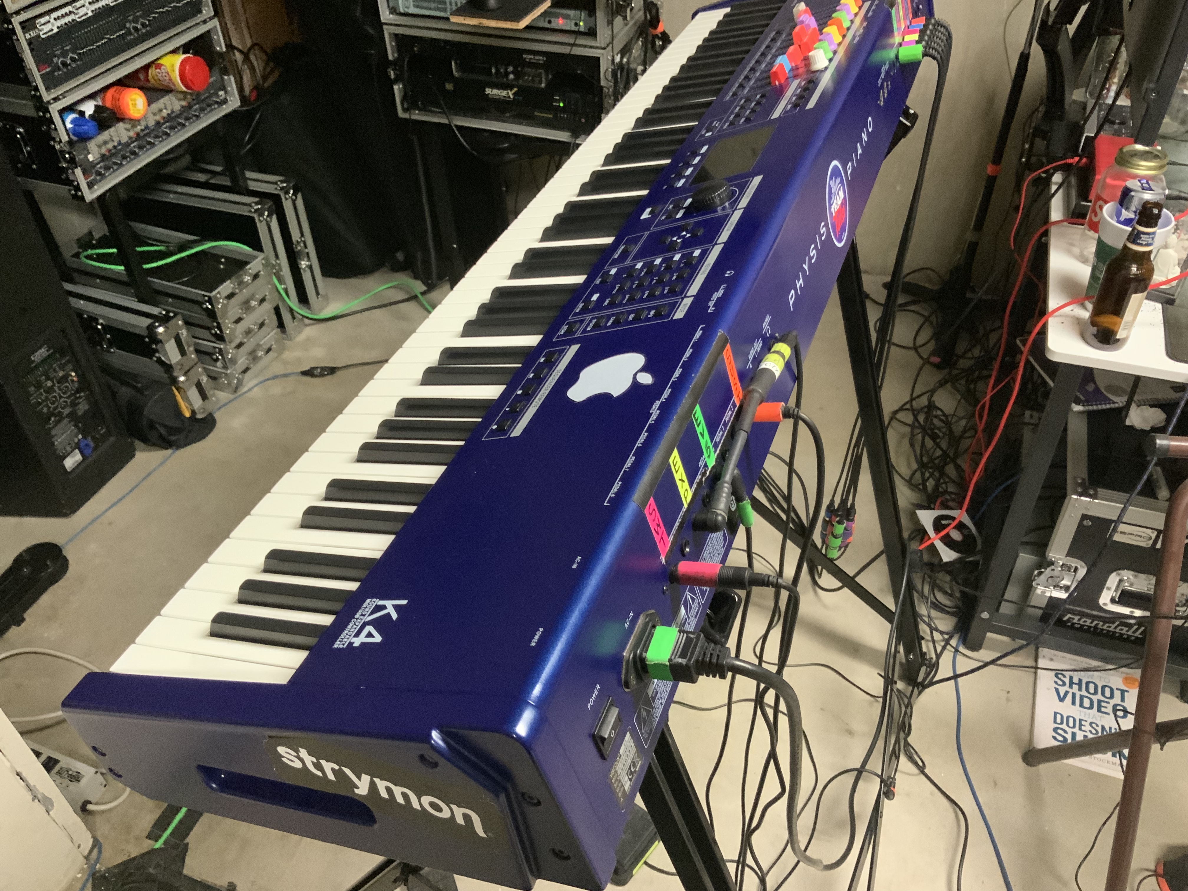

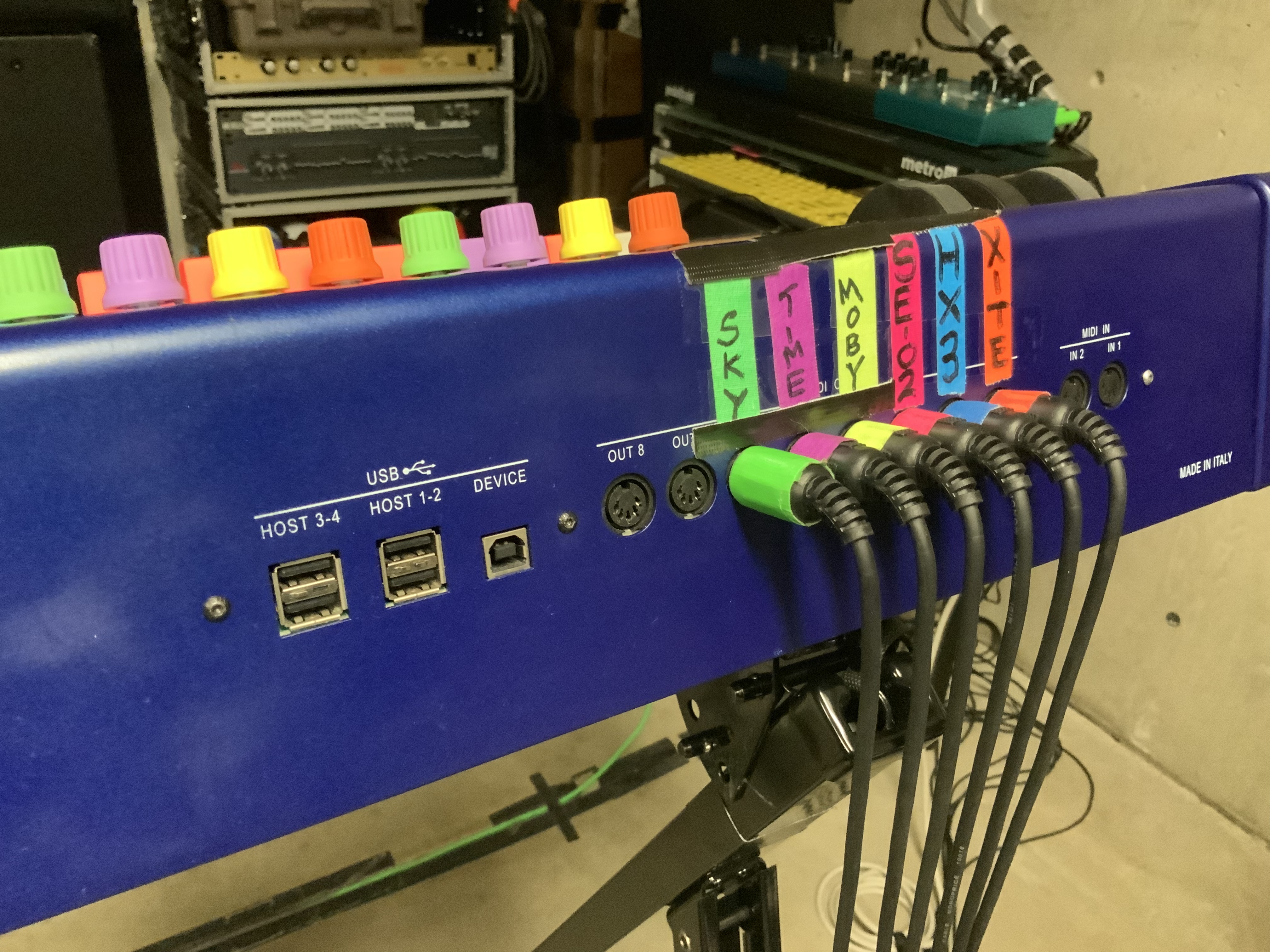

I have pics below of the numerous ports available to me, I’m clueless to what I’ll need for apps cables, etc.
So I’ll explain what my first goal is.
On the left side of my Physis K4 is 9 knobs 9 faders 9 buttons, 4 x Bank buttons that are each another 9/9/9 set up.
To get to bank 2/3 or 4 I must hit a Bank button.
My first goal is to have an app on iPad Pro that can be a replica of the Physis Banks mentioned above.
I don’t like switching between banks while playing, so the iPad Pro would be the 2nd bank button and second set of 9/9/9 controls.
In other words I want a layout of 18 knobs 18 faders and 18 buttons.
Basically exposing the 2nd bank.
Any suggestions are appreciated and also confused about cables, etc.
Each controller mentioned above can send messages out of any of the USB Ports or 8 x MIDI Ports.

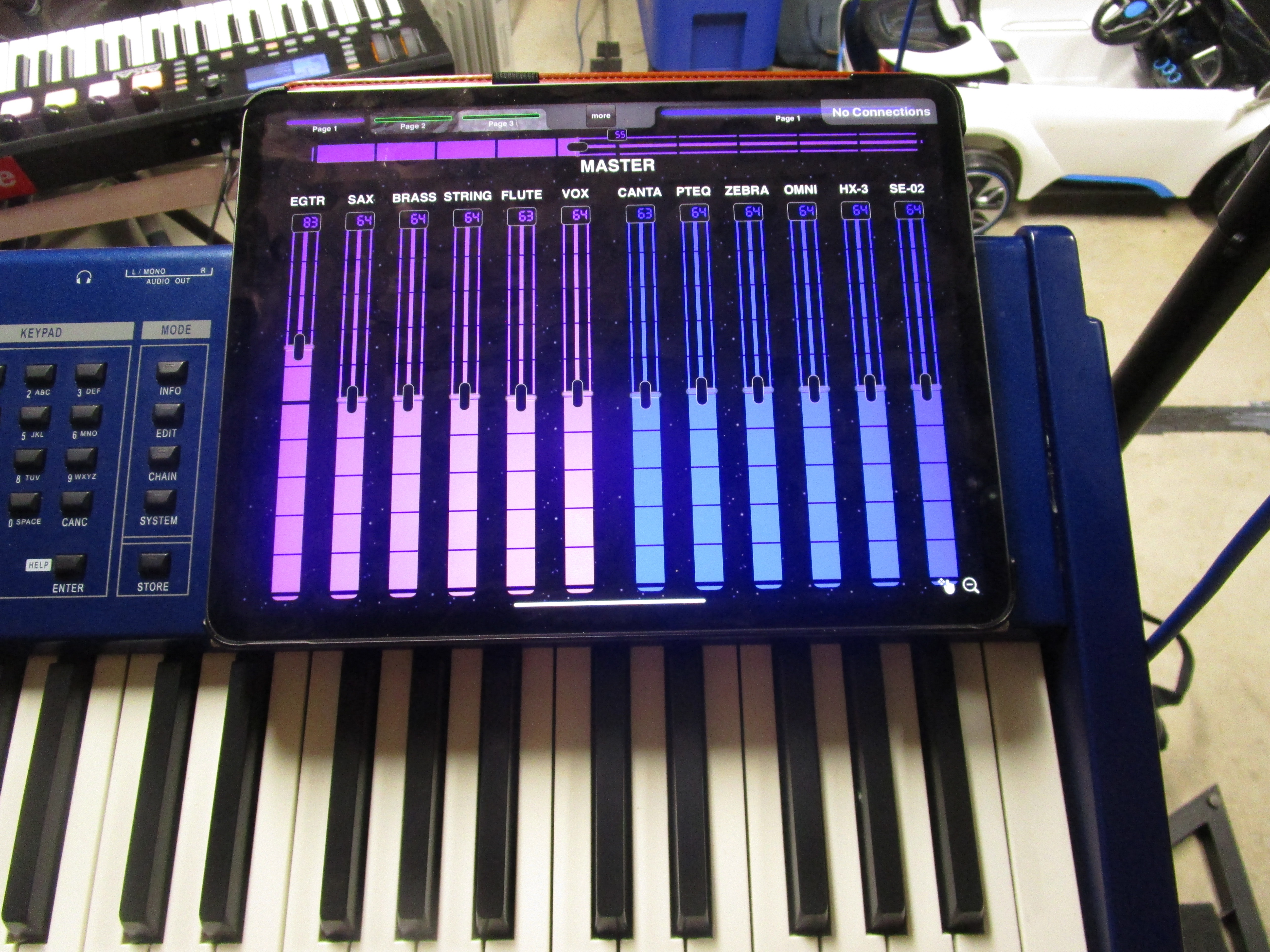

Sounds like you just need buttons, so most apps can do this. If you want a few knobs/sliders/x-y pads for morphing several CC's at the same time, I think:
MIDI designer Pro 2 is the best app for live use...the visuals work well for that.
LEMUR is super powerful, but more complex to build a patch. But, it really can do anything.
If you catch them on sale, you probably won't spend much more that $40 for both.

Just some easy stuff for now.

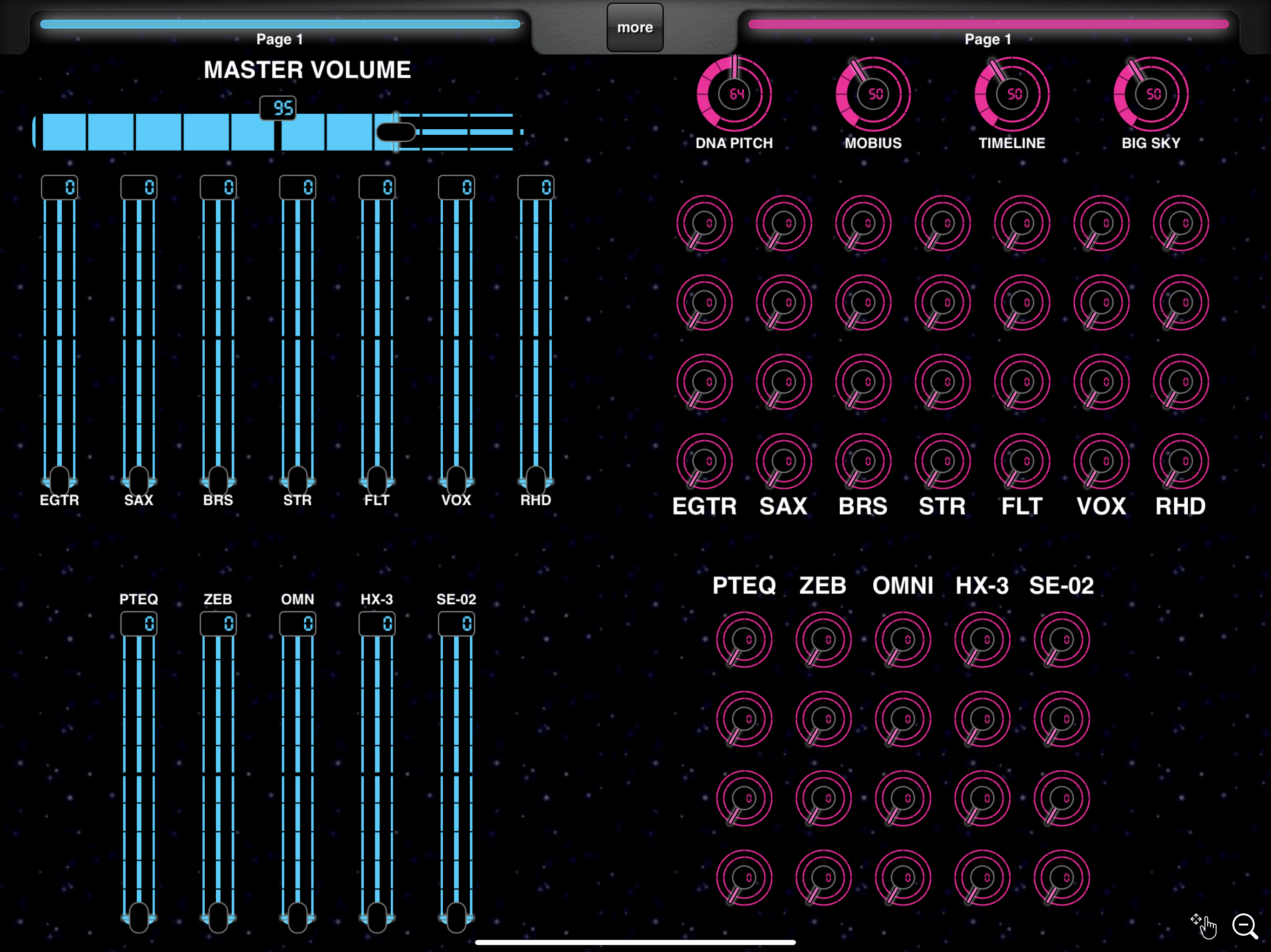

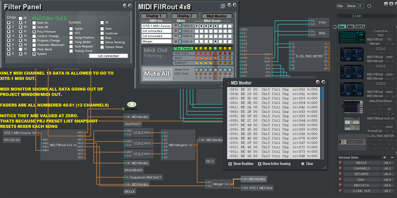

Well now that I decided to use MIDI Designer Pro 2 I’m curious if Scope Mixers send out MIDI CC information.
Here’s my new Goal.
Send prgm Chang messages from Physis K4 (ch. 1# ) which in turn load PRJ Preset List (snapshots) that load mix # 1 out of 128 mixes/
If Scope Mixers send out data this could be captured in my iPad Pro where I’ve got a layout that is volume for Master + 12 channels.
iPad Pro via MIDI Design also has trim values for all 4 aux, plus 4 aux for each channel.
So whatever snapshot of the project window gets recalled, the same values would be recieved on the iPad Pro.
I would use a MIDI IN of the K4 which is programmable so I could route the data to the USB Port that iPad Pro is hooked up to.
I already have Scope MIDI Out going to my HX-3 Organ module (ext. hardware) this is the drawbar devices from SpaceF. I would need a MIDI Router here that would receive one MIDI Out from Scope, then send data to the HX-3 and the K4, which is then routed to the iPad via USB.
Sure is complicated but this us Scopes strength, routing.
Please tell me Scope Mixers send MIDI Out.
They have a MIDI Out seperate from MIDI In on all Mixers...
Ankyu
Here’s my new Goal.
Ankyu
- garyb
- Moderator
- Posts: 23474
- Location: ghetto by the sea
Re: iPad Pro Apps Need Advice.
yes, they do.

Right on, I’m going to have fun with MDPro 2.
You can actually take a picture of a Strymon Pedal, overlay controllers on it, then add 44 more controllers for every reverb algo and parameters.
I’ll take a pic of the STM 1248 (customized in paint), just 12 channels and only 4 of 6 Auxs.

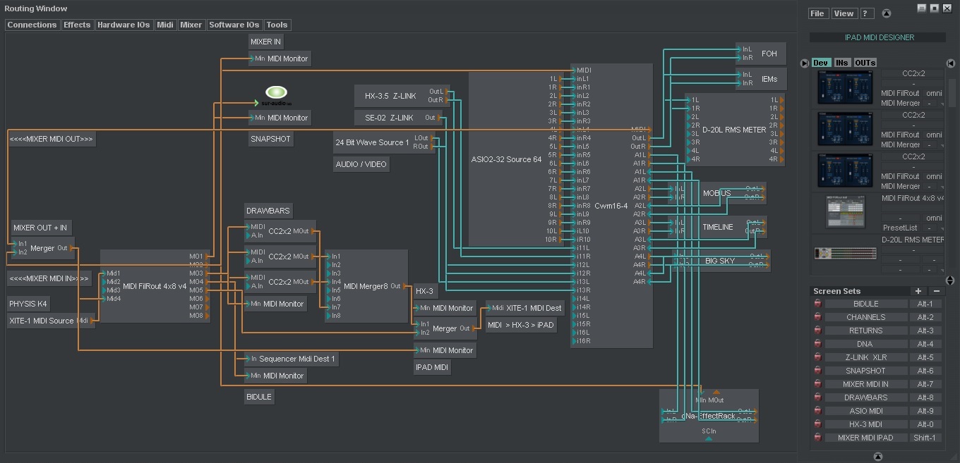

- Posts: 14368
- Location: PROJECT WINDOW

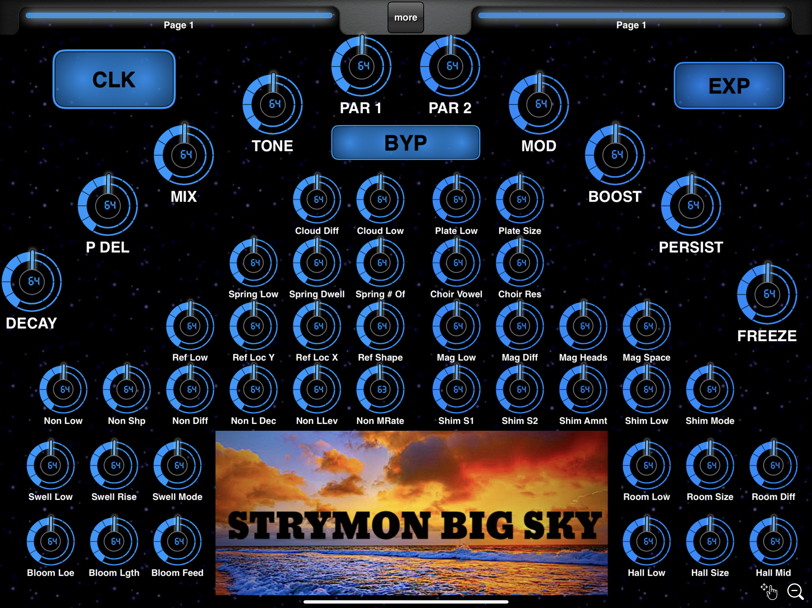

Mixer + AUXs, and the Strymon Big Sky Reverb so far.
All 12 reverb machines most important parameters, plus larger actual controllers on the pedal.
Easy money now.
Easy money now.
- Posts: 14368
Interesting discovery.
Scope sends out MIDI but only if you use the mouse to manually move a fader, etc.
Odd because I watch the faders move by using my faders on the Physis K4.
But this method for some reason won’t send the data out.
Only if I use a mouse....
The experiments will continue.
- Posts: 14368

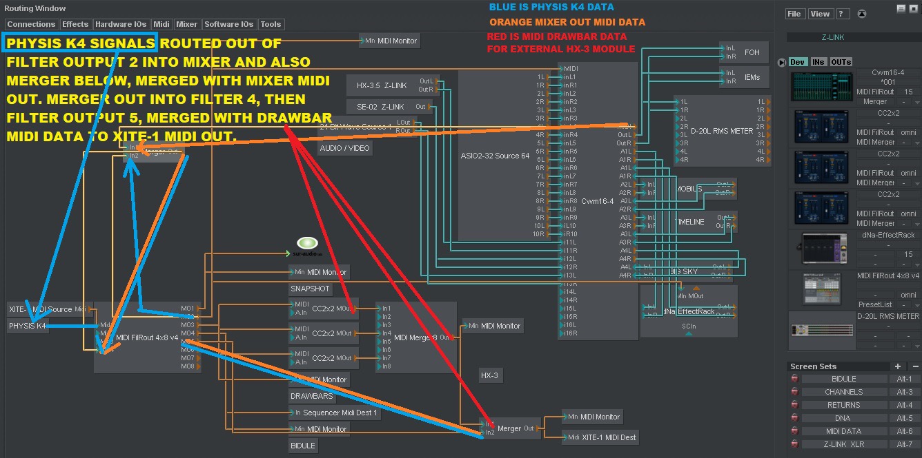

Sucess.
Long time ago the SpaceF CC Devices sent out MIDI Data, but their outputs needed to be merged with signals from MIDI Source module (Physis K4).
Since Scopes MIDI is kind of weird I thought maybe the Mixer was like SpaceFs Devices, so I merged the signals from the mixer and the MIDI Source Module (Physis K4). These were further merged with SpaceF CC Devices (drawbars on my Hammond Module).
Now Scopes Mixer data and my Hammond Module are directed to XITE-1 MIDI Out.
Data to the Hammond Module is perfect, and the Scope Mixer data is sent into the Physis K4 and redirected to bi directional USB / iPad Pro using MIDI Designer.
Scope will do anything if you have the will to dig deeper.
Fuckin’ A....
Fuckin’ A....

- Posts: 14368
Complex, but fully automated now, with bi directional MIDI via iPad Pro.
- Posts: 14368
Only thing making me scratch my head is MIDI Out 5 on MIDI Filter says not connected.
Its connected to the Monitor displaying iPad MIDI values.
Any other time Maus Filters shows the connections?
I see said the blind man....
- yayajohn
- Posts: 1774
- Joined: Thu Mar 01, 2007 5:01 pm
- Location: Everywhere....Nowhere
On your screen shot it looks like it's Midi 4 not 5.
Did your route the output to 2 different locations and then disconnect the second?
