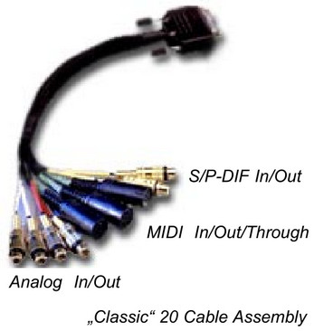

I'm waiting for my Solaris that should arrive within next months. I must be ready ! I'd like to link my PCI cards to the Solaris thru analog I/O but also via spdif. Apparently, on my recently bought 15 dsp card, I've got a cable fouet classic 20 in which there is spdif I/O.
I see only RCA's. 2 yellow are named DIG IN & DIG OUT. Are they the spdif ?

I was speaking about this (from Scope "connector" pdf p.2) :
classic fouet.jpg (25.03 KiB) Viewed 5441 times
Mine is not exactly the same : all RCA's are in plastic. But there is 2 yellow (like on the picture) "DIG IN & DIG OUT". Are they spdif ?

But nobody confirmed that classic fouet "DIG IN & DIG OUT" are actually the spdif I/O ! Anyway, I don't know what else it could be.
