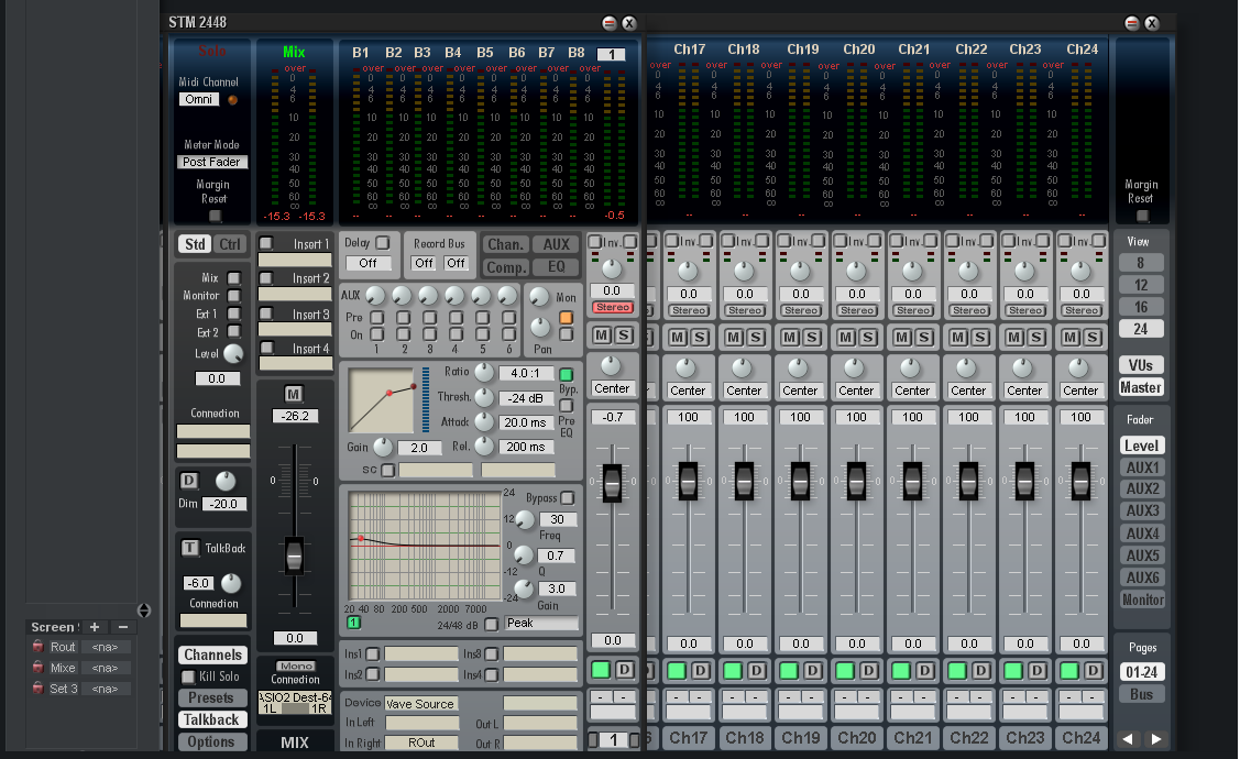

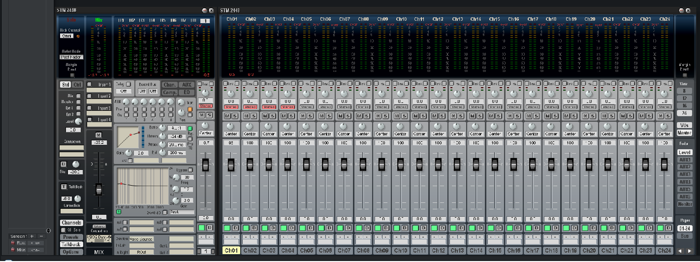

1. When I position the STM2448 Main mixer window on the screen and align the Channel window next to so it almost looks like one big window when I save a screen set with the windows in this position and select another screen set and return to the saved screen set with the STM2448 mixer the channels window jumps to a different position to the left.
STM2448-Correct Saved Position.png (141.62 KiB) Viewed 3351 times
STM2448-channel window jumped left. png.png (154.9 KiB) Viewed 3351 times
As you can see the windows jumps left, the only way I can get it to stay in the correct position is to move the channel window to the right by the amount it jumps left and then when it jumps left its in about the right position, but it takes quite a while to do this and every time I want to make a slight channel to the Screen Set i have to repeated the process as when you unlock the screen set it them jumps left again.
