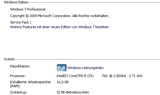

Although you have to respect, that there's no official support for this from M$, there is hope.
See attached screenshot for my combination. ( unpatched systems show something like 3.5GB, no matter how much RAM there is.)
