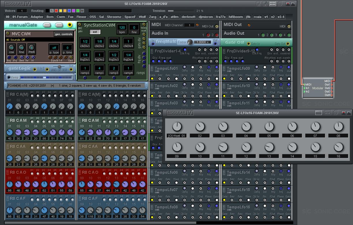

- LFOx16 | a tribute to j9k FOAM(M)
- 2018_12_05-SE-LFOx16-FOAM-20181205f.JPG (207.53 KiB) Viewed 27853 times

Re: LFOx16 | tribute to j9k FOAM
try and error all night long
but so crazy shit
but so crazy shit

now LFO Wav and Switch Out with St24x8 note to preset trigger of step values
and a ContrSeq summer
logisch, natürlich von CWM
XITE1+winXP+Scope5.1 benchmark tested:
> loaded: 10 instances, more seems possible, but with a very long loading/saving time
> results:
# 160 Tempo MIDI LFO´s, corresponds to 160 CC´s for extremely morphed setups, when routed 16 LFO-Out to 16 CC/instance (up to 10x16 Midi Channel routed to SCOPE 8-Sequencer Midi Dest + XITE Midi Dest)
# 320 Sample and Hold units
# 20 Gate Sequencer for LFO s&h
# 10 Control Sequencer tracks, when routed 16 LFO-Out to 1 CC/instance (up to 16 Midi Channel routed to SCOPE 8-Sequencer Midi Dest + XITE Midi Dest)
unbelievably overwhelming
XITE rockt christmas 2018

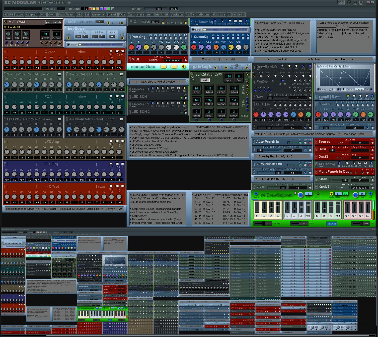

changelog 20181212a:
# now with this TWO SECTIONs Draw LFO & Free Hand you can draw/write the selected Output to ">> Offset" 16 Knobs
trigger over contrSeq cwm "Draw Steps"; a fantastic way to stamp geometric basic line
## manual punch/record in, auto punch out on ramp-end
## random Step source
## Preset over Note Trigger (Basic Midi Ch2)
outboard testing brought true joy

Re: OFAWO | FOAM(M) inspired
changelog 20190111e:
# rework in new shell BC322416 for future data transfer
# rework draw-concept Auto Punch In/Out
# manualGate short trigger (left) to generate new SnapShot example Synth Parameter
# Gate On/Off manual or Midi Note to manipulate Hardware Sequencer Lines
# SummSq: route "OUT >>" to 1x Midi CC
# drawing up to 16 knobs with trigger over "DrawSq"; "Free Hand" or Manual, a fantastic way to stamp geometric basic line
# Step-Knob Source, programmed, random, select manual or feeback from SummSq
# Step On/Off (val127)
# Destination set manual or automtic (Seq)
- OFAWO | FOAM(M) inspired
- SE-OFAWO-20190111e.JPG (477.63 KiB) Viewed 27021 times
