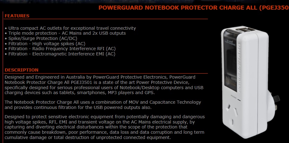

A couple of months ago my PowerWare UPS (http://www.hitfoundry.com/issue_08/ups_mast.htm) crapped out so I took it out of the circuit. After that I noticed a lot of crackles coming in from the mic, so I got this powerguard surge protector which I put on the mains outlet. It has reduced the crackles and pops but not eliminated them all. Anyone got a better idea / filter device ?

:D are you serious? These crackles dont come out of your socket. Check other sources, preamp? Etc..

Im serious because the cracks and pops happened immediately after I removed the UPS. Nothing else changed. I also bypassed the preamp and plugged the mic direct into the XITE-1D (balanced). Same problem.

That isn't really a high end device you have there. However what you are experiencing sounds like it's a ground issue, try a Ebtech Hum X Ground Line Voltage Filter. They're useful to have even if it doesn't solve this issue.

I agree ! It might be a ground loop somewhere. If the Valis Ebtech Hum X Ground Line Voltage Filter contains a simple 1:1 voltage transformer, the guy on this video says it's a protection against ground loops, so there is a voltage transformer inside, it should do the job.
https://m.media-amazon.com/images/I/E1GRxiUsK4S.mp4
Indeed, your powerguard notebook protector charge all doesn't seem to have a transformer inside that will electrically isolate completly the output of the filter from its input, so no ground loop can appear.
If you still have crackles after adding a filter with a transfomer inside ... it'll mean that it's not a ground loop issue... :D Tell us what result you get !
