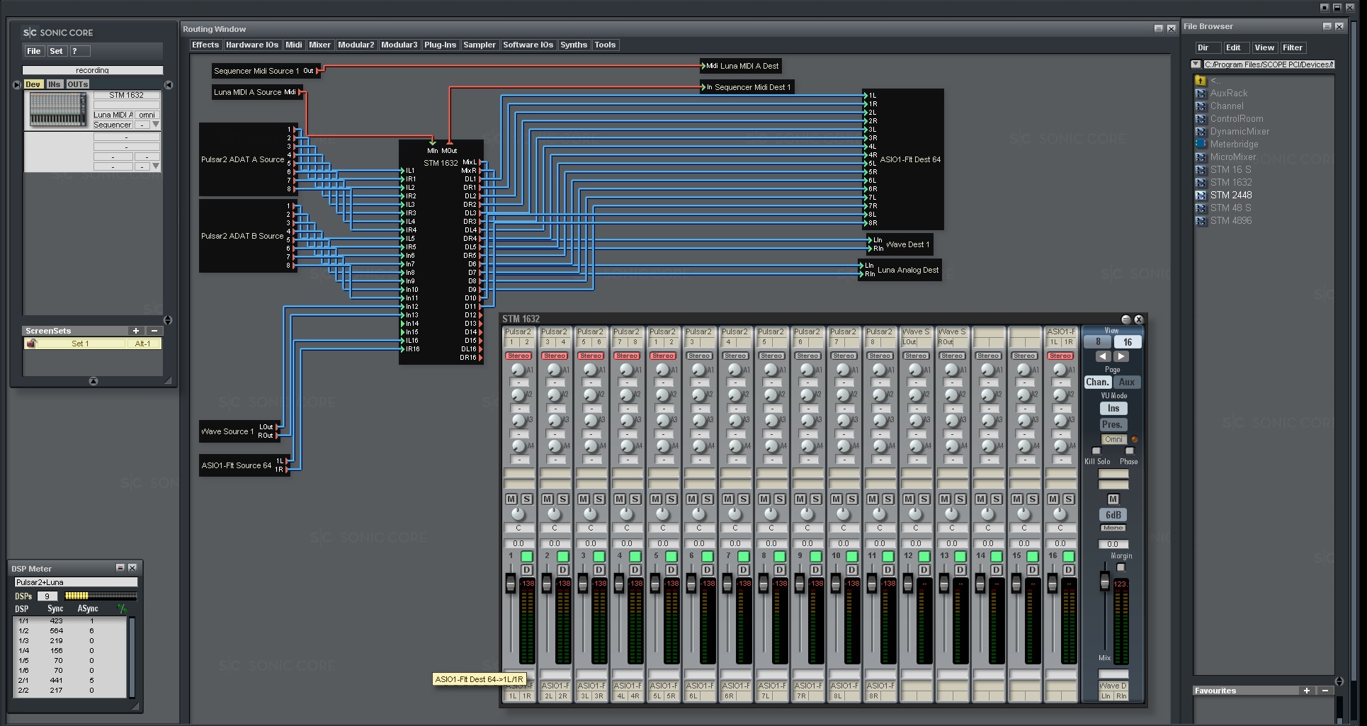

- screenshot.jpg (330.08 KiB) Viewed 6440 times

I don't see any external signal being sent to the Asio Flt Dest 64, but an Asio Flt Source 64 is.
By your project, the signal from the ADAT A and B sources should be the ones going to the Asio Flt Dest 64.
Or maybe I understood wrongly what you are trying to accomplish.

I just want my 16 Adat inputs to be active in my Daw.
I understand from what you say that I should connect the adat a and b source to the STM 2448 so that they are directly connected to the asio dest.
Re: No signal in scope and daw
Not to the STM2448 but to the STM1632 Mixer!
As you have it now, the signal from both ADAT A and B stops at the STM1632 Mixer and only go to Wave Dest 1 as Mix out.

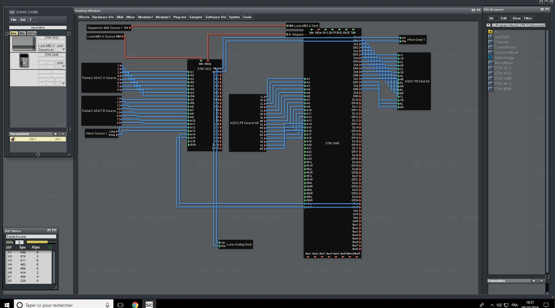

So I just modified my scope project, but the result remains the same.
As in the pictures, the signal arrives well at the console and it sends back well to the A16 ultra
- screenshot 2.jpg (485.65 KiB) Viewed 6342 times

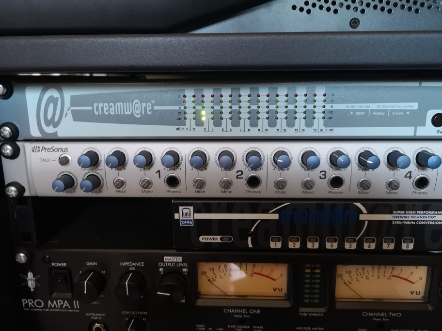

The a16 ultra
- IMG_20181009_122203_resized_20181009_122325472.jpg (135.23 KiB) Viewed 6341 times

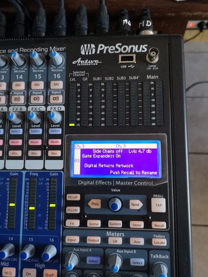

the console
- IMG_20181009_122151_resized_20181009_122356737.jpg (192.08 KiB) Viewed 6340 times

Indeed the project for the Luna 24/96 was fully connected to the stm 1632, it is similar to the last project in screenshot.
My Luna 24/96 project had 8 asio in and 8 asio out + the zlink
when I installed the a16 ultra being convinced that I needed as much asio in as I needed asio out with the 16 channels of the adat the stm 1632 did not have enough input, so I stupidly believed that by making a connection between the 1632 and the 2448 everything would work.
But here apparently the routing seems good, and I have trouble understanding why the a16 receives the signal and not the sound card, I'm starting to wonder about spdif connectivity
