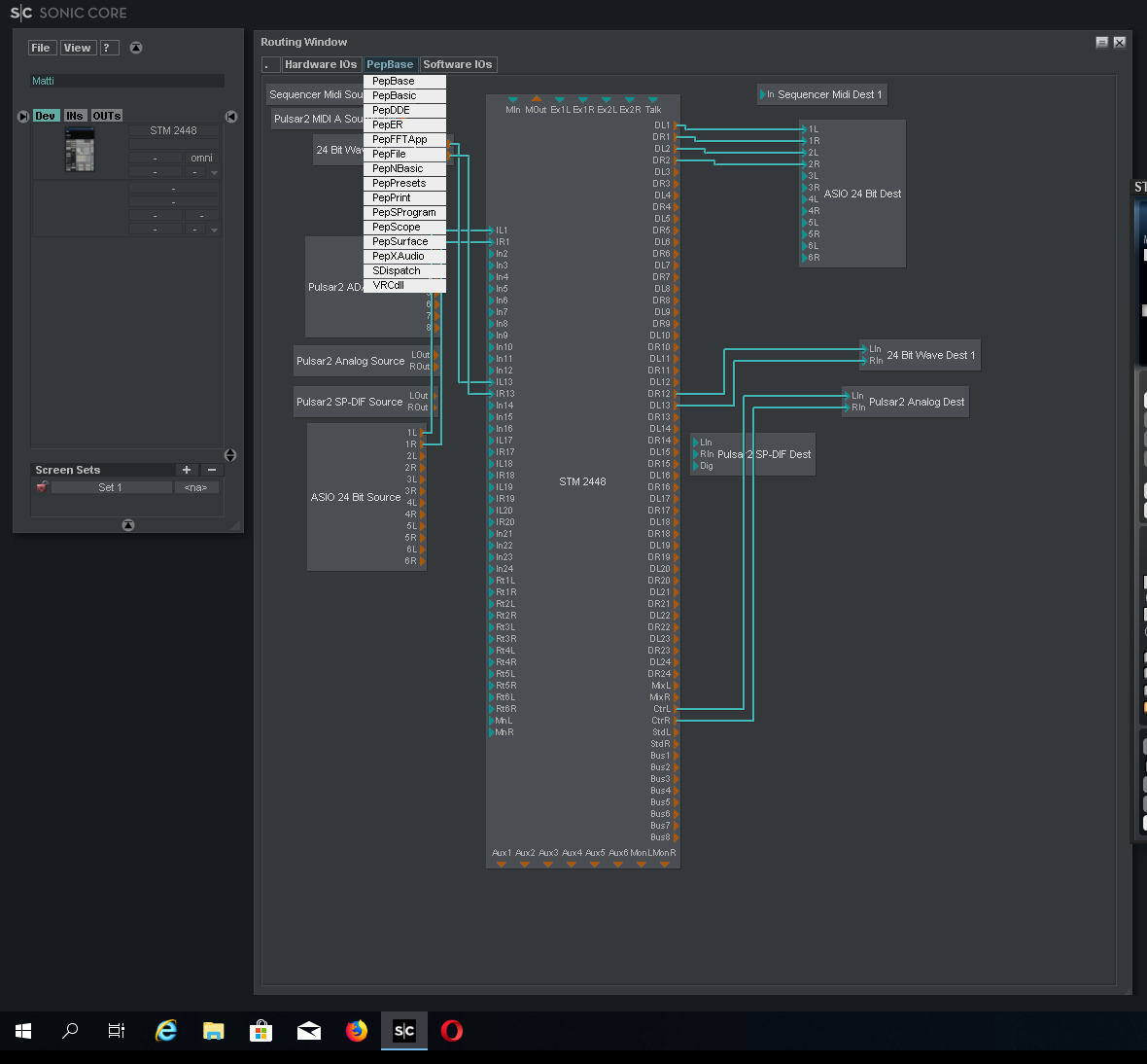

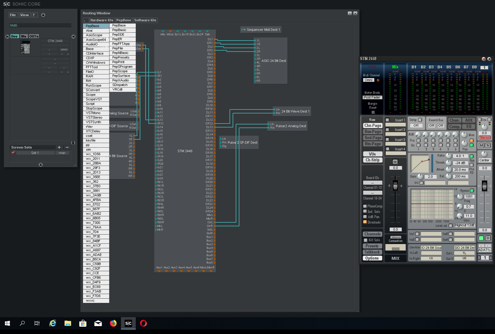

Hi, I wondering where is the many missing presets or can´t open etc. in my SCOPE 7?
See the Attachement below. Earlier SCOPEv5.1 those files etc. make open by clicking.
The install V7 goes well and nothing failure happend.
-Matti

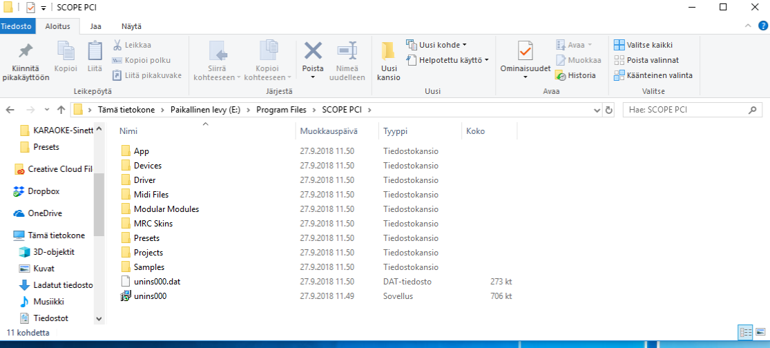

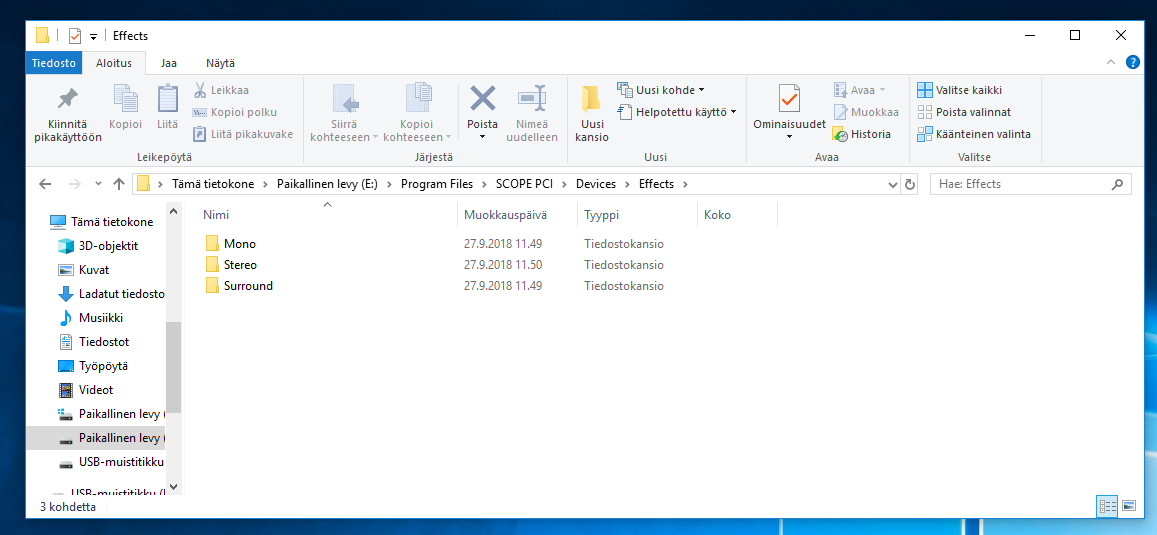

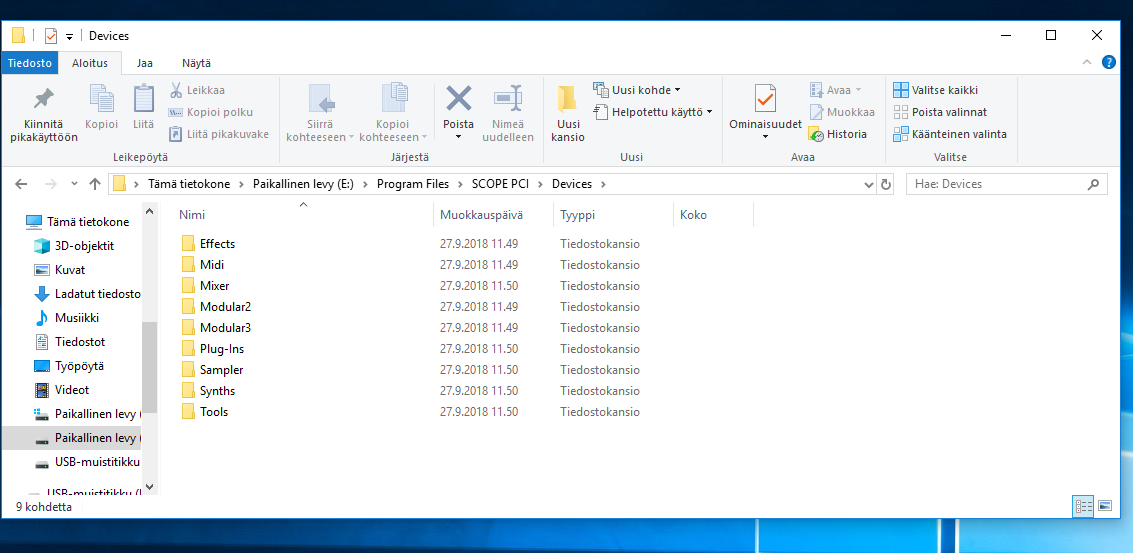

Hi, I´m now reinstalled SCOPE V7, but the problem is same. I´m installed all in E:
I sent you tree pictures as attachement ( see below SOPE 5, SCOPE and SCOPE 7).
Must I too delete device etc. all them before reinstall? Seems that the reinstall have not effect this
SCOPE 5.png (119.15 KiB) Viewed 6198 times
SCOPE 6.png (100.9 KiB) Viewed 6198 times
SCOPE 7.png (80.08 KiB) Viewed 6198 times

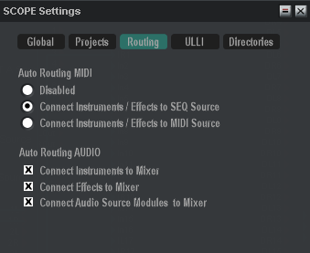

Hi, I found some settings (see attachement SCOPE 8 below), but seems that is correct. Is the another settings?
SCOPE 8.png (24.39 KiB) Viewed 6175 times
Ripper
Posts: 230
Re: Missing Presets etc.
Post by Ripper »
Two Menus to the right: Directories
