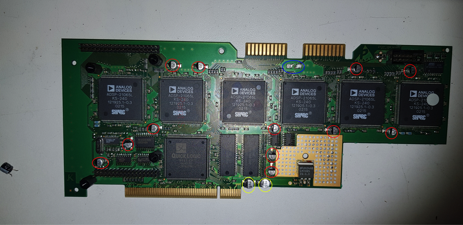

hewlet
Posts: 40
Joined: Thu Jul 08, 2010 11:38 am
Re: Pulsar wont wok
Post by hewlet »
Capacitators marked with red is 47uF 6.3v
The two caps marked yellow are 47uf 16v
The blue mark is cleaned solder pads without a 47uF 6.3v.
I have ordred parts from Elfa, and i have to double check if the dimension is correct.
I can upload a video of how i recap the board next week :)
The I/O plate also ned recap, but i will check that later.
Pulsar pcb recap 2.jpg (1.53 MiB) Viewed 17972 times
sandrob
Posts: 1122
Joined: Fri Sep 28, 2001 4:00 pm
Location: Slavonski Brod - Croatia
Re: Pulsar wont wok
Post by sandrob »
hewlet wrote: Thu Oct 11, 2018 11:49 am Capacitators marked with red is 47uF 6.3v
Thank you!!! :)
