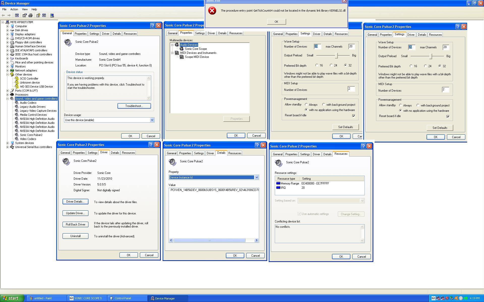

Re: Pulsar -2 (6 SHARC PCI 32/33 ) w/ second Pulsar in tandem for 24 -32 Chanels of ADAT currently; v 3.1 (a,b & c) on X
Please see attached to indicate what is going on;
- Planet Z Device Manager.JPG (312.18 KiB) Viewed 10558 times

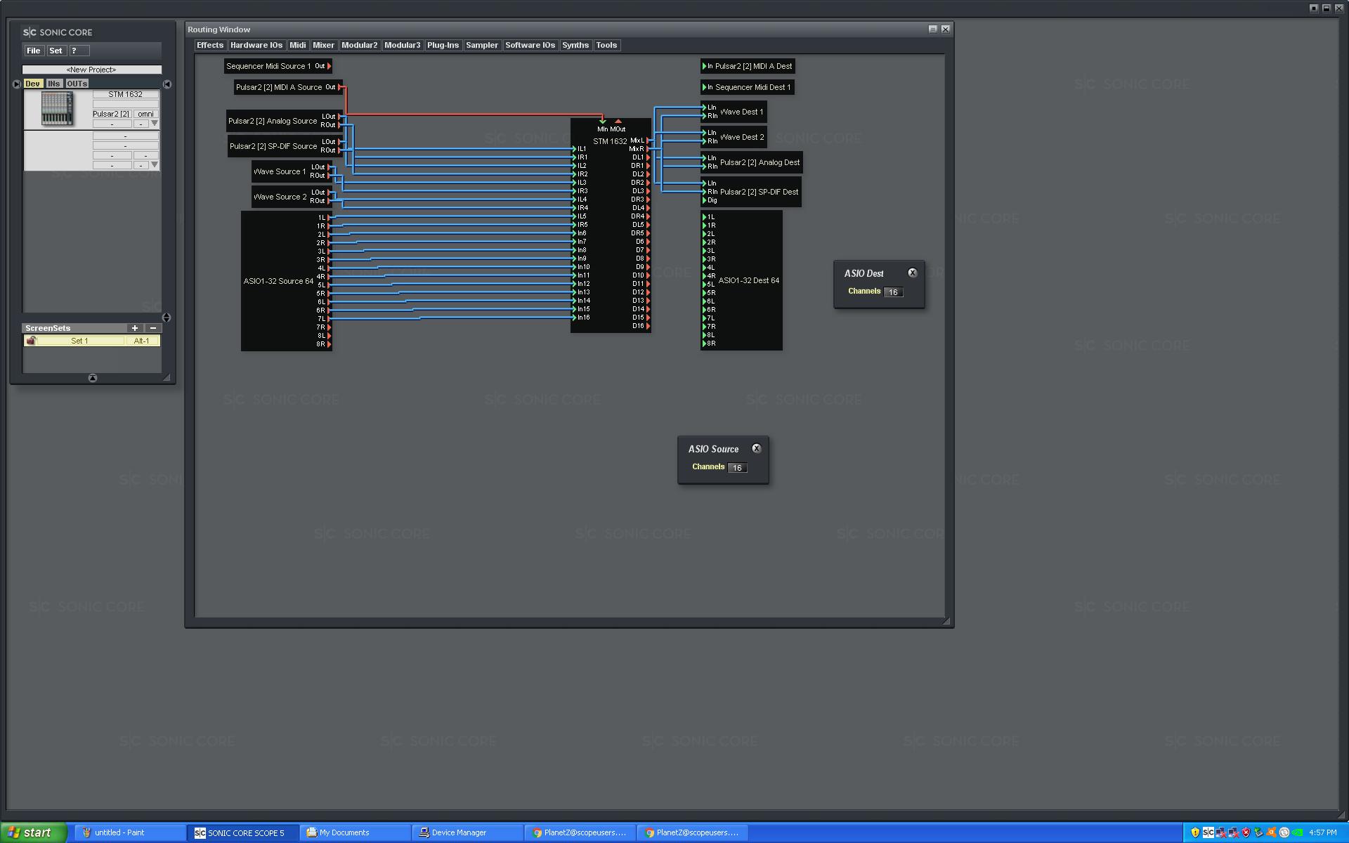

Pleas see attached SCOPE Project
- Pulsar 5.1 #2.JPG (152.05 KiB) Viewed 10555 times

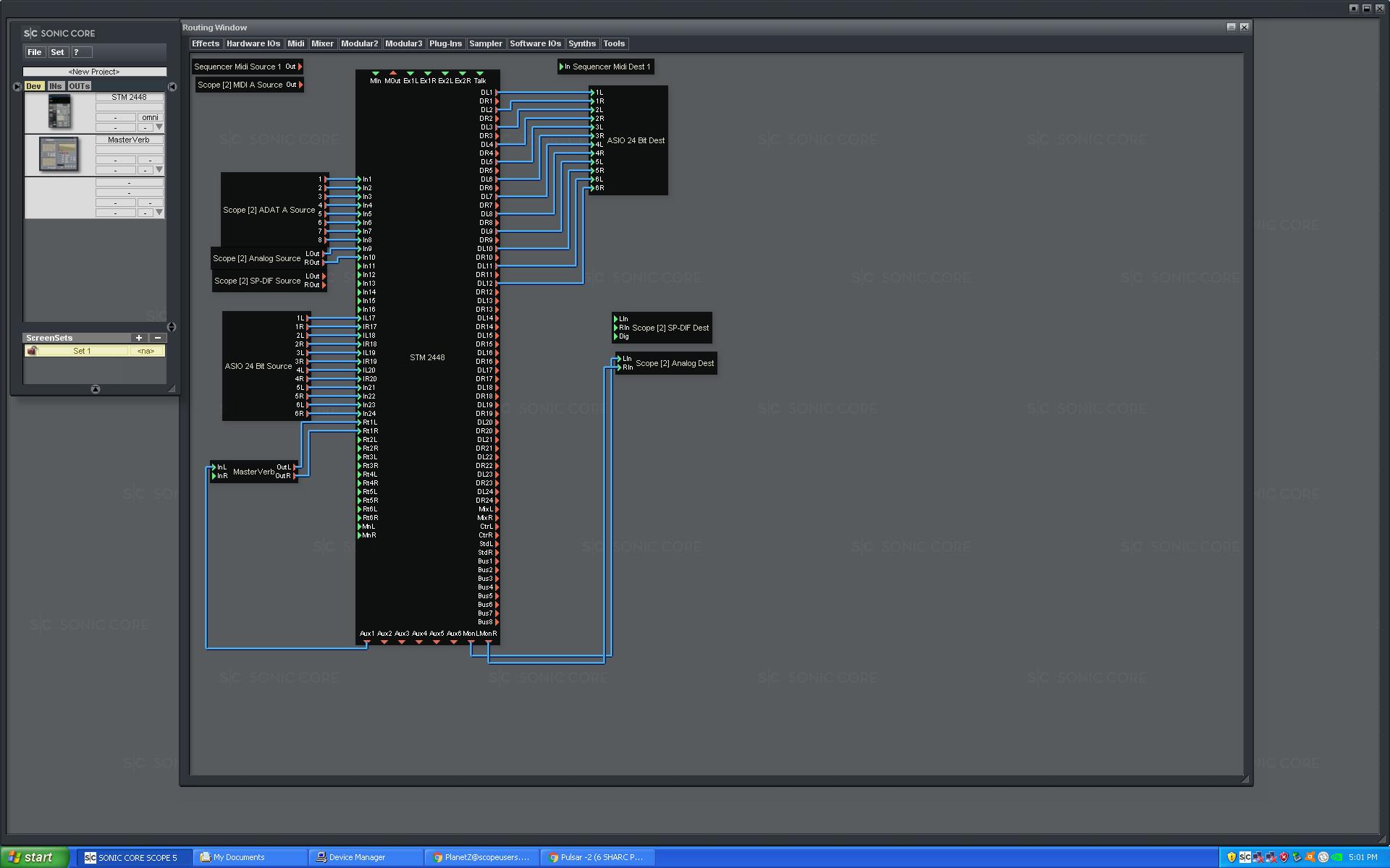

Any of these ought to work ... right ... ??
- Pulsar 5.1 #3.JPG (155.63 KiB) Viewed 10554 times
The latest above is a Factory Preset

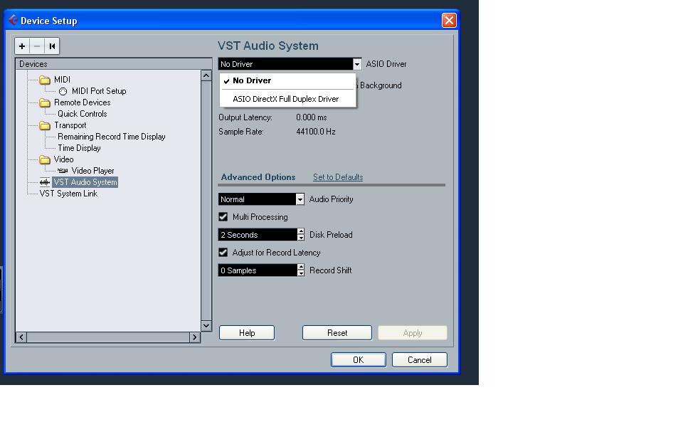

Cubase Device Setup No Driver
- Cubase Device Setup No Driver.JPG (55.6 KiB) Viewed 10554 times
