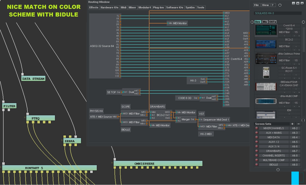

Re: Scope 7 Windows 10
Ankyu.
Everything went smooth as silk.
Only one bug I found so far, no Routing Window view that can be clicked off and on as a screenset.
No problemo, settings/routing window.
Looks nice loads quicker it seems.
Nice work Holger and others.
