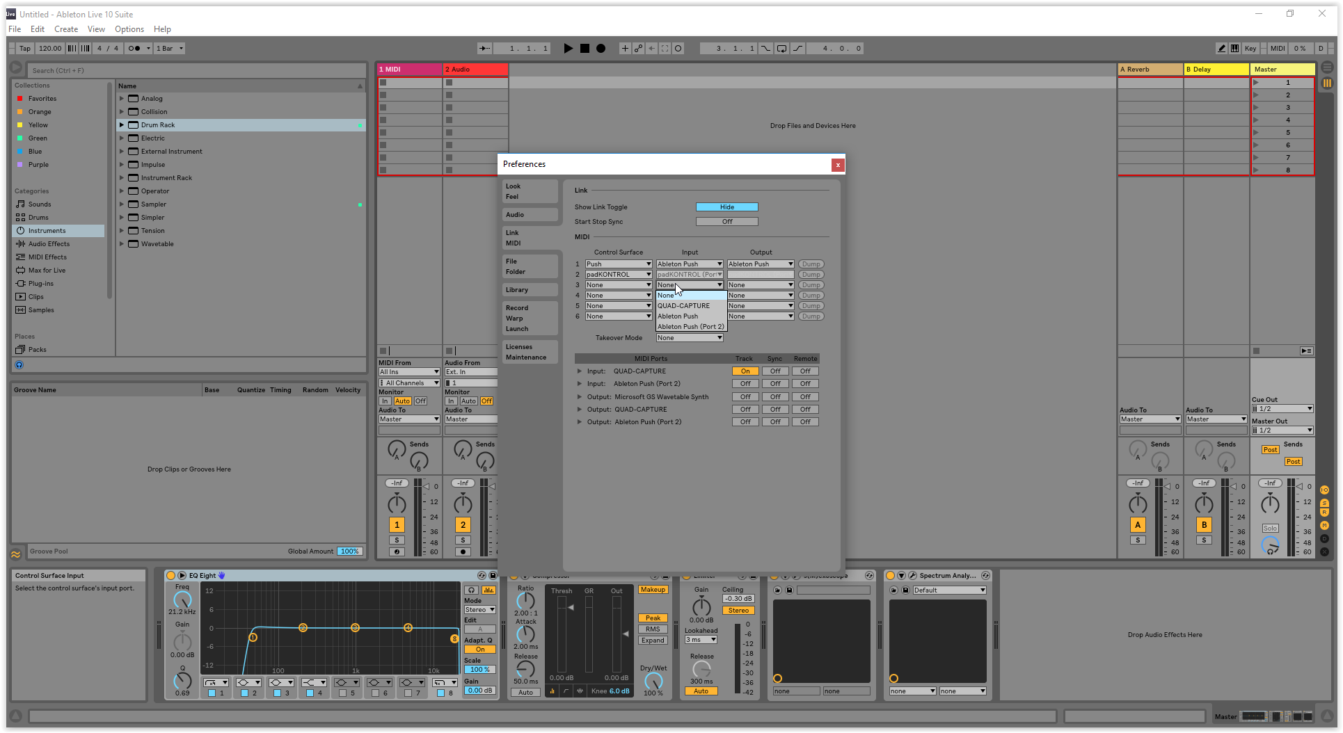

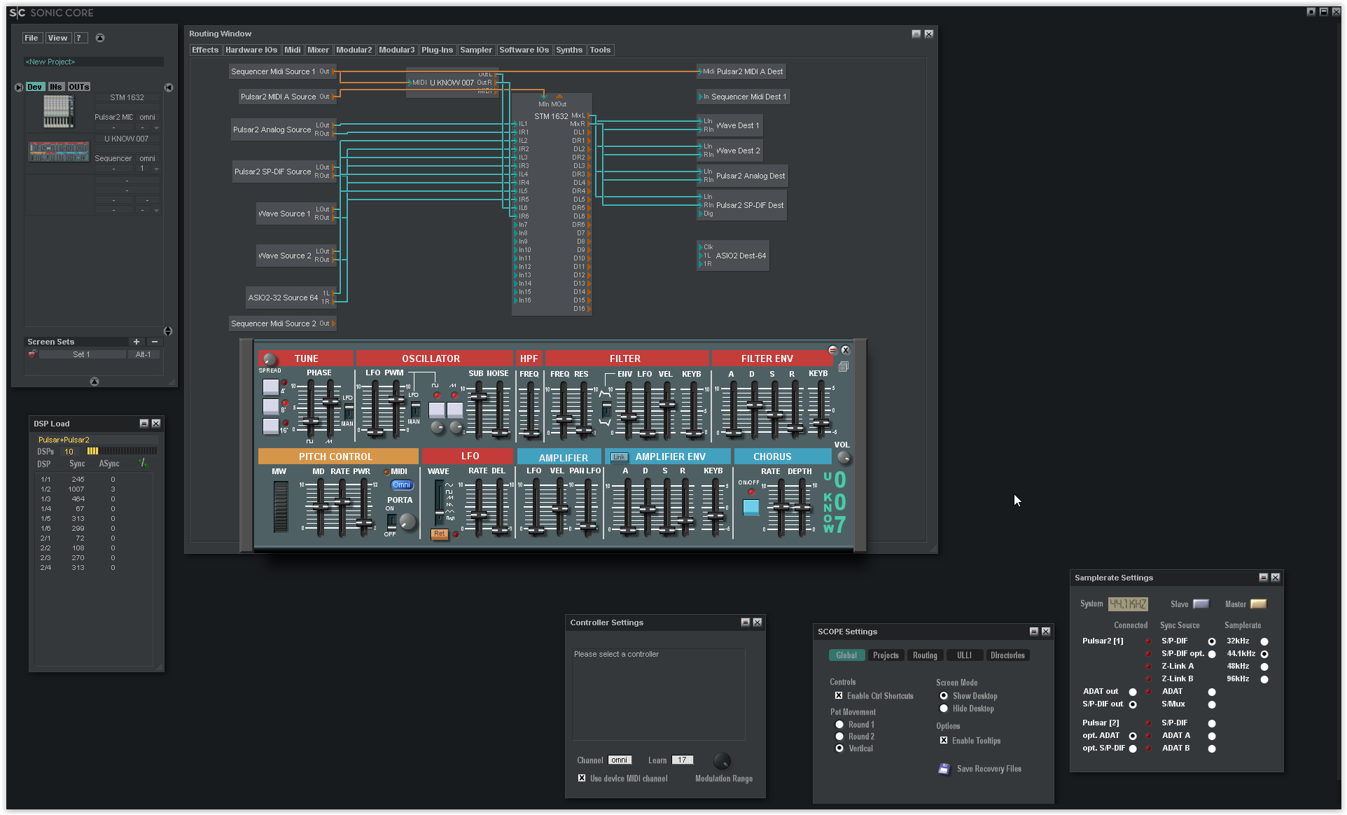

What i do is this; in Live, make sure midi is set up correctly. Below is a picture of my setup.
In Scope, Midi will output through "Sequencer MIDI Source". Hook up this module to what ever you want to control. If you want to send to hardware, hook it up to "Pulsar MIDI dest" or what ever it is called on your system :)

Re: MIDI from DAW to Sequencer Out
no, you need to make sure there is a sequencer midi source and destination in your Scope project before you open the sequencer. you must close the sequencer if you change the sequencer midi modules, or if you change the type of ASIO i/o, or the number of ASIO i/o. once those things are in place, you can open the sequencer. you can connect to or disconnect from those modules as you please, but to change them you need to shut the sequencer down.

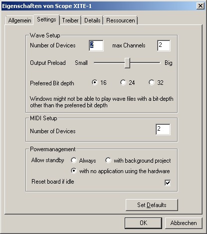

As you enjoy getting answers as a screenshot, let me add these pictures.
( sorry, couldn't resist :D )

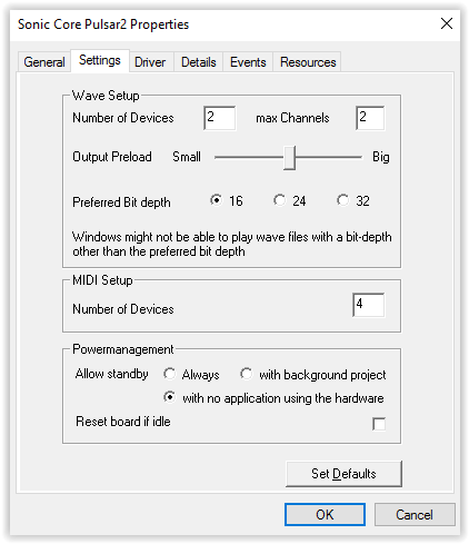

uncheck "reset board if idle".
this prevents the computer from deciding that you aren't using the card and disconnecting power from it(which leads to "copy protection" errors that can't be fixed except by rebooting.

I don't know if I'm doing something wrong, but I still don't see the scope midi in Ableton. I'm running the Scope software as Admin and also tried that with Ableton. I'm running Windows 10 64 bit if that matters.
My settings as screenshots
