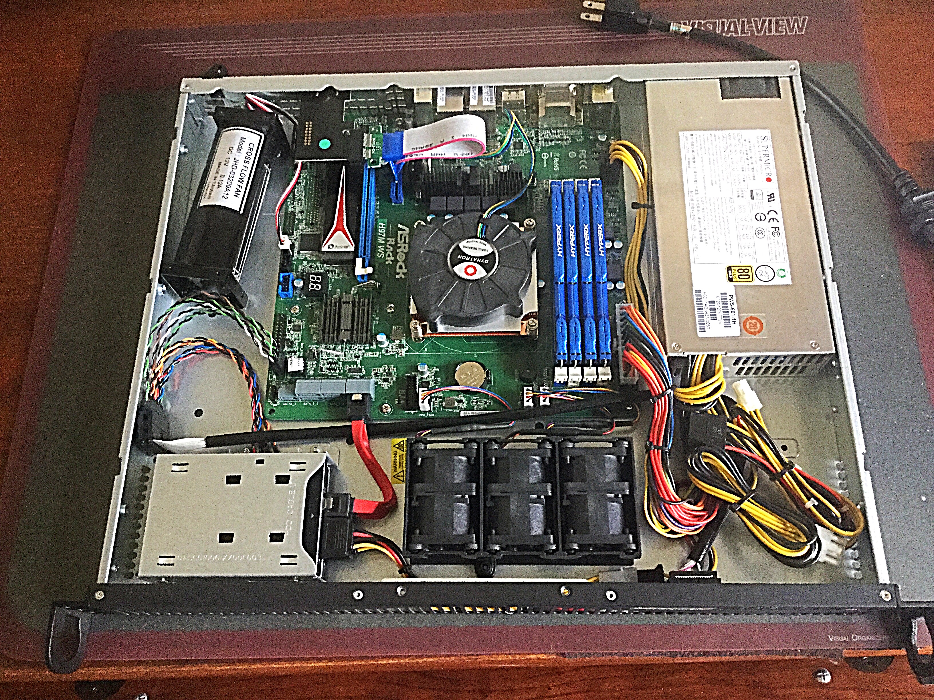

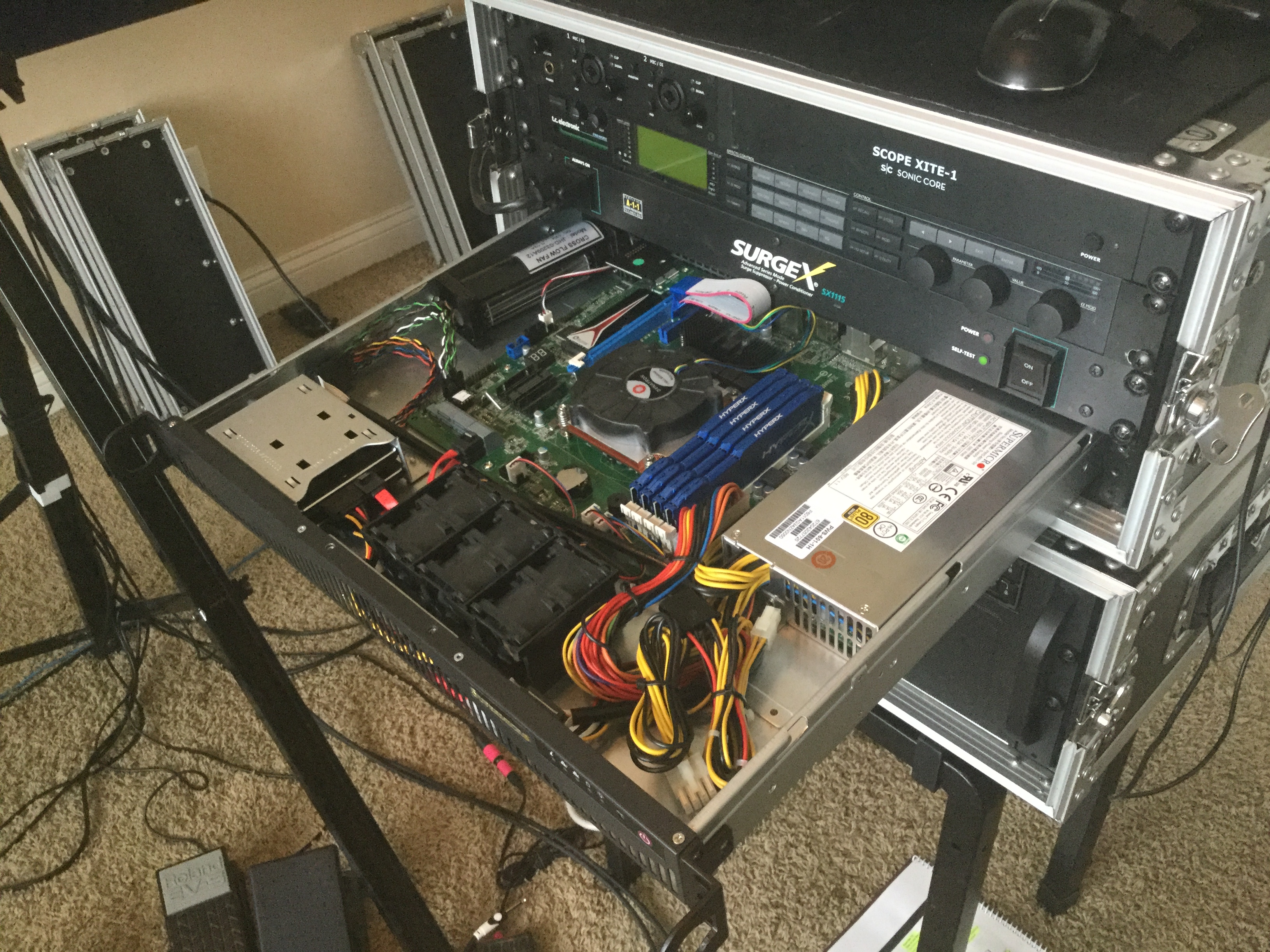

I use a cross blower Dynatron Fan to cool my NMVe (upper left) but this is more for show as hardware monitoring app seems to report 3-4 degree differences. I thought I’d give it a try though. Looks all scientific & shit too.....

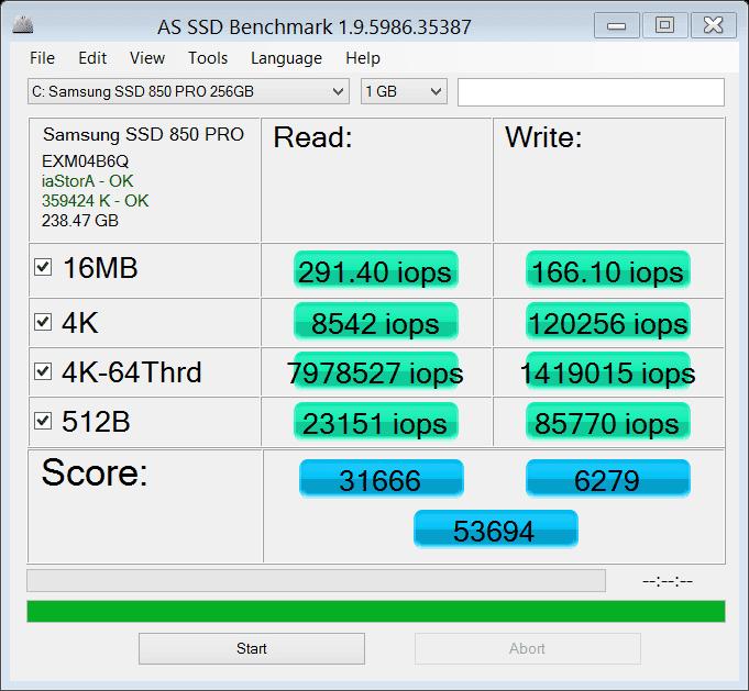

The card style NVMe devices from Intel and others have adequate cooling but I had some Intel 400Gs and while you don’t really notice the dissipation of bandwidth in our apps, AS-SSD and other benchmarks show the results after 15-20 minutes.
Best performance I’ve seen are the Samsung Pro 850 SSDs.
10 year warranty, in house controllers made, even have better drivers and caching software. The Magician software benchmarks but also caches RAM which seems to benefit audio apps.
Here’s an unrealistic benchmark basically off the charts because Z/H 97 chipsets take data directly to the CPU instead of the PCH.
These are very fast SSDs so if you get EVOs, they are also fast but lack the Samsung Pro 10 year warranty.
I wish my devices ran as quick as the Benchmarks say.
- Marco
- Posts: 1260
- Joined: Thu Oct 10, 2013 4:27 pm
- Location: Ödenwald
Re: Is it worth to use a pcie Adapter to connect a M2 ssd?
Very hot PC DAW man! I like it very much!
