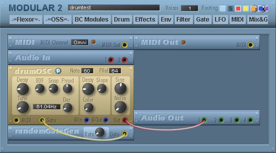

Re: Creamware scope modular mentioned on Sonicstate live feed
I cannot answer for Scope 7, I am still on v5.1. I will probably update once they make proper ASIO and Wave drivers for windows 10 64 bit. And I am on PCI cards.Bud Weiser wrote: Sat Feb 24, 2018 6:12 pmWhat exactly is wrong w/ Modular IV when using SCOPE 7 ?
Please explain what´s wrong EVEN in 32Bit and what´s wrong ONLY in 64Bit.
So I cannot say much about v7 compatibility, but I'll name a couple of examples I'd like to see fixed (64bit OS).
- The modular shell itself. See the picture below. Recreate this simple patch in a modular 4 shell. Save it, close it and load it up again. It doesn't produce sound. In a modular 2 shell it works fine upon reload. - Tape Echo modules will cause BSOD upon use in 64 bit systems. This has been fixed years ago, but the fix has never been publically released.
Of course there are more stuff, like sample related modules etc, but I am not going to dwelve more on it here.
O.k., I see ...next to nothing wrote: Sun Feb 25, 2018 3:55 am
