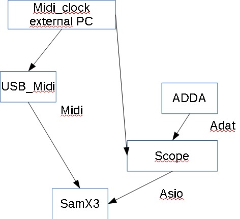

I also contacted magix, but I received no reply to my bugreport yet.
Find attached the description of my setup.
SamX3 just uses the external Midi-USB-Cable ( like Midimate) and the scope setup runs as shown in the background.
Everything works.
Now I connect one of the midi dest on the right. Now SamX3 looses asio buffers.
Either samX3 cares about midi-interfaces it shouldn do or scope does some strange coupling between midi and asio.
Do you run a similar setup ?

That's weird. One should not have anything to do with the other. Did you try using Midimate on the Seq MIDI Dest as well as the Seq MIDI Source? I don't know why connecting to the Pulsar MIDI would have any effect on ASIO.I'm thinking that Sam wouldn't try to query Midimate, or if it did, it woudn't find any ASIO stuff in that driver to mangle. Bridging all the Scope MIDI ports through Midimate would usually stop that.
