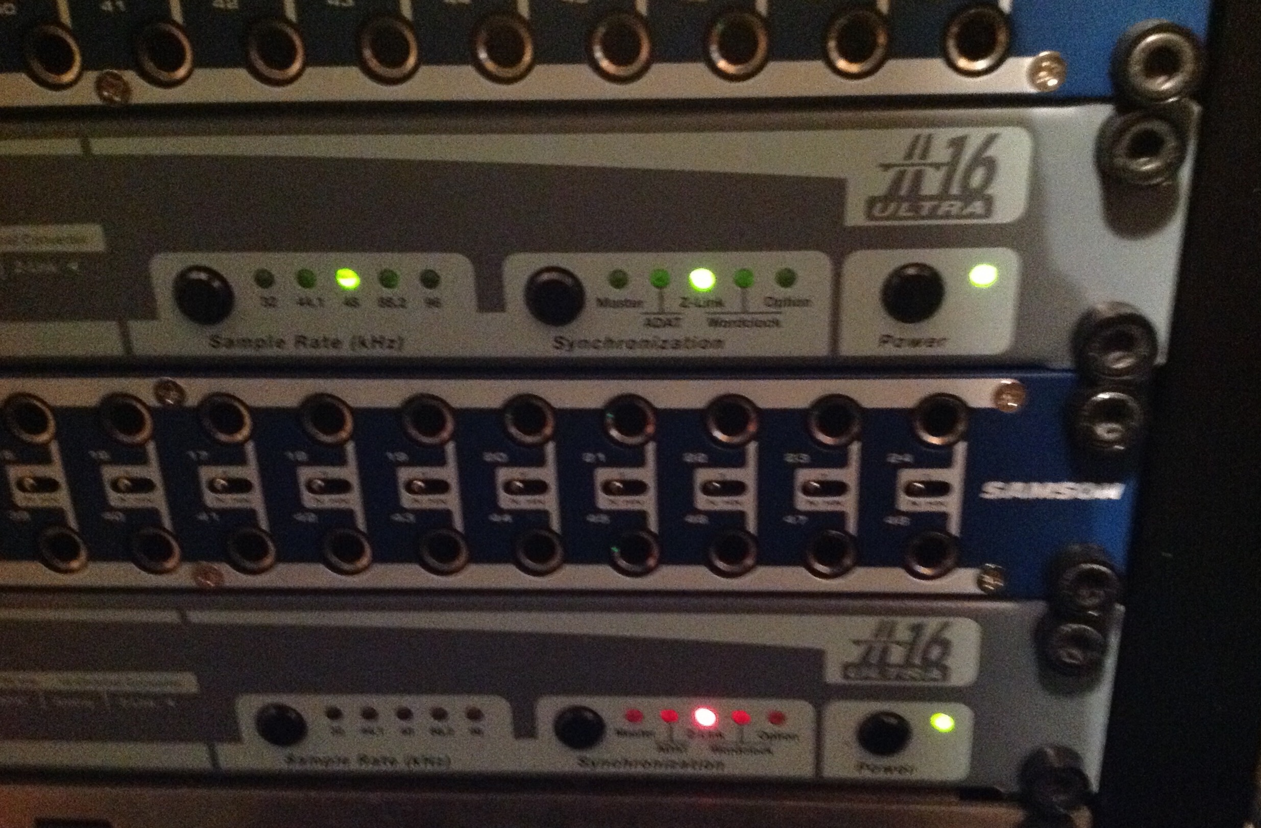

Yes, sorry I might have over complicated things by mentioning the z-link synchronization light. Petal explained it correctly, so I thought I would add a couple of pics to show you what happens.
When I turn on my DAW, and then press the power button on the A16U this is what the lights look like. The top unit powers up and all lights go green immediately, but the bottom A16 U needs a short while to "warm up" before it can be used.
On my unit it is only around 30 seconds now, but for years it would take 5-15 mins, same as Petal. Strange that mine warms up quicker now, as I haven't changed anything. But maybe just using it more often.

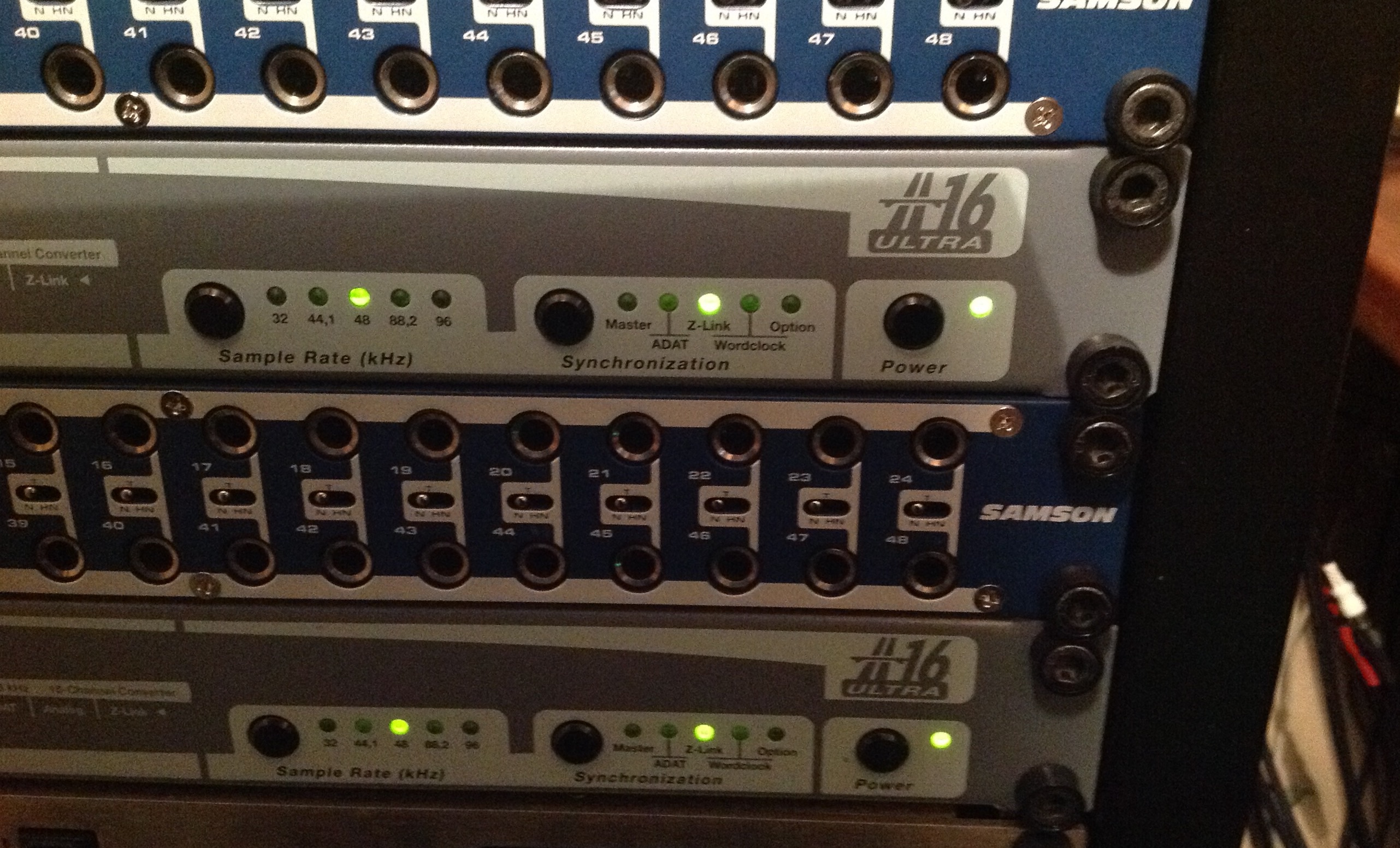

Approx 30 seconds later all lights have gone green and I can now use the bottom unit as well
