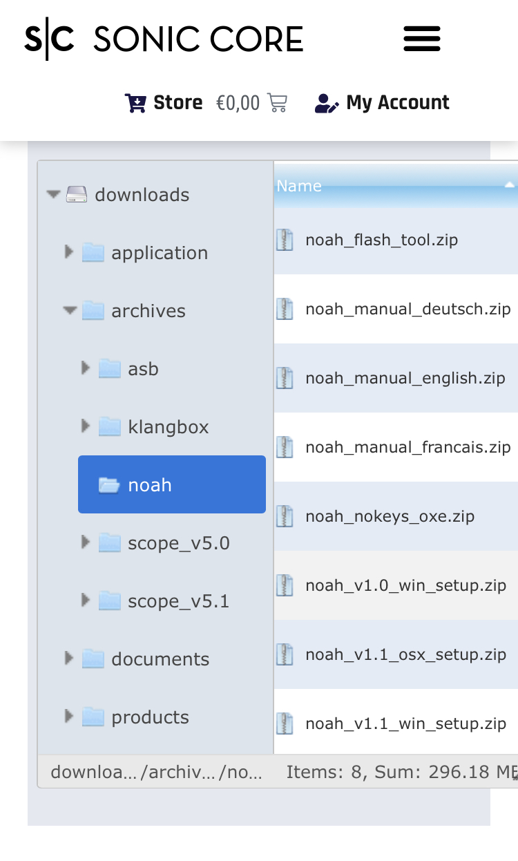

sunmachine
Posts: 576
Re: How to unblock your Noah?
Post by sunmachine »
Ah yes, I didn’t check the SC download archive.
So they have the following files here: https://sonic-core.de/downloads/#elf_l1 ... ZXMvbm9haA
Posts: 2929
That´s it and it seems to be complete.
The Noah Profit5 additionals are in the Noah nokeys oxe folder.
