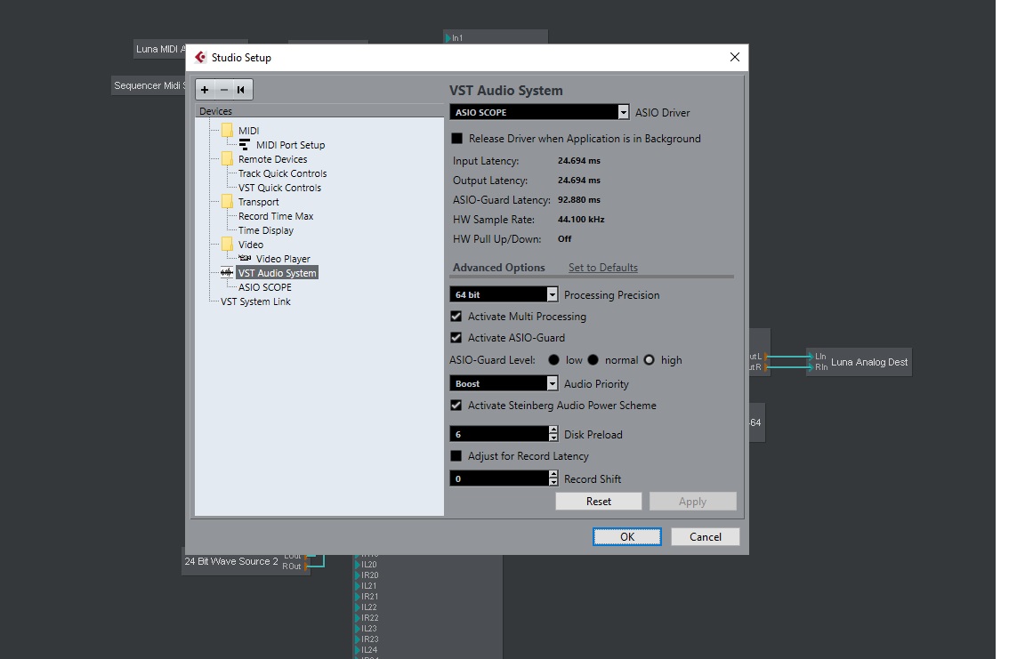

I can get best results with those settings in Cubase Artist 9.5 & Elements 9(picture).
Also you can try, it can't hurt :) while recording to set lower priority to scope.exe.
Task Manager - details - right click to scope.exe and set priority to "below normal".
