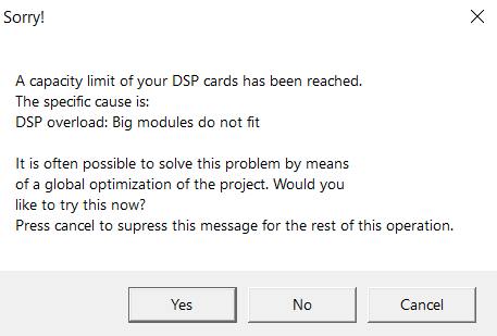

After I boot my computer and start the Scope software I get the following (not all the time)

if it's not a random error (some condition triggered the wrong number), this usually pops up with certain 'long delay dsp modules' (residing in the dsp folder), obviously related with specific hardware releases.
I've had it with both 6 and 15 DSP cards and some reverbs (iirc) and could never make a clue out of it.
(the plugins were 'compatible' and others with a similiar setup had no problems running them)
You may check for reverb/delay effects in your startup project - if there are none it's probably an erroneous message.
(I guess it locks you in a loop and you have to restart Scope )
Re: Boot up
does it start after hitting "yes"?
if so, it's the startup project. it's not a big deal, if it starts.
