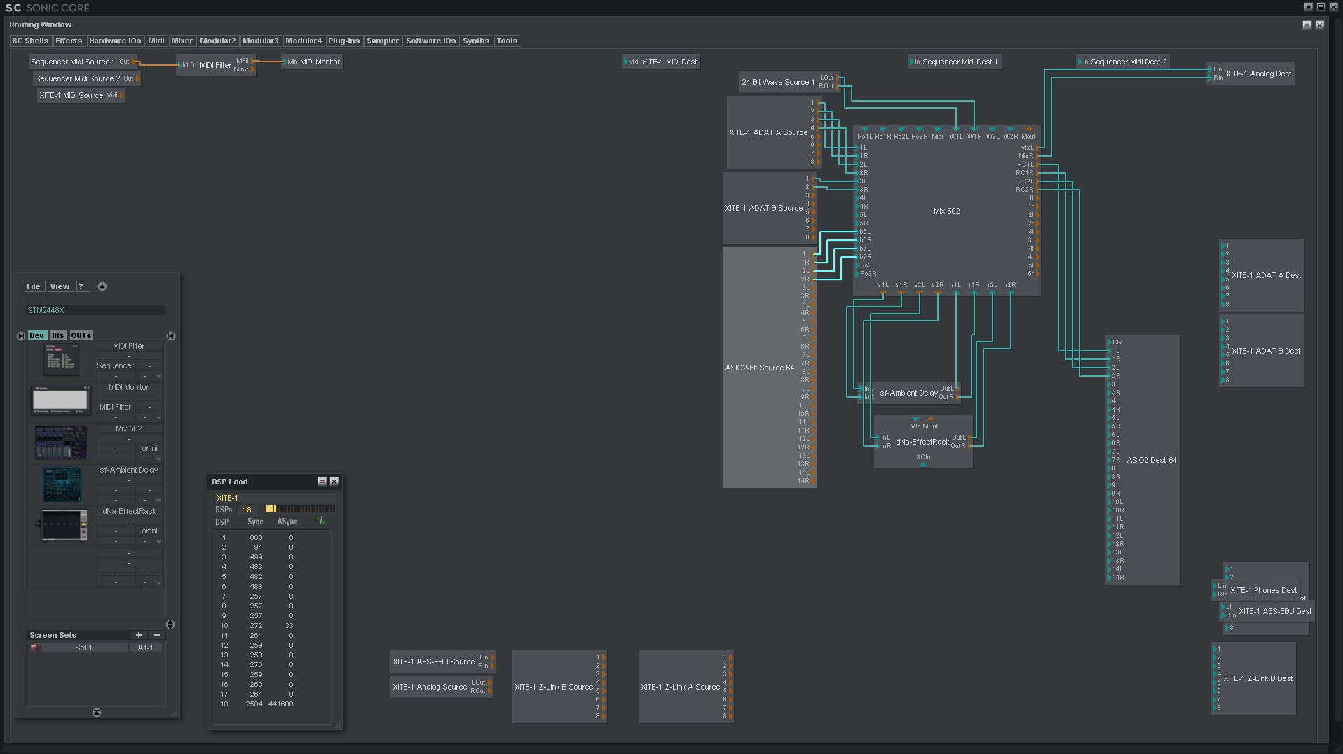

Greetings Medhi. I have been exploring the Modular Mixer for a short time trying to incorporate it's unique abilities into my setup.
What I am trying to do: Minimize DSP usage on my startup project and maximize flexibility for effects routing.
This has been a slow process but i am slowly starting to learn what each module is intended for.
My setup is fairly simple with really only 3 stereo ADAT inputs used at a time mostly.
Some thoughts and obsevations:
-I probably will still use the STM2448 mixer simply because it seems to be "free" that is, there seems to be no cost of DSP's, at least that is what is showing on my DSP load. (I use the Scope synths a lot and try to leave as much resources free for those)
-So what I am trying to do with the Modular Mixer is use these modules for AUX effects by loading the effects on the main project window for DSP efficiency. (Not sure if I'm crazy but the effects seem to sound better in the project window rather than an insert and I've even taken steps to try and make sure it is not just a blend or level setting that is the difference.....hmm)
Any thoughts, suggestions, tips would be greatly appreciated from anyone.
thanks
Dan

Posts: 1711
Re: Greetings!
Well I would much rather use your mixers than the STM. It is an amazing group of mixers providing almost unlimited flexibility!!!
And I must congradulate you on that monumental feat.
What I am trying to do is replace the STM2448 mixer with only using your devices (and here's the caveat) with a minimal DSP load for my startup.
As you can see from my first pic I am only utilizing a few inputs into the STM2448 and I use maybe 2 or 3 more with Scope synths and usually only 1 ASIO from the DAW. I'm thinking I might just be able to go directly into the MB503FX? Will have to see how it works out.

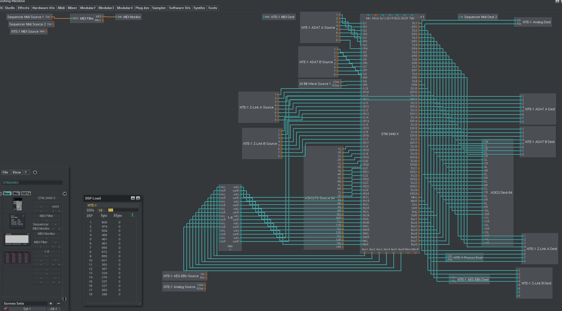

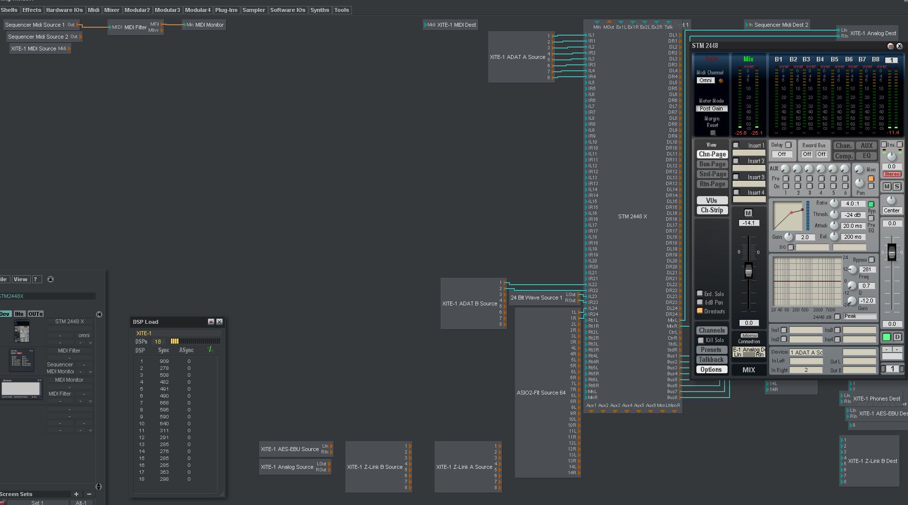

As far as the STM2448 DSP load; The first PIC I have loaded my usual startup and all of the DSP's show minimal usage.
The second PIC I loaded and connected , well just about anything and everything I could think of and it seems like there is really no change in DSP usage which also matches how I have perceived the performance on the Xite when loading high polyphony on synths and delays, reverbs etc.
This is in no way critical to you or even remotely a complaint. I point this out simply because I am curious to know how this is possible since it appears no other developer on Scope can produce a mixer or router with this kind of DSP efficiency?
