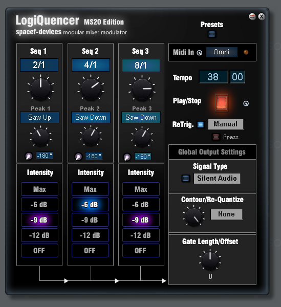

This one is for later...
Works great with MS20 and OS20 (as well as any synth with external trigger and volume modulators).
You connect it to trigger inputs and to modulation (for "accent" variation).
As good or better than a step sequencer for gating because what each parameter does can really be surprising and unexpected.
super light in DSP resources, solid timing.
It doesn't manage Picth (at least, not in the MS20 version that is pictured, the MS20 only accepts CV for Pitch (the one from the ESP is quite unuseable).
NB: to use with CV based triggers, you would need a Audio to CV converter such as Expert Sleepers ES 3 "Adat to CV" converter (I don't have one).
But you keep access to the synth keyboard, so you can change notes on the fly, and it will remain synced (no need to play in perfect time to trigger sequences; they will remain perfectly in time).... which is a rather big concern with most step sequencers currently used in synths/vsti, as a few ms inprecision in your playing will kill your groove and make you sound like the lousiest band ever). Logiquencer is based on LBH sequencers which also have this feature.
