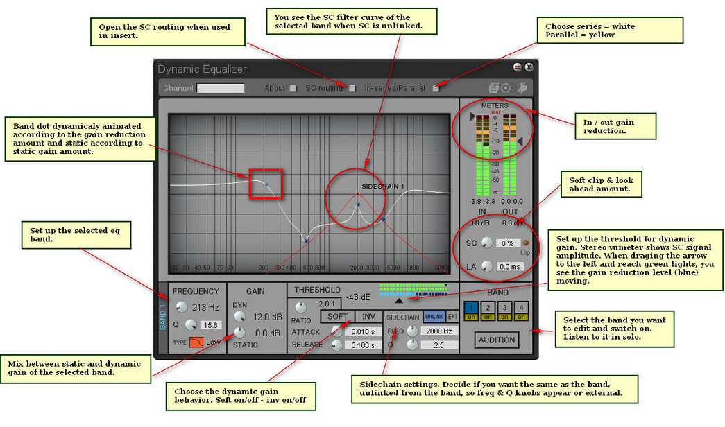

He studied the TC dynamic eq manual and after one month, he send me the first version. After some discussion, we improved it to finally have a very fast, precise dynamic eq. And the GUI looks like the TC one !
SO !
With this fantastic TrrRRremendous dynamic eq, you can separate (unlink) the SC signal from the eq band to modulate its gain. You can add static and dynamic gain to each of the 4 bands, or a mix of both.
If you add positive dynamic gain, the gain will rise, modulated by the SC amplitude signal. With negative gain, you'll lower the eq band gain.
Each of the 4 bands have parametric / high shelve / low shelve filter choice.
You can use external SC source signal for each of the 4 bands even used as insert.
A « soft » button to make modulation transitions more sweet.
A « inv » button to reverse the dynamic equalisation : the dynamic gain is applyed when the SC signal goes above the threshold.
Comprehensive vumeters showing the SC signal amplitude and the gain reduction.
A look ahead knob.
A softclip knob.
Choice between parallel and series for the 4 bands (in series = 1 → 2 → 3 → 4)
You can listen to the SC signal on each band.
The latency between SC signal and gain modulating is 7ms at 44.1khz, and always the same !
The result is really absolutely AWESOME ! And I really think this device was missing on our Scope arsenal.
CHEERS !
To get it, just contact John ! He asks for 150€ to have it and believe me, it's worth it !! The work he had to develope the dynamic eq is really worth 150€ !
!! ONLY FOR XITE !! (didn't try on PCI........)
And you can contact him if you have, like me, a device idea !
John.... If you want to add something....

Re: Excellent Scope Dynamic Eq !
It is, indeed ! There is no such device on Scope yet.
I show tou the device in the project window :
And the side chain routing window opened to route side chain when used in insert :
This device is AMAZING !
Thanks to its dynamic or/and static gain mix, the inverse feature and its unlinkable sidechain filters, you can do what none of Scope device is able to do !
For example, in a wave file, a part has too much high frequency distorsion, unpleasant to hear. By setting a band on the frequency I want to erease, negative dynamic gain SC linked and a second band on exactly the same frequency, 'inv' switched on, negative dynamic gain and side chain unlinked with its frequency on mid-low, enough Q, the device ereases bad 1290hz distorted noise only on parts without mid-low frequencies and leave it when mid-low frequencies are present !
This is stunning ! I can achieve exactly results I'm looking for and in a fast way (without having to build a modular processor which takes me 1 or 2 days in order to get the result I want) ! Really awesome !
I'm using it on my mastering chain too, with excellent result. It's like a much more elaborate deesser which works on any frequency. I can't believe I had a so good idea ! Ok... :D The main idea comes from TC Electronic but we added very good and unique new features !
