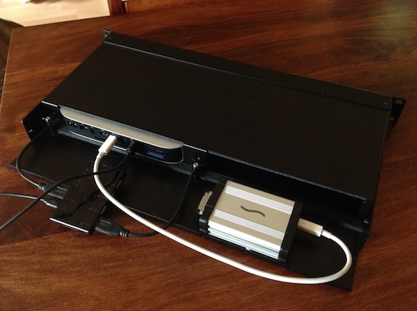

as to a 1 space solution, you would need to make one. that could be really cheap if you only wanted to run the XITE. heck, you can get a Core2 Duo HP XW4400 PC for less than $100 on ebay, if the whole thing was going to sit on or near your desktop. that PC could run the XITE and then you're set. otherwise, i cheap motherboard/processor, some ram, an ssd(for super quick boot times < than 90 seconds) and a 1 space case with a riser cable are all that you need. actually, a 3 or 4 space rack computer would be even cheaper to make, and quieter, since the bigger fans can run slower.
sunmachine
Posts: 580
Re: Xite upgrade idea for portable
Post by sunmachine »
Another idea for a one space solution with zero noise is to get a (used) MacMini and to put it in a Sonnett RackMac Mini for example.
Like so: http://www.hitfoundry.com/issue_26/mac_mast.htm
