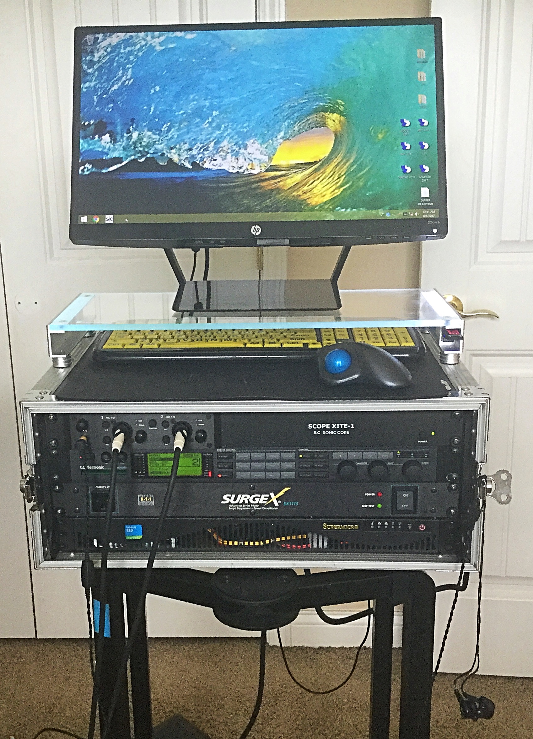

Really like my recent build.
Testing shows great cooling capability and high benchmark scores
for SSDs and NVMe M.2s using newer Windows 7 NVMe drivers.
Supermicro CSE 512f-600B 1U ATX Chassis
ASRock H97m WS
Intel i7 4790k
32GBs of DDR3-1600 RAM
Plextor 256GB NVMe M.2
2 x Samsung 850 Pro SSD
Triple 22,000rpm intake fans
Dynatron Cross Blower Exhaust
Dynatron 1U HSF
Icemodz Custom Cut Sleeved SATA cables
Parts have been warehoused and are cheap.
250 for the i7
Motherboard with Humidity protection PCB 120 bucks
Samsung 850 Pro 1TB SSD was the most expensive part.
Plextor NVMe is PCI-e 2X speed also cheap (738 MBps Seq. Read)

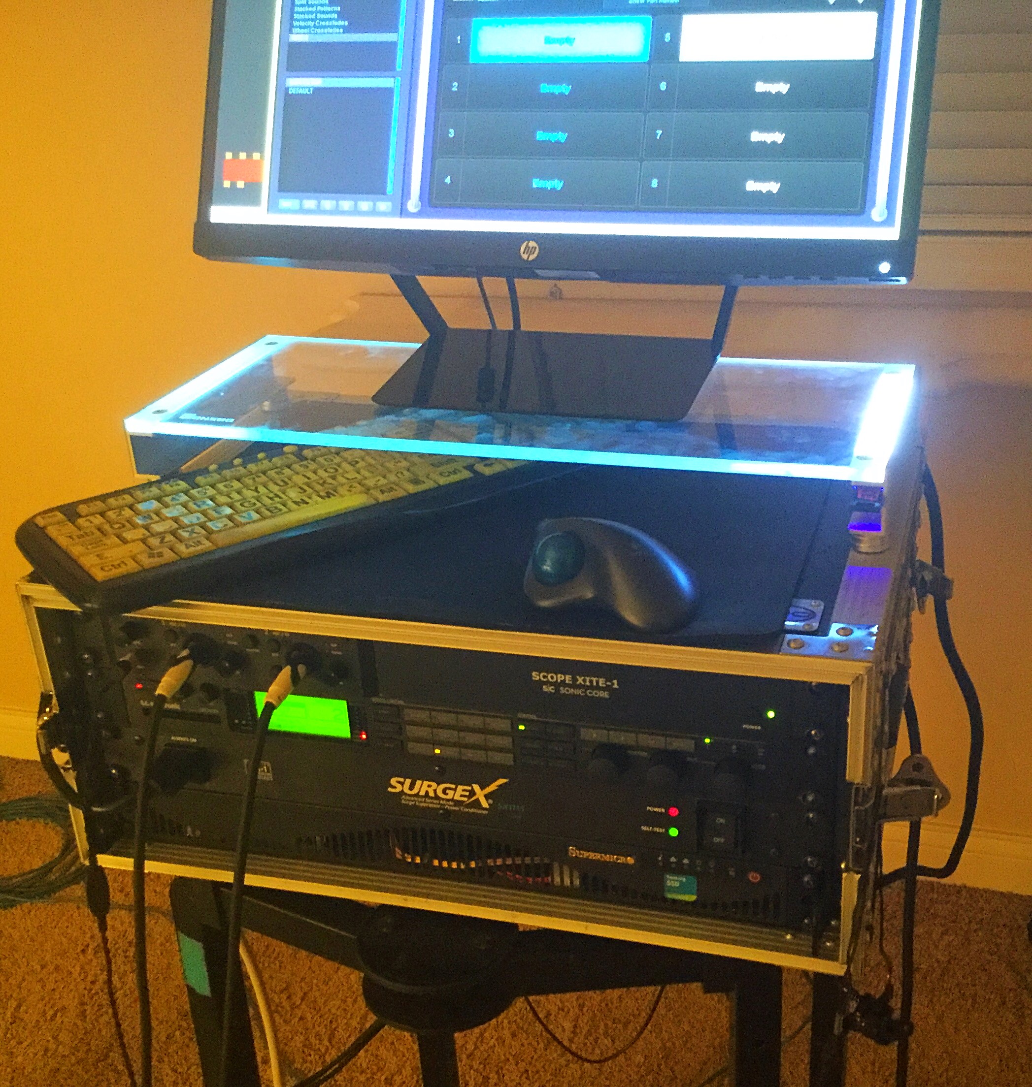

Tested and benched for 29 hours using a bench pushing 100% CPU.
Then RAM.
Then SSDs.....
Perfection, as long as you're not offended by the sound of 22,000rpm fans.
Smallest, most powerful rig to date.
Runs UVI, Kontakt, PLAY, PianoTeq, Zebra2 HZ, Omnisphere and Keyscape.
It's so tiny and powerful.... :)

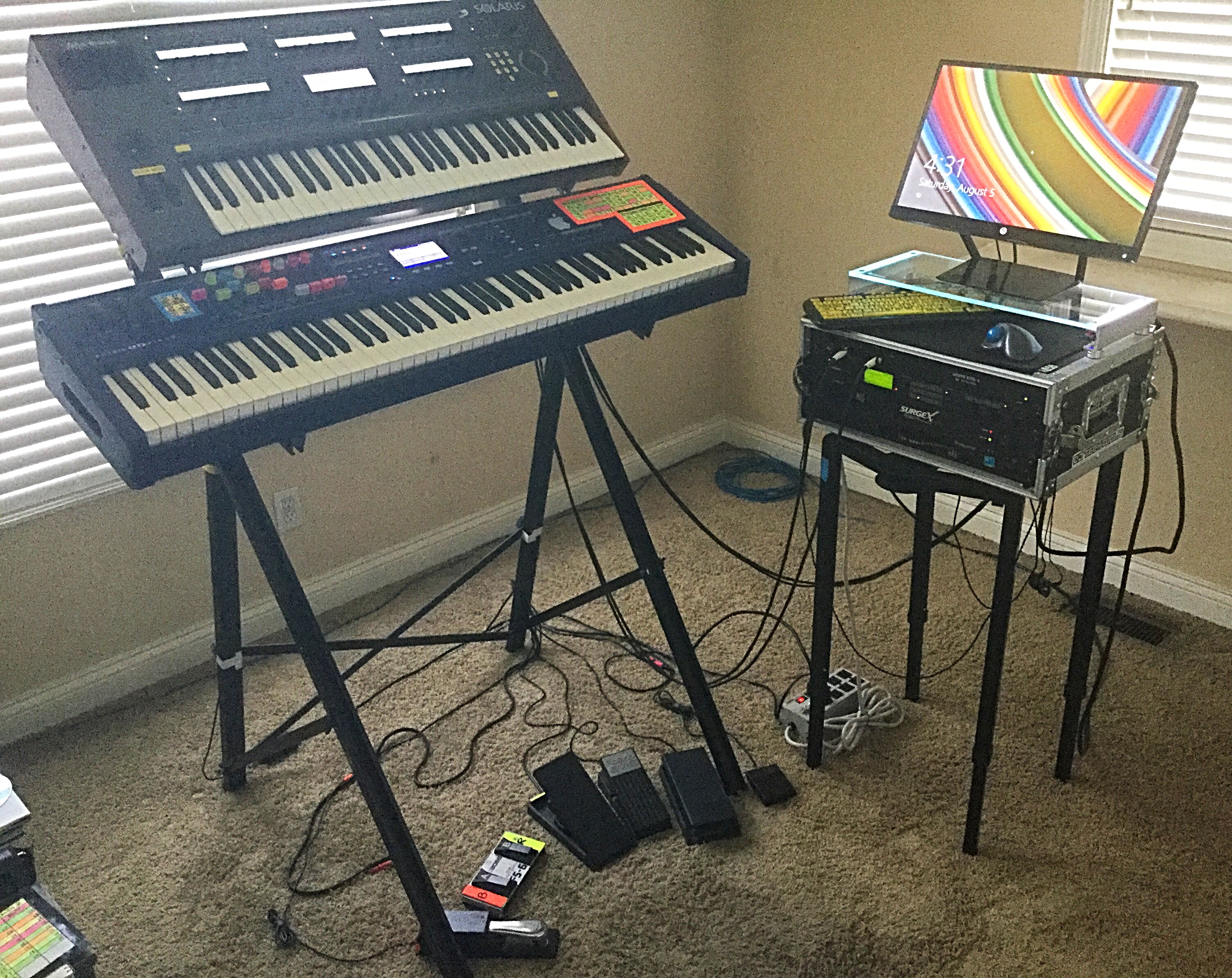

Finally.
A smaller, faster live rig.

Exactly why I wanted to try a proven design with the least features.
The motherboard itself has less space, less traces, less features and hardware.
It runs 7 degrees cooler just from that.
But the extra thick PCB means it will run longer and cooler.
This is the ultimate Sidemans rig.
I'm so bored with Tributes I want to play with as many people as possible.
If things aren't working out my escape is that much quicker.
