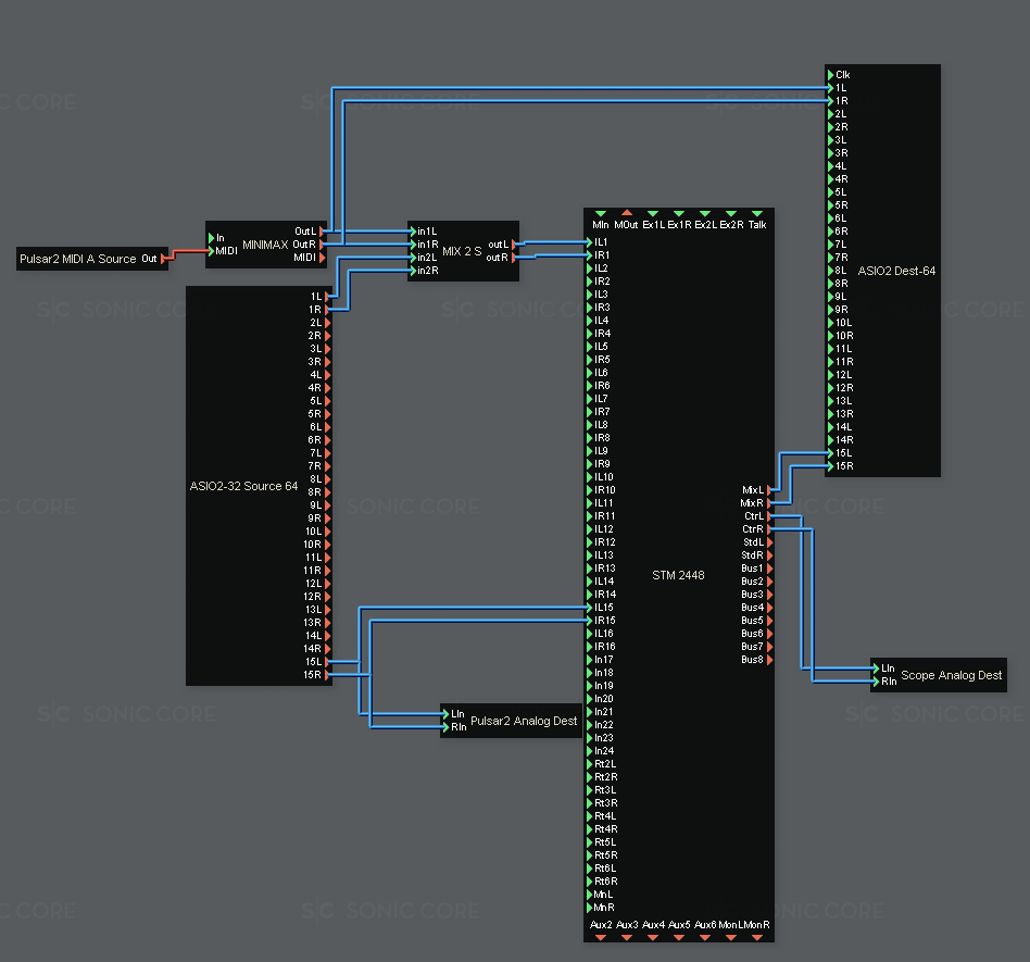

GaryB, the dynamix mixer works for that.. but I need about 7, 8 instances... so it is very DSP consuming + I need only 2 to 1 STEREO
Actually I want each STM mixer channel I use to have the 2STEREO to 1STEREO before the input, in order to be able to audition the sequenser through asio always in the same channel.. THIS way you can still mix in SCOPE .... I used to rerout to another channel of STM mixer, but I found that it was very confusing at the end, remembering all the STM mixer settings, copression, eq etc...
A SIMPLE EXAMPLE
Minimoog plays in STM2448 mixer channel 1.
- Compression on
- Eq on
-AUX 1 (Materverb) on
If I record this to a sequenser .... then sequenser sends throu ASIO.
The best way is to audition again from within channel 1.... So you continue tweaking the already tweaked paramaeters if needed.....
P.S. I connect the MINMAX to STM ch1. And also minimax DIRECTLY to ASIO dest channel1(NOT THROU DIRECT OUTS OF STM)
So...
STM channel 1... you PLAY MINIMOOG and also can audition MINIMOOG within the same channel
Thats why the 2STEREO MERGER IS NEEDED
1.L/R from Minimax 2.L/R from Asio Source(recorded minimax) to channel 1 of STM mixer
Re: Audio merger 2STEREO ins to 1 STEREO OUT?
too complicated for me. :)
ARCADIOS
Posts: 1361
Post by ARCADIOS »
actually, it is to make, because scope channels do not have 2 stereo inputs(1 for play a synth and another for asio source)
but after you work easier. it is just like creating a monitoring capability(connectivity to the daw) of a scope mixer.
much more convenient than auditioning recorded waveform of the synth from another STM channel..
when I play now minimoog for instance and change ..lets say..the STM Channel eq, or Compression attack.. I dont have to change it to the other STM channel that would be sent from the asio source(DAW)... now it is sent to the same channel.. and settings eq,com,aux, are there !! boom

this is a paradigm of 1 synth

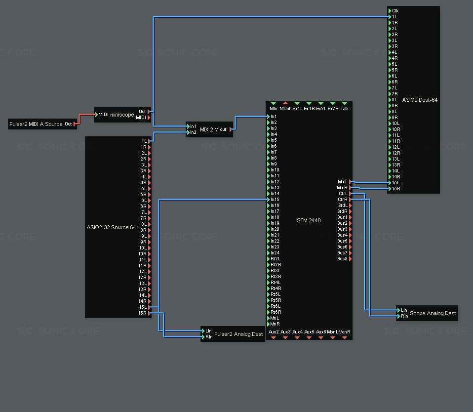

the same in MONO
for garry :)
