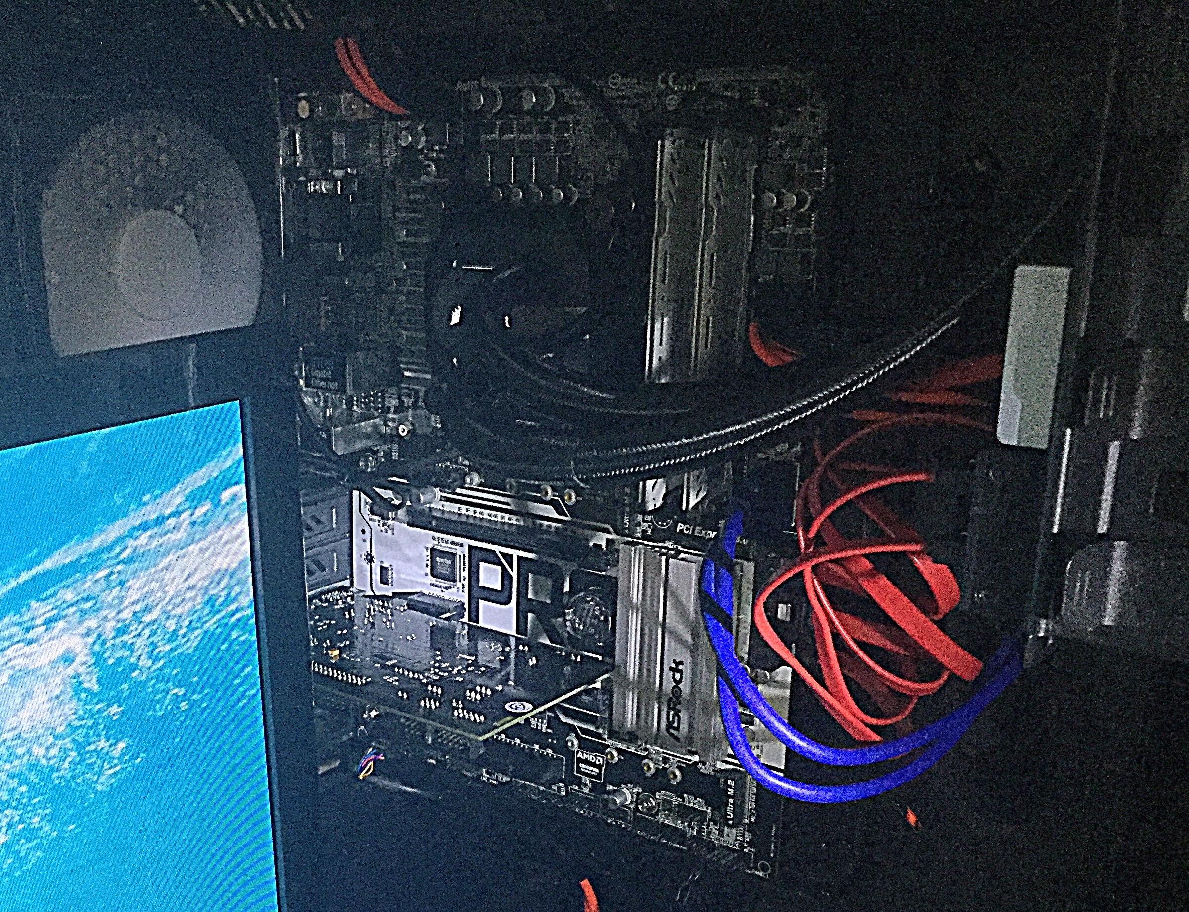

Will have a new PC with the above parts to test tonight.
Fingers crossed.

dawman wrote:Will have a new PC with the above parts to test tonight.
Fingers crossed.

Works perfectly with FL Studio 12 Signature, Reaper and Bidule.
ASIO 4 All even worked this time using FLS.
Don't need this, it's for my kid.
But chalk up another new build with Z270.
Next build will be AMD Ryzen but not until they design a workstation board with DIMMs perpendicular to faceplate.
I want a 1U.
Also overclocked the CPU to 5GHz using BLK.
Have a 240mm Corsair Hydro AIO.
56 C. 27 C on motherboard.
I guess Z170 was just not good for us.
I tried 3 x different OSs and 4 monos. No joy.
Windows 10 / ASRock Z270 Extreme 4 / i7 7700k.
Pretty bad ass rig.

dawman wrote:Works perfectly with FL Studio 12 Signature, Reaper and Bidule.
Pretty bad ass rig.
Yeah ... does it mean it´s perfect for XITE-1 now ?
Did ASIO- and WAVE drivers work the way they should,- and MIDI too ... all Win10 and Z270 ?

24bit Wav Source module for song learning worked and ASIO is fine.
Don't know why X99, B150 and Z170s wouldn't work but, don't care now.
Z270 is a feature rich chipset and the 7700k is superfast at stock 4.2GHz speeds.
That's all that mattered to me.
Thought NVMe might have ruined everything but obviously not.
Re: ASRock Z270/i7 7700k
ASRock Z270 Pro 4 also works. Z270 Extreme 4.
So 2 x different boards, 2 x different CPUs.
We're good to go with Z270s I think.
Thanks a lot !
Sounds great.
Last one:
You say SCOPE 24Bit WAV Source works flawlessly w/ Win10 64 Bit and SCOPE 5.1 64Bit ?
The new machine will be my 1st 64Bit system and I can live w/o using STS samplers in SCOPE and w/ XITE.
My 15DSP PCI w/ SCOPE 5.1 32Bit on a 2nd machine will run those well,- but WAV Source on a 64Bit system for me is essential too.

the drivers are not affected by the chipset.

24 bit wave source is all I tested.
It's important for me to play along when woodshedding YTube tunes.
Wish I could say why Z170/X99s didn't work, just glad the first 2 Z270 boards tested work.
Way more power than I can use live.
4 HZ has headroom 4.2/5GHz is just not needed for live gigs.
I really want that AMD Quad with 16mb Cache and 3.6ghz when it comes out.
Would love a thicker industrial grade PCB though.
The AMD Z270 Pro 4 also runs a 32bit PCI Hammerfall card.
Those using a Scope card for mixing and FX would love the power at 4.2/5GHz the 7700k offers.
