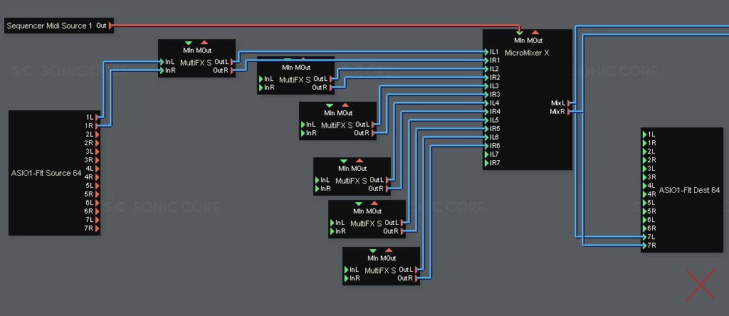

All I need is made simple project with 6 channels (stems from DAW) and pass it through Scope Multi-FXs and record mixed stems back to DAW (since I can't render it with VDAT http://forums.scopeusers.com/viewtopic.php?f=1&t=34844).
I create 7 ch. ASIO module, link 6 of it to MultiFX (empty ones) and send MIX L+R mixer channel (of ANY mixer, I've chose the light micromixer for the screenshot) to ASIO Dest for recording in DAW.

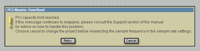

Now I open DAW (Cubase or Reaper) and it immediately leads to PCI limits.
I tried to connect ASIO to DSP2, 6, 10... I tried to reduce ASIO channels, as You see on the picture I even left 1! ASIO channel.
I tried made project from the empty Scope window. I tried open Scope first - DAW second, DAW first - Scope second, Open Scope with empty project, open DAW (it's ok) and load my stems project (leads to PCI limits instantly!)
It simply doesn't work! :o :o
I just can't add ASIO module to make my DAW works with it!
What's happening?! Could You please explain or suggest me something?

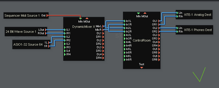

The ONLY configuration I managed to work with - I posted the screenshot last - when I open only 1 ch. ASIO Source and Wave Source (without Dest modules).
But! When I create the second ASIO Source channel - it leads to PCI limit (still without Dest modules!).
Moreover, If I use ASIO in my DAW with that last "stable" config with 1 ch. ASIO it could leads to PCI limits in ANY time, 5-20 mins later!

I work in 44.1 with XITE-1, there is all at the screenshots I have in project window (except Analog DEST module), every MultiFX is empty, there is NO plugins loaded in project.

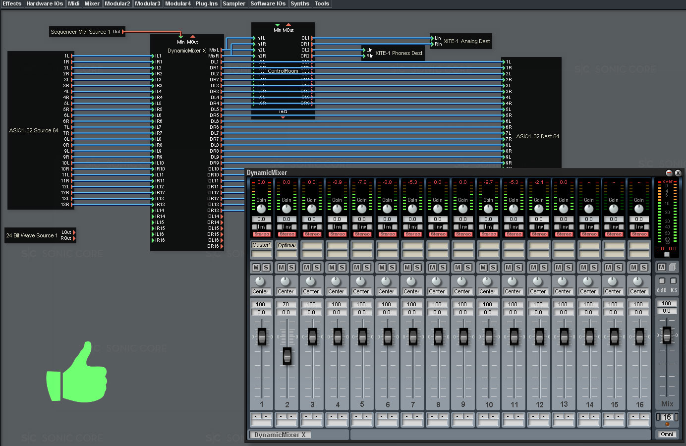

Guys! Tremendous's happened :o :o
I've updated the newest BIOS (version 03/06/2017) and... it's alive now!
13 stereo ASIO channels in da house! :lol:
On 14th it stuck with DSP limits but it offered to reoptimize and I think it could be managed, because I even started to add Masterverbs but it was too long optimizing to wait ))
As for my 6-8 channel stems project - everything now works fine with Mehdi's mixers, Summer-of-82 and so on =)
Thank You all for support and advices!
fraz, so much thanx for great alternative options, I could still take it if my scope ambitions will rise :lol:
Still don't believe it, everything works now, wow! :D
I think it could be helpful for other Z170 users ))
Details:
(Gigabyte GA-Z170-Gaming K3)
I've change BIOS
F2 4.5 Mb 10/03/2016
to
F22 5.4 Mb 16/03/2017
Started BIOS with default settings, just turned the VT-D off!
p.s. It is quite fresh BIOS released just two weeks ago, someones put them request with the same issue and Gigabyte fixed it? :roll:

Three days - works normal so far ))
fraz wrote:Do you think you could get more channels? - Not that you need them maybe - That may mean newer sockets like AMD AM4 may work
Fraz, I've managed 14 more or less stable ASIO channels, after several DSP auto-optimization processes.
But with 14 ch. I couldn't add any of plugins in mixer (DynamicMixer X), it goes to endless optimization or just shut the audio down (no ASIO in DAW).
With 6 ASIO there was no rough DSP failure so far with quite heavy mastering plugins...
