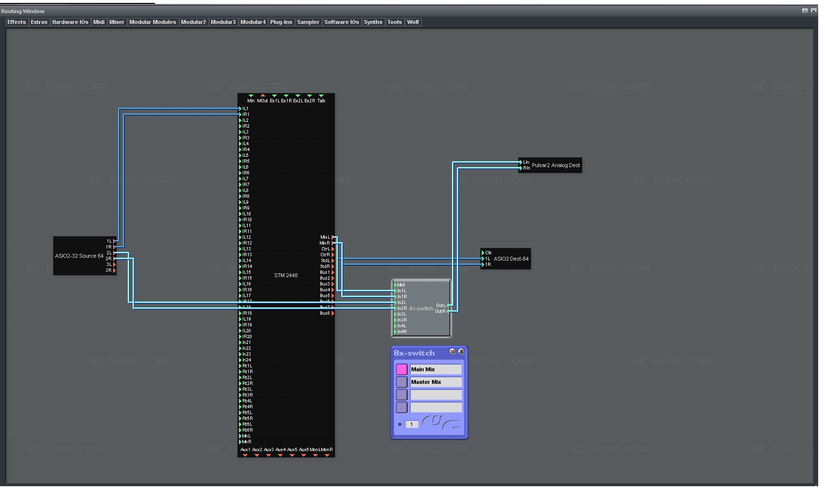

and my second question is, how can i do that ? maybe project picture.

ASIO channel 1 is your main mix. This can be multiple ASIO channels if you want to mix within Scope. ASIO 2 is just a spare set of Stereo input and output channels you need for the separate master mix.
Asio 2 input from the mixer output will receive your whole mix and send it back into Cubase. On the same channel of your DAW set your Asio output to asio2(or whichever you have available) and this is sent to Wolf's switch (free) which bypasses the Scope mixer. You can re-route it to Scope mastering devices if you wish. I've just loaded the basic route.
You can use Wolf's switch to monitor either the mix or mastered version. You can also do that in Cubase another way by soloing or muting the mastered version.
Hope that helps.
Hope that helps.
- Master Re-Route.jpg (183.1 KiB) Viewed 2361 times
