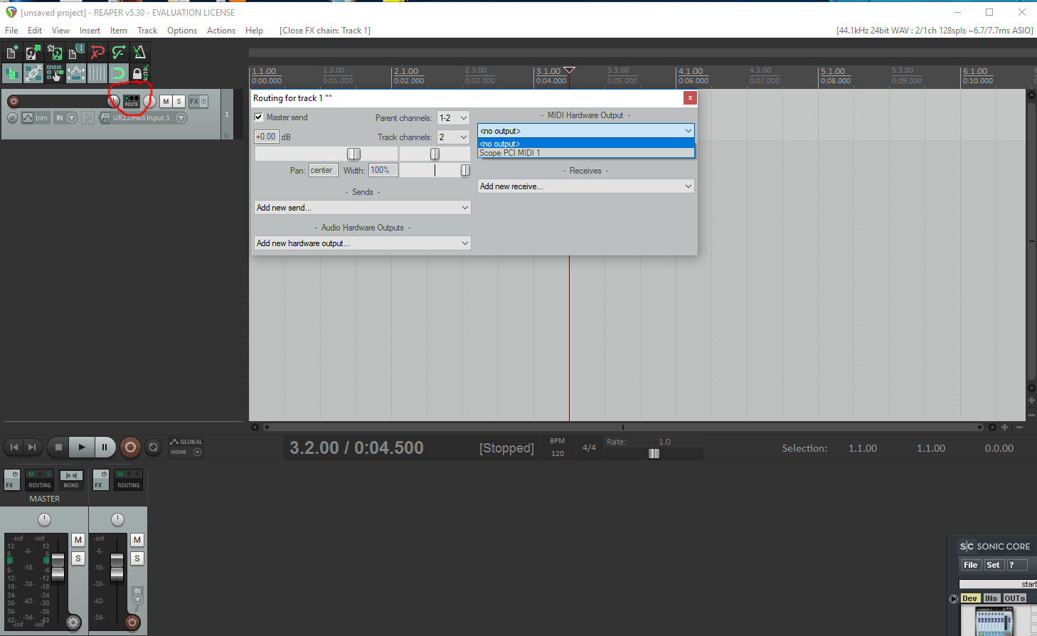

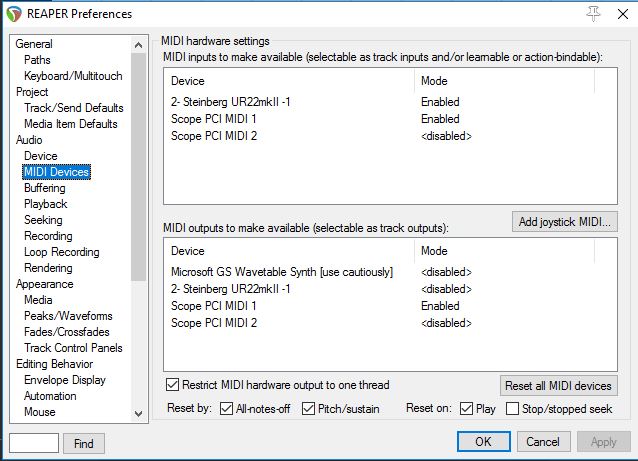

Thanks guys! I had no idea that ULLI is the ASIO panel.. In Scope 4 I remeber a window opening for ASIO with a few options. Do you know how I can use an external midi keyboard connected to the computer through a Creative Soundblaster to control the Sonic Core synths through Reaper?
pastor
Re: Scope 4.5 on Windows 7
In Reaper, Options, choose preferences (Or press ctrl+p). Make sure your midi inputs and outputs are enabled.
Add a track, press routing, select your scope midi output.

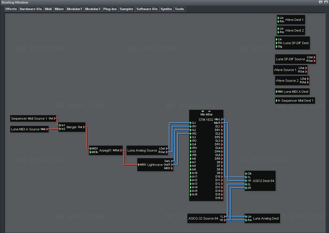

Hello!
In reaper, I followed the steps to integrate it with Scope, but in reaper I can listen to he recorded track, but after rendering, that track is missing from the song. Any thoughts? This picture shows how I experimented in Scope. Thanks you!
