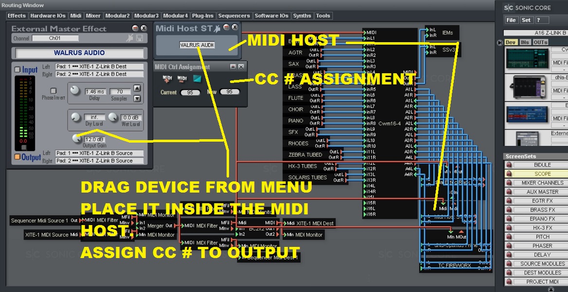

It only took 10 years of using Scope but here is the way to bring the Phaser of Death in and out of Scope.
Load up the module below.
Drag a Master Effects Module from the Tools Folder into it's inset slot.
Connect wherever you want, but I use an AUX from a mixer so every channel has the Phaser of Death.

Then when I want the effect a fader attached to the Master Effects Output knob goes from clean to full tilt.
Any Channel with AUX 2 turned up gets juiced...
This is old school but so many EDM mixes I like that use Phasers could get a great jolt from this.
I also route it through the Radial Space Heater with 80% drive so it's a fat son of a bitch.
The trick and Tip is using the Master Effects Module volume knob inside of a MIDI Host.
MASTER FX MIDI HOST.jpg (263.8 KiB) Viewed 19244 times
