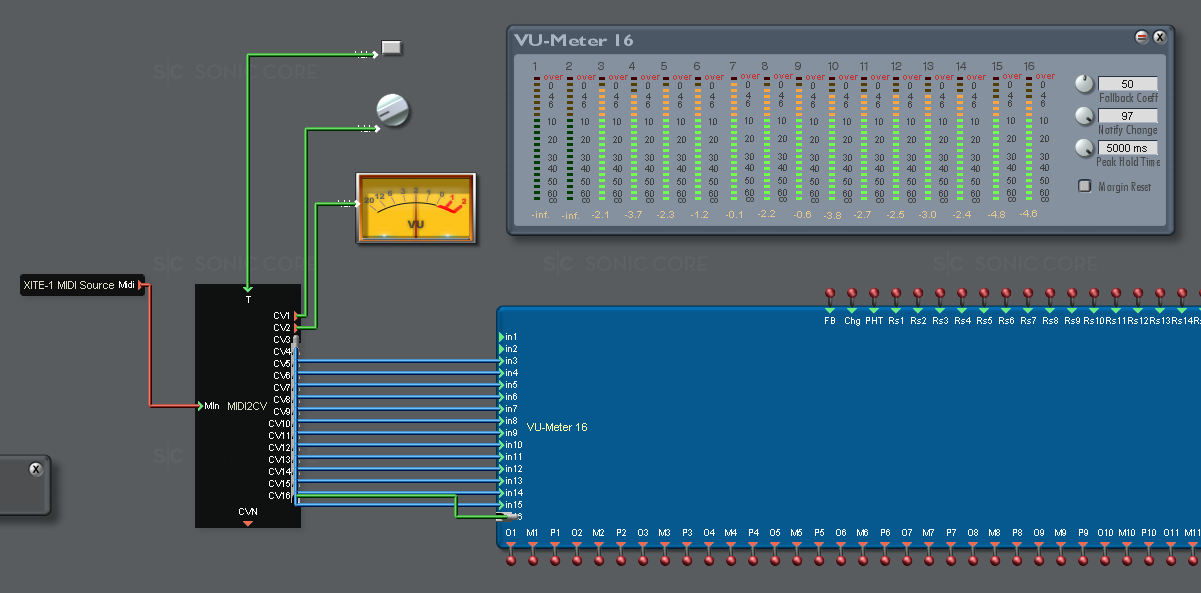

So, here is the 1st device: MIDI to CV, 16 CC values can be handled with teaching button: Press the button, apply up to 16 different CCs and press button again. The state will be saved, so next time, you don't need to teach again. The ini file will be automatiically generated in the app directory. The dll goes the usual dll dir (for ex. C:\Program Files\SCOPE SDK XITE\App\Dll). You need the VS 2013 runtime dir too (https://www.microsoft.com/en-us/downloa ... x?id=40784.Pygmy Audio Farms wrote:Hi, a bit late to reply but for midi, an easy way to handle MPE
looking forward to the new devices
Example pro (incl):
- midi2cv.zip
- (742.97 KiB) Downloaded 772 times
Re: MIDI modules
At the moment, only one instance is useful. If someone needs more than one, just reply and ask for it. I might have an idea, to make each module unique.

If you got a MIDI keyboard controller, it might have some CC controller as well (buttons, sliders, pots etc). If any of these can produce CCs (Continuous Controls), you can use these outputs to control any potentiometer in Scope. It can be volume, frequency, time - whatever comes to mind. AS exmaple, you can control the frequency of a LP Filter like a Wah-Wah from your keyboard. If you keyboard controller allows a foot pedal: her you have your wah control connect the Midi2CV out to the LP Filter F control, push the T button, move the pedal, push T again and you're done.YiannisK wrote:Looks great!

Is there any filtering or interpolation to smooth 7bit MIDI to 32bit CV?
Re: MIDI modules
I can do that. But you'll always have a step, because there is no in-between state. Value is either 54 or 55, but never 54.6. On the other side, if you have an idea, I'm open to suggestions. Another way would be using 14-bit (N)RPN input. I can do that too.jksuperstar wrote:Wow, DragonSF, great device!

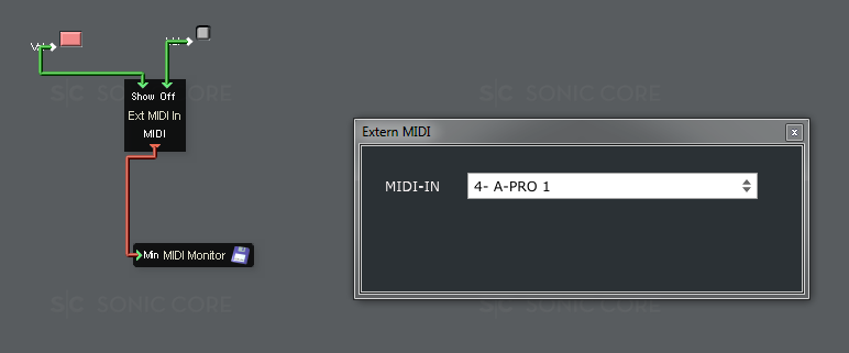

A new module: external MIDI IN. If uou encounter note-hanging, push the off-button. To selct the Midi In device, push show and select the device from the combobox. Enjoy!
If you encounter hanging notes, please tell me. There is a speed limit within Scope, which gives problems at BPM > 160. I might need to increase the buffer.- Attachments
