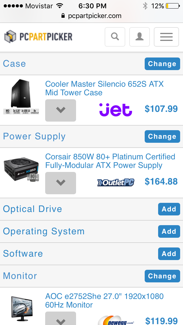

So, I want to make a new build with Windows 10 64bit and I am looking for options.
I am between a Z170 and Z97 build.
Z170 pros:
-3 PCI ports mobos can be found.
-Compatible with PCI cards.
Z170 cons:
-Not friendly with Xite-1.
Z97 pros:
-compatible with Xite-1 and PCI cards.
Z97 cons:
-Only 2 PCI ports.
My question is: will Xite-1 become friendlier with Z170 in the future? I ask because anyway I probably won't be able to get a Xite-1 any time soon, and I would probably start with Scope PCI cards, then upgrade to Xite-1 in the future , when I am able to get one.
If I go for the Z170 , I am considering an i7 6700k CPU.
If i go for the Z97, I am considering an i7 4900k CPU.
I want CPU power for DAW plugins and Audio Apps.
I am looking for 16 GB Ram.
Noise free build: silent case and PSU.
Dual Monitor setup: with in-built graphics. I am not sure if using in-built graphics will suck too much CPU; if this is the case, then I might consider getting a cheap GPU.
Ii have Motu Firewire Ultralite card, so a PCI express port is needed to attach a Firewire card.
I don't know aboutn brands either; feel free to advice on this.
In the images you can see a build I have in mind: let me know if anything is overkill, or below the stadards, or incompatible.
Thank you

Z170s were tried 3 times and wouldn't keep the ASIO Driver reporting.
But that was using Bidule and Reaper.
Can pretty much guarantee the Z97s work.
I have 3 builds I use depending on the job.
Outdoor rig, indoor rig and travel rig.
All ASRock Z97 Extreme 6
Supermicro Asus and MSI all work.

no, but there ARE plenty of Z97 motherboards that have been made with PCI slots.
Z170 was useless for XITE, but it does seem to work with PCI cards. the thing is, there's really no advantage with the Z170 over the Z97 offerings. that's true regardless of what the uber-geeks might want to say about potential performance.

GaryB is correctamundo.
I haven't seen ANY real world performance gains on CPUs/Chipsets since the i7 3770k and I have tried 4000 series and 6000 series.
It's my opinion that there are ASIO Limitations,...period.
I have tried SSDs and noticed great improvement, but the NVMe devices are 3 times as fast and no real difference there either.
Our real world gains were from Conroe Dual Core and SATA III to SSD.
Everything since then just doesn't show gains.
I did see gains on Zebra2 HZ by going from 3ghz to 4ghz since the synth is locked to a single core.
i7 3770k @ 4ghz and Z97s are as good as it gets from my experience.
