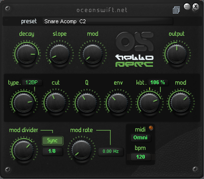

:D :) :o 8) :lol: Percussion synthesizer based on filtered noise :D :) :o 8) :lol:
Check out the Hello Perc demonstration video here:
https://www.youtube.com/watch?v=QJbelqtXjwY
Controls
Midi Channel: The midi channel the device will respond to.
BPM: Sets the BPM for the synth. This is the tempo from which the divider will divide.
Decay: The Decay of the envelope. Controls the amp directly, and the filter as a modulator through the Env knob.
Slope: The slope of the Decay knob.
Decay Mod: Adds a random element to the Decay value. Only positive modulation is possible, meaning the Decay can become longer but can not become shorter. This knob controls the range of the modulation.
Type: Filter type choice between six options. Lowpass, bandpass and highpass in 24db or 12db configurations.
Cut: The cutoff point of the filter
Q: The resonance quality of the filter
Env: Depth of modulation applied by the envelope to the filter.
KBT: Midi note tracking of the filter cutoff. On Center position no tracking occurs.
Mod: Depth of modulation applied to the filter cutoff by the randomizer LFO.
Divider: BPM based division that controls the rate of modulation of the randomizer LFO when sync mode is turned on.
Rate: The rate of modulation of the randomizer LFO when sync mode is turned off.
Sync: Turns on or off the sync mode of the randomizer LFO.
