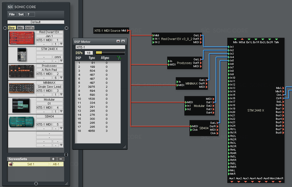

Now, in terms of practical use: how many synths can I get running at the same time with a 15 DSP PCI card; I know it depends on many aspects; let's say I want to use:
1- An 6 Voice Pad running on a Prodyssey.
2- Mono Lead on Red Dwarf.
3- Mono Lead on Minimax.
4- Drone patch in Modular IV.
5- A Bassline in another synth.
Approx, how much PCI DSP these scenario would require?

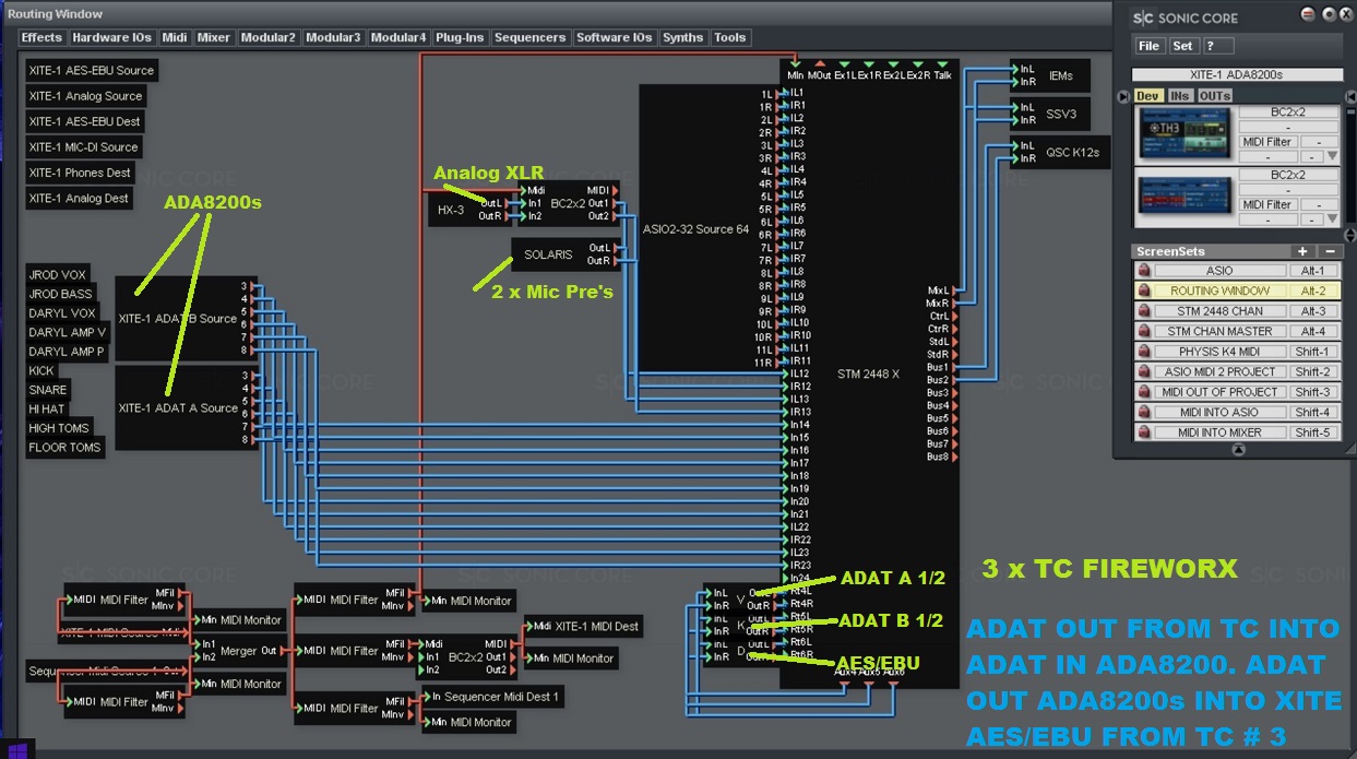

I am running an entire live band with the XITE-1.
Just 2 Black Lion Audio ADA8200s modified and 3 x hardware FX.
Plus all of my ASIO Samples, hardware analog synths, Solaris and select Native synths like Zebra2 HZ, Piano Teq and Keyscape.
Great sound.
sunmachine
Posts: 580
Re: New to Scope
Post by sunmachine »

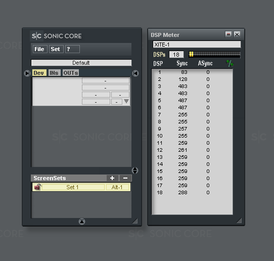

I loaded those instruments into an empty project so you can see how much DSP would be used.
First screenshot is the empty project.

dawman wrote:I am running an entire live band with the XITE-1.
Great sound.
Everyone says great sound; guess I'll have to check that by myself :)

sunmachine wrote:
Paprika wrote:Thank you for your clear explanation garyb; i got how it works.
Thank you,
Thank you for your help sunmachine.
Great sound.
3 x TC Fireworx
2 x ADA8200 Black Lion Audio Mods
RP562 Bellari Tube Sonic Exciter for Mains (VoodooLabs Mod using Analog Devices OpAmps + 2 x RCA 5751 Command Tubes)
XITE-1
QSC KW Series PA 2 x KW181 18" Subs, 2 x KW153's and 2 x QSC K12 Wedges
Stereo FOH, Stereo Monitors.
This Dog Will Hunt
