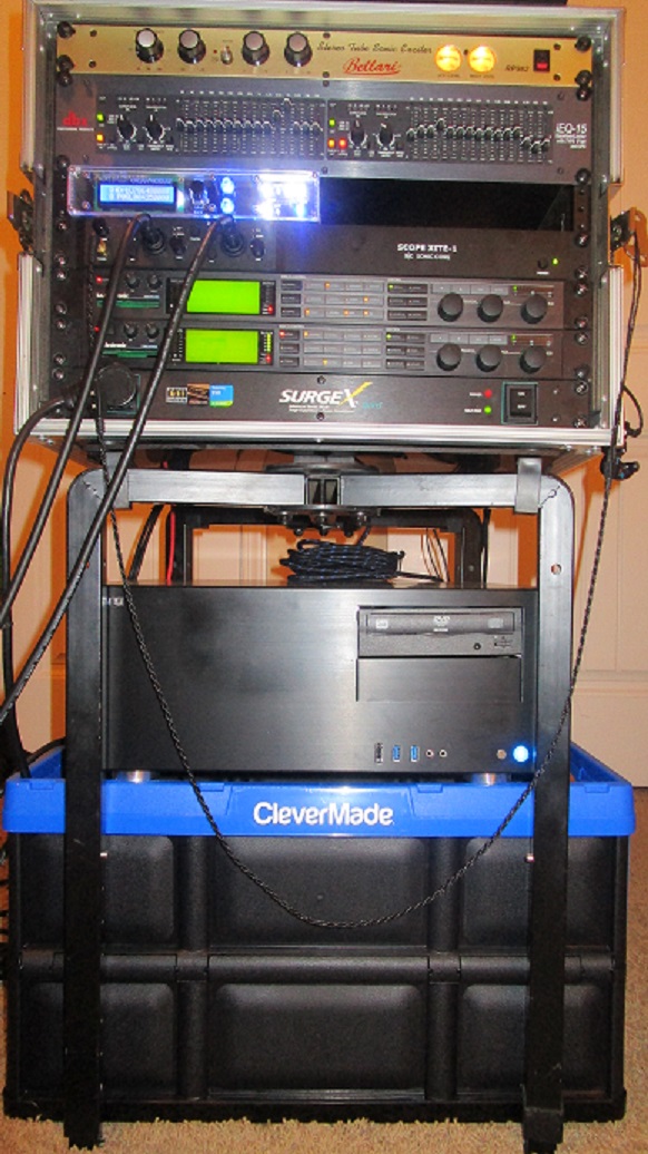

Re: Bets New MB for Xite-1
GaryB made this for me and we tried several new things like MSI, Asus, ASRock.
ASRock Z97 always works, it just seems to be the choice for the last few builds.
GaryB's DAWg's will hunt.
