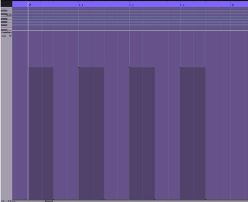

5.ScopeSync can be used for cc to scope via sample accurate audio trickery, the use is a much smoother higher resolution than midi.

If you are going to use a lot of midi in your projects have ulli settings set to 13ms laytency (that's if it was at 44.1hz). lower than that, midi jitter will be introduced once a lot of midi notes and cc gets used. The USAMO box eliminates midi jitter (1 port)

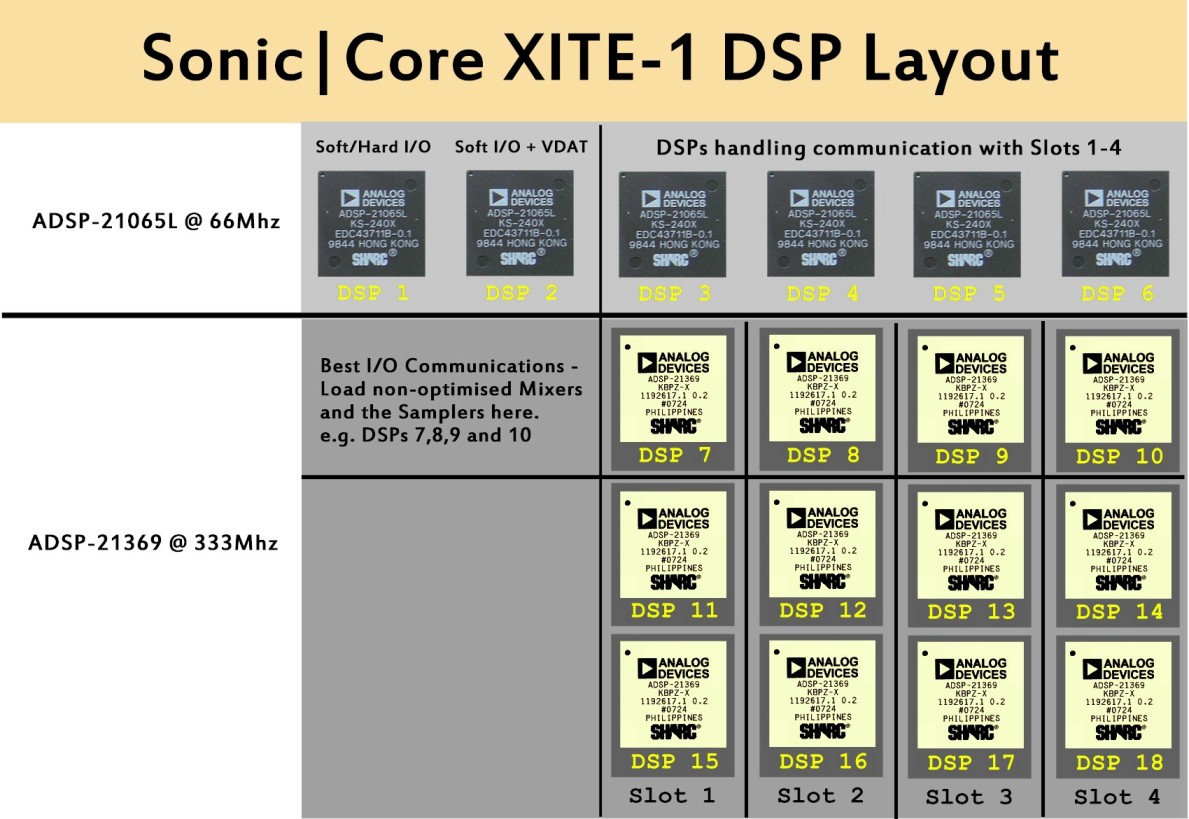

9.DSP Usage...
In general, DSPs 7-10 have the most inter-DSP connections, and provide the best place for mixer's to live (STM2448x go here) with the other DSPs intended for synths/FX on channels as such:
7 : 11, 15
8 : 12, 16
9 : 13, 17
10: 14, 18
Dsp assignments are not always loaded in the same order, unless you use the manual dsp assignment dialogue on each module/device before you save the project.

9.DSP Usage...
7 : 11, 15
8 : 12, 16
9 : 13, 17
10: 14, 18

- xiteadsp.jpg (192.77 KiB) Viewed 97710 times

As I didn't saw this on your tips post, you could add to always assign asio I/O to DSP 2, this is really helpful to avoid limit reach issues.
And also, instead of loading fx inserts in channels inserts mixer, loading all those inserts in a multifx module on the project window, outside of the mixer, this way of doing is amazingly better for limit reach issues too. My project template has one multifx module in front of each mixer channels, since I do like that, I can load as many devices as possible to reach dsp meter very close to its maximum.
