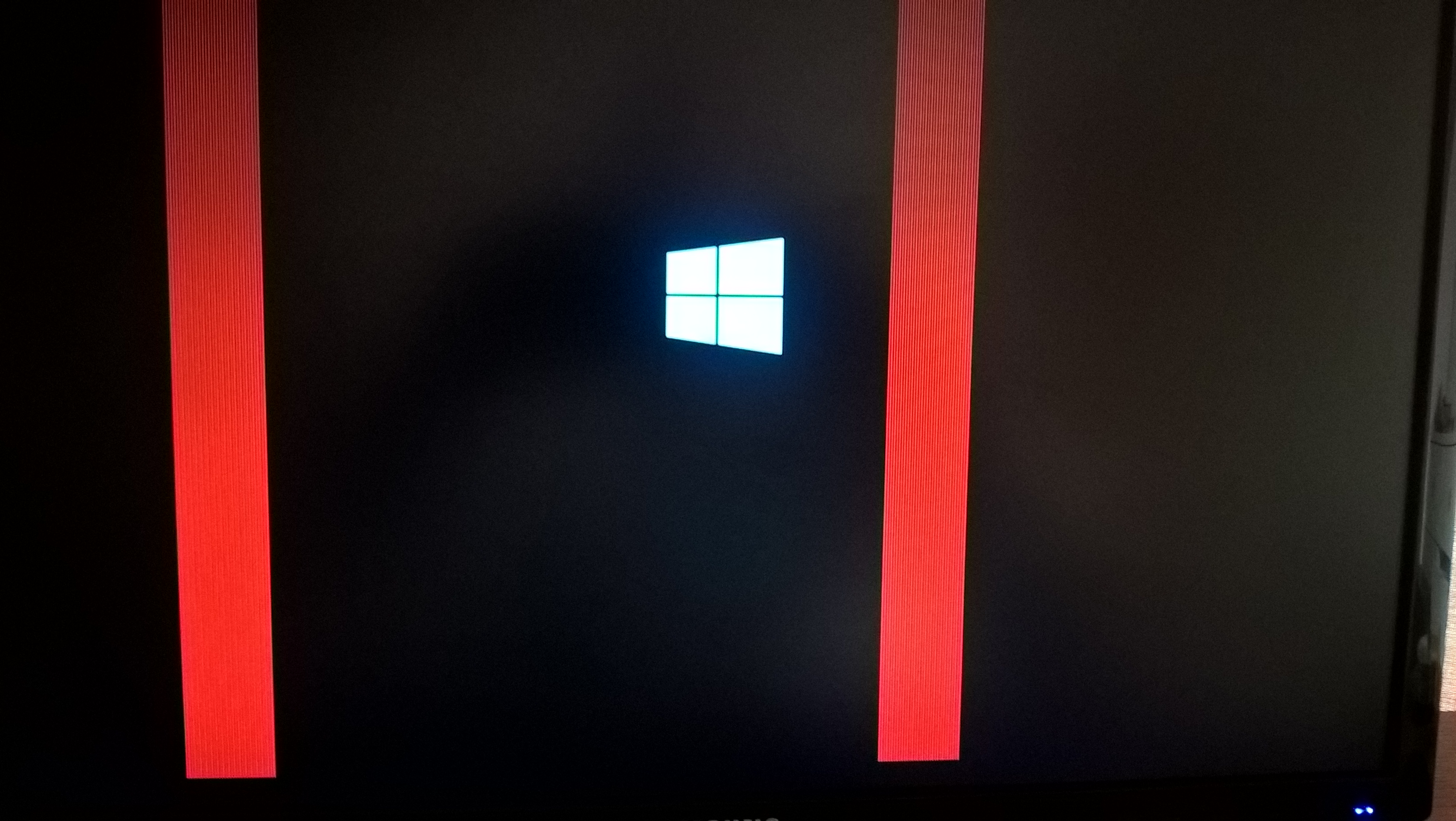

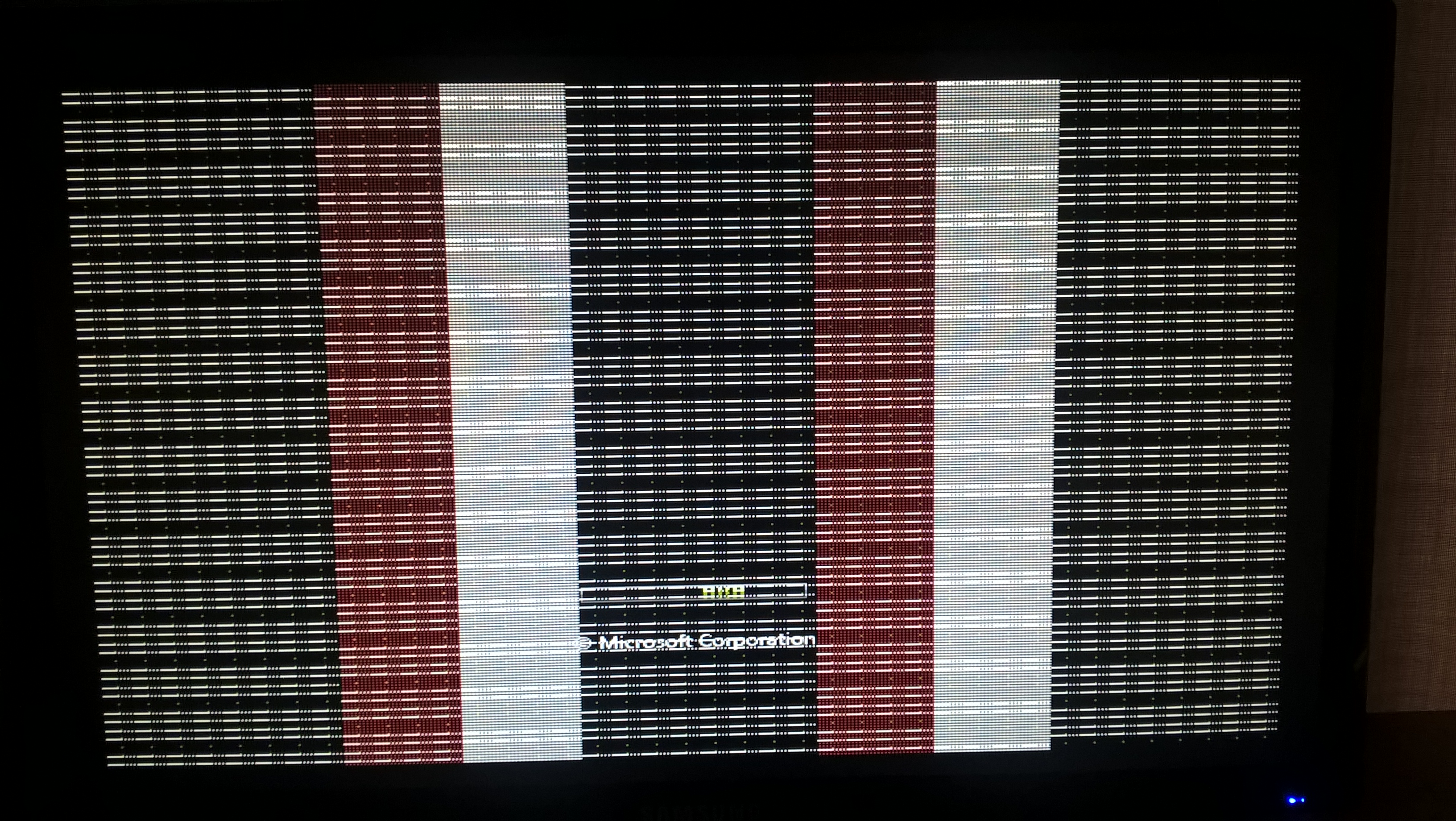

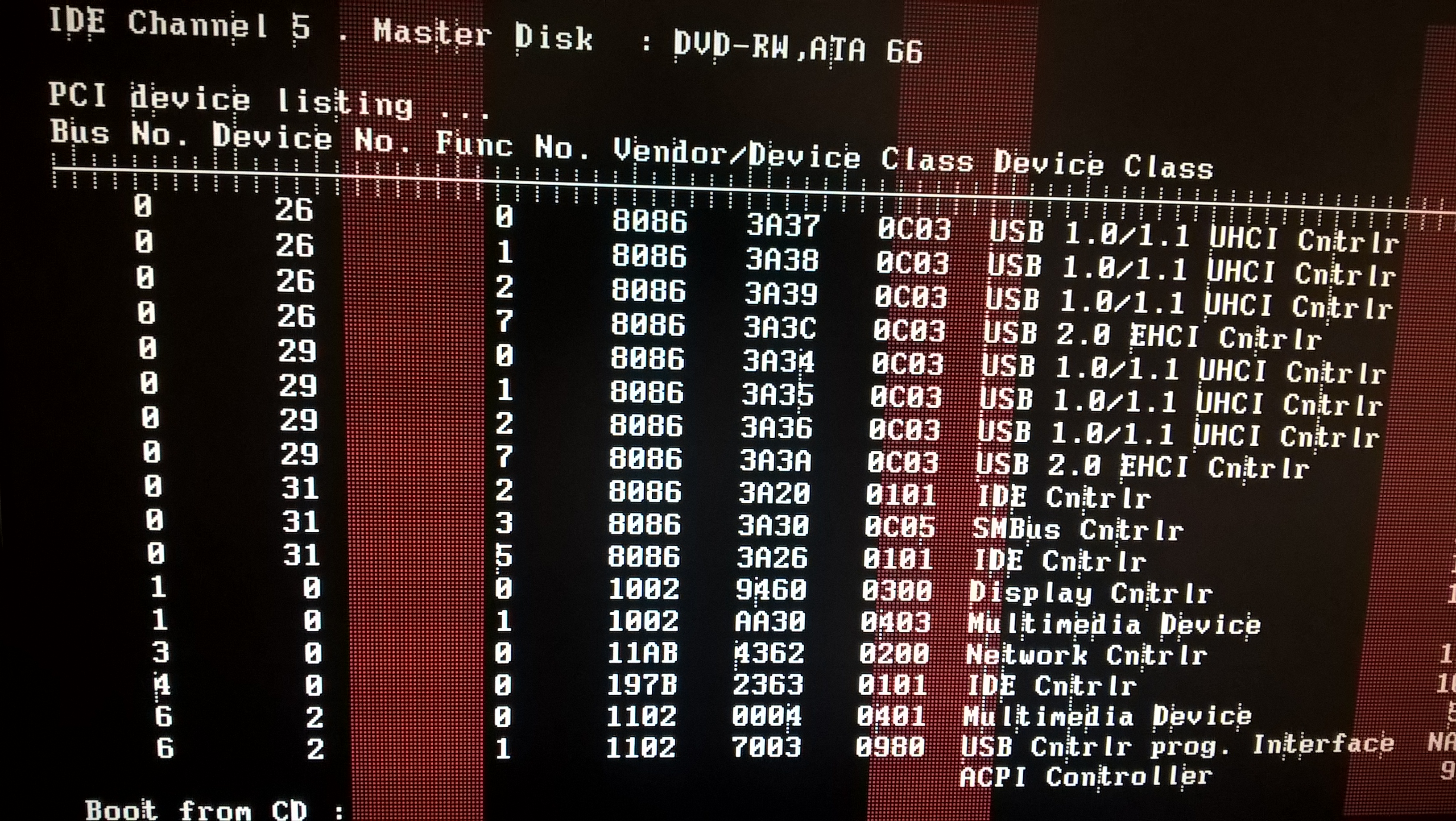

So, i installed card into chassis and power on. At the beginning it was fine, then after some time, some lines appears and won't go away.
Screen is not blinking or anything similar, or black out, just those lines are always there.
Like you can see on pictures.

What type of gpu is it? It looks like its broken. 650W should be ok for most cards. I had a card looking like that after failed overclocking.

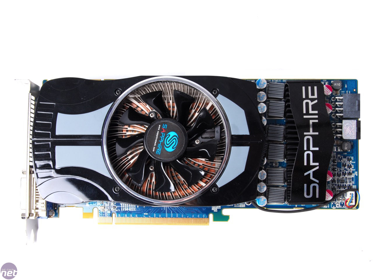

It's an AMD Sapphire HD4890 1gb DDR5.
I have also tried few minutes ago in another computer of mine, which has even better power supply and those lines appears right away.
Sometimes it's maybe few minutes fine, but then lines appears back again.

that card uses approx 180w idle and 280w under load, so depending on what CPU etc you have it might come close to the limit, but i rather think the GPU is the iussue. Either the cooler isnt properly fitted, or it is damaged in another way. i would return it.
Re: GPU card issue
Bad ram on the GPU, the card is bad.

Sorry, but Valis is right, your card is unfortunately bad, get it back as soon as posible, it's your best move.

probably a dead topic (and dead card) but that definitely looks like bad RAM on the card.
