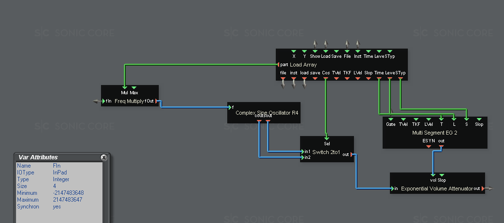

faxinadu wrote:can you explain that? what do you mean use it with a 2:1 switch?
For resynthesis you need either sin or cos signal. The atom has 2 outs (sin and cos), so you need a 2:1 (sin or cos-> next stage). This can be switched dynamically (async).Ecample:
PArt OSC.png (28.11 KiB) Viewed 20913 times
faxinadu
Posts: 1646
Location: israel
Re: Sine OSC with phase shift option or cos osc
Post by faxinadu »
very nice!!!!
